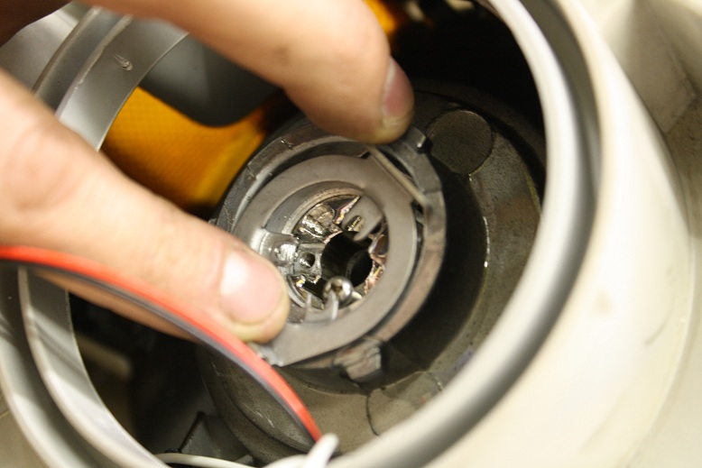

how do i put the h1 bulb into the projector and how do i hook these damn things up lol?
Yeah what the hell! the original screws that came with it and held the 3 screw mounting piece no longer work! theyre too short! How do I finish this project!??? lol
Old Feb 19, 2011 | 08:04 PM
  #245
mkulrey13's Avatar
iTrader: (39)
Joined: 08-30-05
Posts: 18,509
From: New Hampshire
The directions tell you to either bend the prongs to get the screws to fit or dremal some of the plastic to get the bracket to sit all the way.

SSnAZ's Avatar
Joined: 07-18-08
Posts: 199
From: Minneapolis
i thought thats what I was doing wrong....
Because were looking at it saying... **** even if we dremel it flush with that threaded washer they still are not long enough!

This
Old Feb 19, 2011 | 08:16 PM
  #248
mkulrey13's Avatar
iTrader: (39)
Joined: 08-30-05
Posts: 18,509
From: New Hampshire
Yes, dremal the plastic at the top and bottom so it fits in there or bend the prongs down so the screws fit. Only need 2 screws halfway in and that peice isnt moving.
