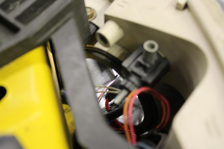

Is it normal to have this much light coming from the back??

PM me the code on the base of the bulb should be like H1 10x Ill make sure you got the correct bulbs you ordered. Also, if you did not dremal the back of the headlight, the bulb is probably sitting to far back in the projector.
Cant you also go off of the stick color too? 5k are brown 6k are white 7k are blue....

5k is pure white. 6k is a bluish white but more white. 7k they don't make. 8-10k are blue and get more blue with the higher the number. 12k starts turning purple......
that pics looks like your missing the lil rubber boot that covers the backside of the projector......

Guys ive already explained this.. If you did not dremal the back of the reflector to have the bulb bracket sit flush with the projector. Then your bulb is not inserted all the way which is why the lack of light. Takes 30 secs and you can do with with a file if you wanted to. You will notice where the bulb bracket kits. Its the top and bottom of it. Sides clear fine. This is also the reason why the screws dont seem to fit or are not long enough,
Yup, I did that, ground it past the threaded washer and bought 3mmx12mm mini screws to hold it in place.
It does still have the black grommet, but theres no where to mount that...

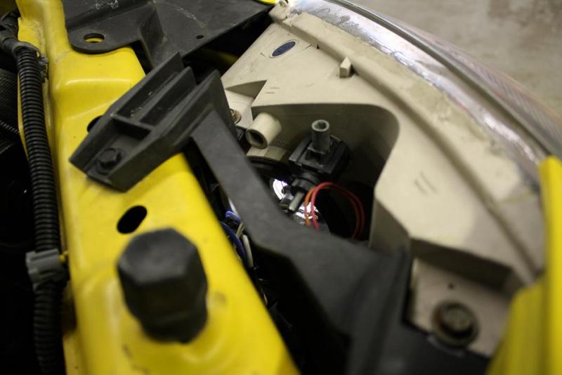

Heres a better pic
If you dremeled that tiny area, you can use the orginal screws.

It was close but I got so frusterated with bending the tabs I just went and got new screws..
But its flat against the washer, I have no clue why they are not very bright
SO did you not sand down the back?
I did. Dremeled top and bottom. Then bent the tabs to be flat so it can sit flat against the threaded washer.
