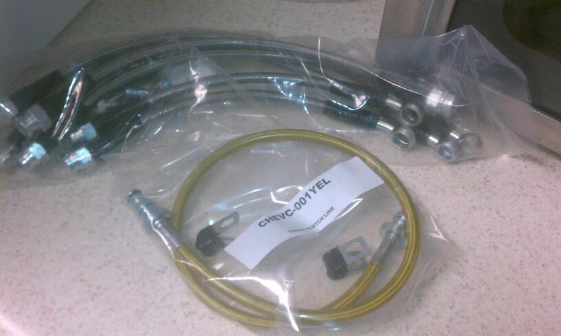

love my clutch n brake line kit, fast shipping and seems like gud quality (deployed so wife sent pix) def will buy from again.
NICE !!! Look at that quality !!! THMotorsports FOR THE WIN !!
