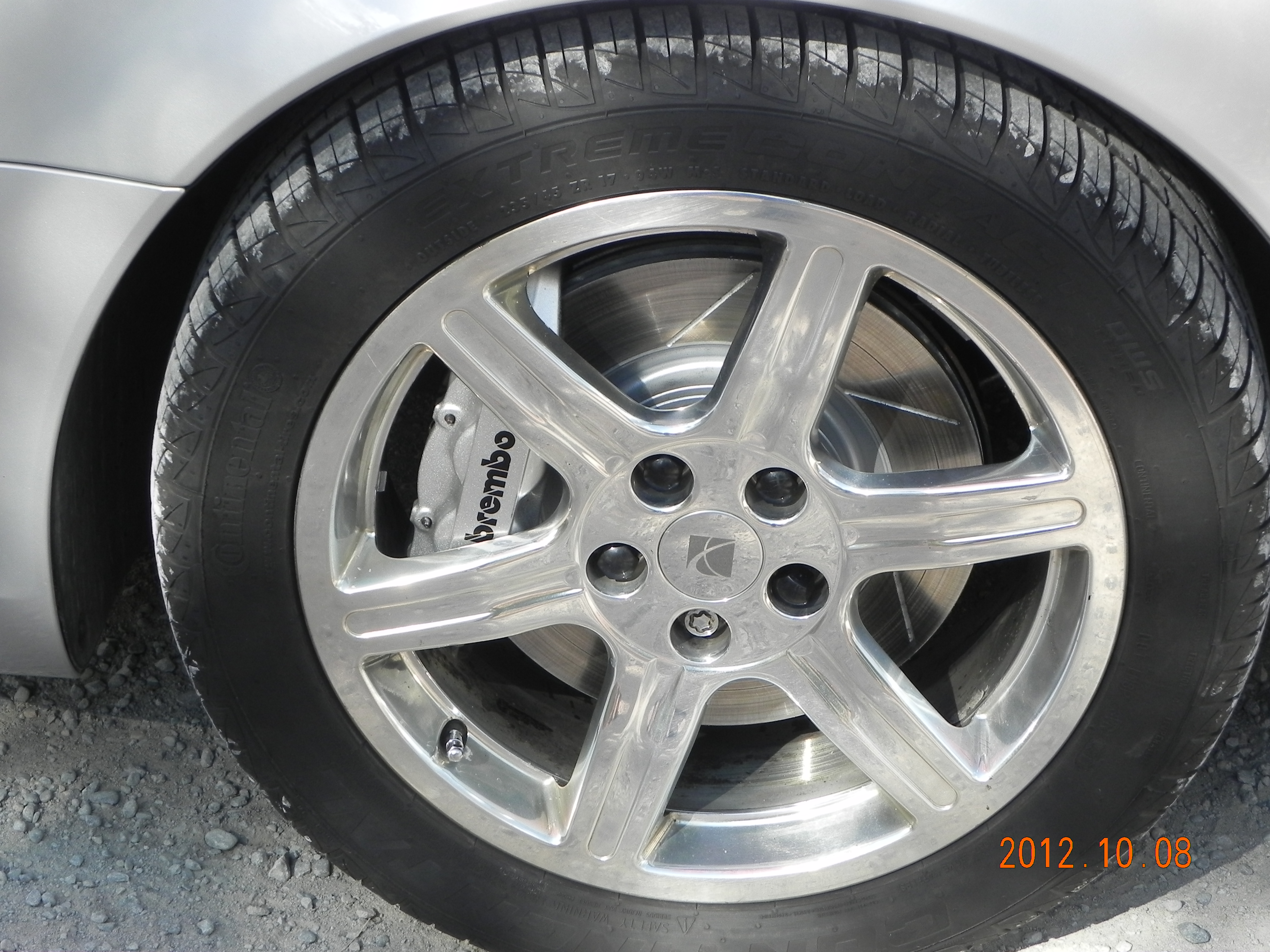

From: Port Perry
LSJ does not use the Ferodo HP 1000 compound in the brake pad as OEM. The rotors on an LSJ are smaller in diameter but 2 mm thicker than the LNF which are larger in diameter.
slotted Brembo's work well. The material in the Brembo rotor is very good.
