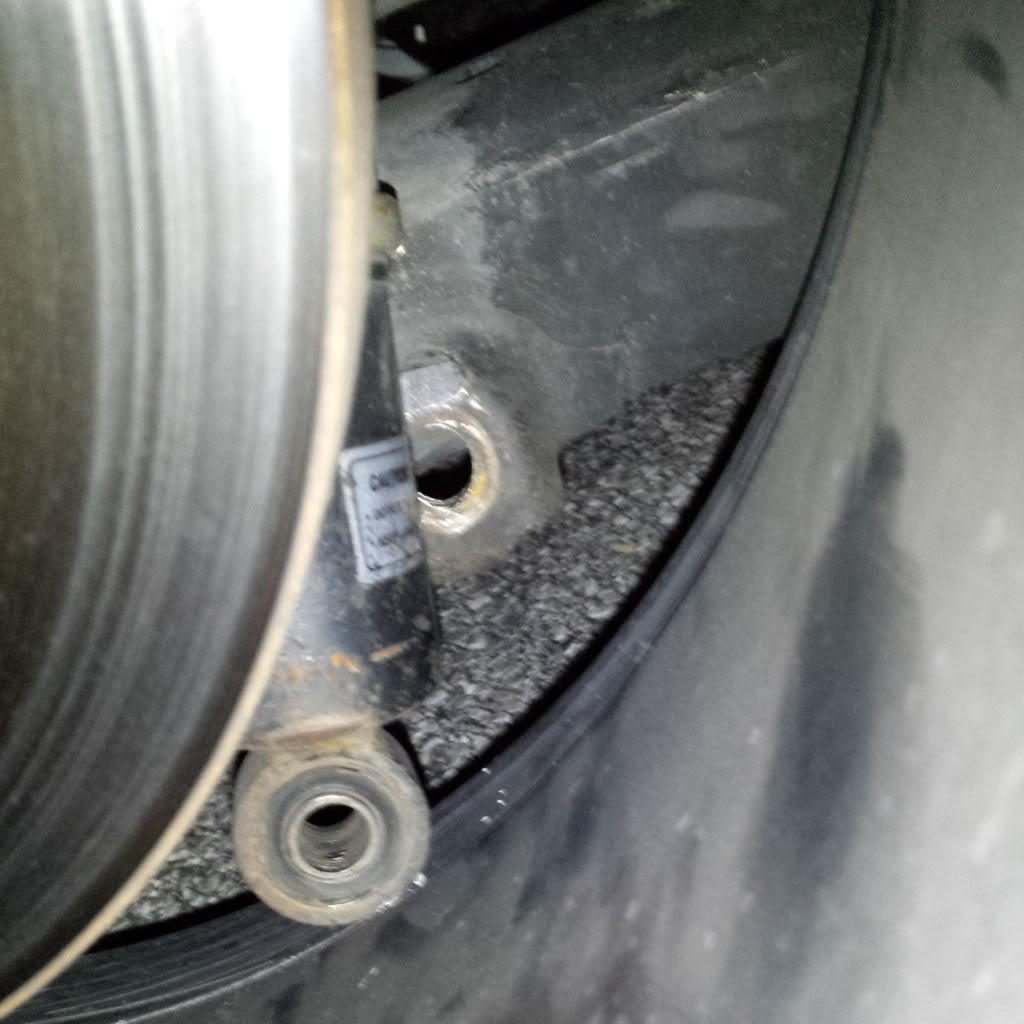

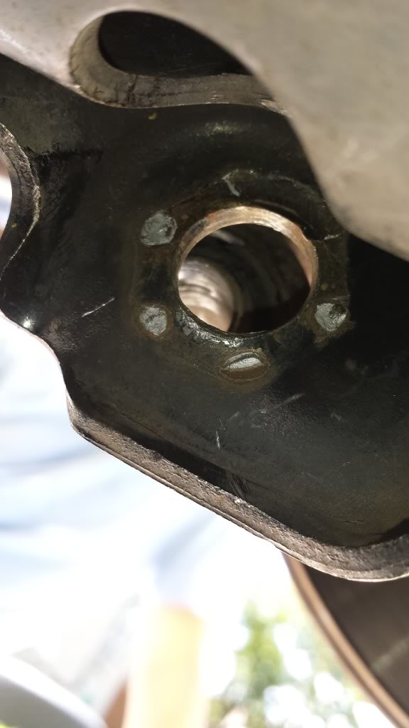

Does anyone know the part numbers for the bolt that goes through the lower part of the shock and the but on the back side of it? Last night I was driving along and hit 2 dips in the road and the nut broke off and caused the bolt to vibrate out. Thanks for your help!

Thanks man I'm figuring it might be something universal but I'm not sure what to do since the old nut was welding on. Lol

I have the one on the other side but the nut on the back side is welded to the frame.

I'd just get a matched nut/bolt and put it through the hole, with the welded nut gone it really doesn't matter what you use. Just get good hard fasteners, grade 10.9 metric or grade 8 if standard.

Advanced and pep boys didn't have anything. Went to home depot and got a 1/2" x 3" hex bolt with lock washers. The original bolt is 9/16" x 3". Going to use these as a temp fix until tomorrow when I can go to the dealer

You can buy that bolt!
I had the same thing happen to me lol... I was driving over some bumps and noticed that over the bumps it was really "hard/stiff" in the rear. Took off my wheel and noticed that bolt was missing and that my shock was free.
I was like wtf haha...
Anyways I think the part number for it is 11609850. I would put some removable grade Loctite on it when you put the bolt in next time. If I remember correctly when I went to the dealership to get the bolt they didn't have it in stock and the dealership had to order it. The lady said it was the first time that anyone ever asked to order that part number :p

Right now I just put those bolts in that I bought today. They're a 1/16" smaller width wise and fit in there nice and snug with lock washers on. I had to put a lock washer on the back side of the swing arm where the factory nut broke off since the new one was smaller. Took it for a ride and didn't make any noises or anything. I'm not sure what the grade is on the bolts so I don't know how strong they are. Factory ones are a grade 10 I believe? I'm going to go to the Chevy dealer tomorrow and see if they have any in stock. If they don't I'll give you a call Crate. Thanks again for everyone's help! Any other tips anyone has?
