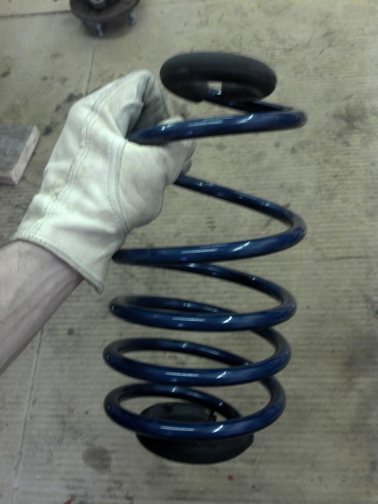

Due to the complaints I have heard from others about the springs clapping together, I decided to shoot a few coats of plastidip on them to prevent any sound coming from them. (this is very common with aftermarket springs so it wasn't a big deal to me..)
I started the install on the rear and once I got my stock springs out, and began installing the YYZ springs, I noticed a big problem that sent a bunch of alarms off in my head. I did read on post from Powell about opening up the eyes on the spring for easier installation on the isolator, but this is ridiculous...
Notice the quarter inch gap between the spring eye and the bump stop/isolator?
This is not the kind of fitment I had expected and I am very disappointed.. I have installed MANY sets of springs and have NEVER had a set not fit in the isolators loosely like this. I would rather them be overly tight like Pedders than have this kind of play.. Powell said it shouldn't be a problem as the springs are always under tension, but I am not buying it.. Whats to keep the spring from sitting off from one side to another and tilting?

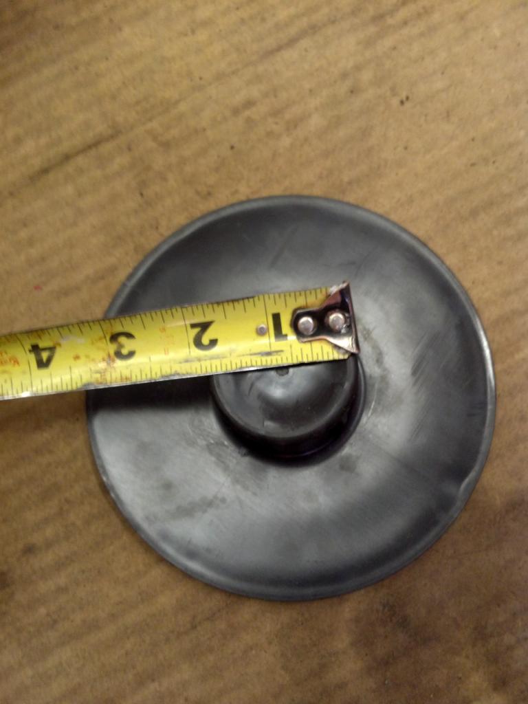

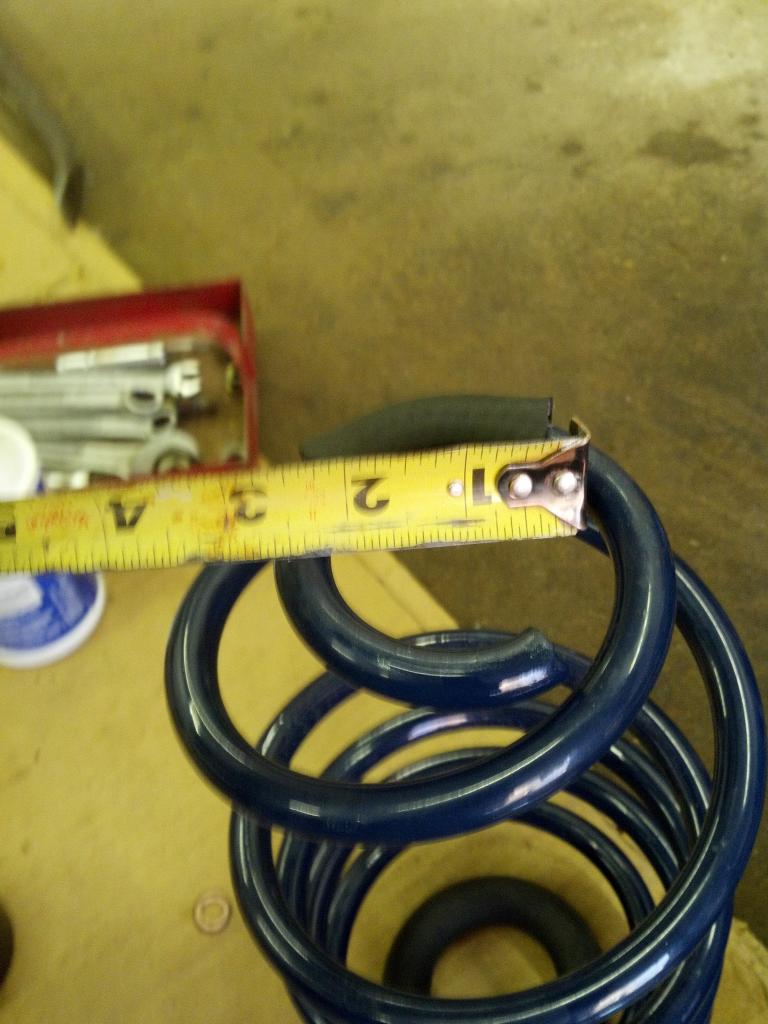

Here are a few pics showing the differences on the eyes between the YYZ's and the stock springs.
STOCK 1 7/8 opening
YYZ V2 2 1/8" opening
The rear springs on my coilovers were larger than the stock isolator also, but they came with small rubber isolators to fill the gap and prevent any play. I was not going to just install such a poor fitting spring on my car and hope for the best, so I thought about it for a while and came up with a pretty ghetto solution, but its working so far. I have some thick almost tar like tape but is very ridged and wrapped the isolators with it until I got a snug fit on the spring eyes. Then hit it with a little black duct tape to cover the shiny tape.
Ghetto fix I know, but my only other option would have been to send them back on my dime and wait who knows how long until they fixed the issue and got my springs back to me. "aint nobody got time for dat!"

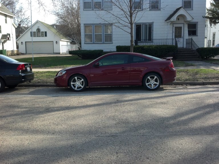

Here is a pic of the car as it sits now.
275/40/17 Nitto Nt555r dragradials up front, 255/40/17 BFK KDW2 in the rear.
