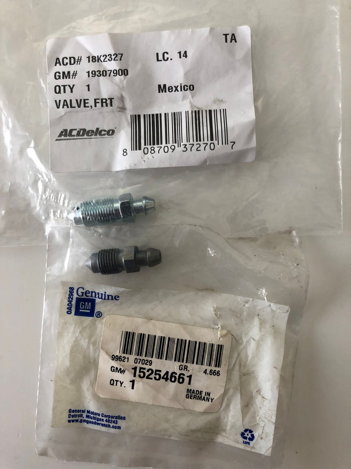

Originally Posted by royce777
ACDELCO18K2327$1.27 a piece on RockAuto
That is not the correct part number. See top item in picture below. You need the one on the bottom, OEM GM PN 15254661.
I had to get this valve from a dealer in Wisconsin. They are very rare...
Yeah and Rock Auto will tell you the manufacturer says it will fit and won't refund you.
