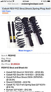

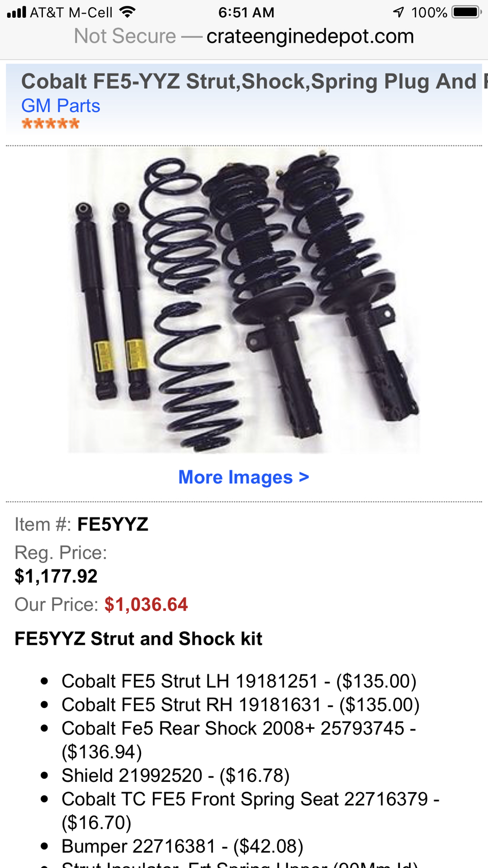

Check out crate engine depot. They have factory fe5 shocks and struts. The also sell a complete plug and play kit with Powell yyz springs which make the car handle extremely well while also lowering it like 3/4". They are progressive handling springs that are worth the money. I had the same setup then down the road I upgraded the shocks/struts to koni but you don't want to spend that much.
