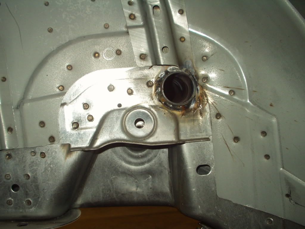

Oh, your subframe bars run down the length of the car, Here is what I had on my cavalier.
Had everything you can think of, front rear upper and lower strut/tie bars, tokico Dspec struts, eibach prokit springs, everything but sway bars and racing rims/tires.

in the cobalt i cant see that doing much.... epsecially something like that in the front. with a complete hydroformed cradle i doubt its going to do anything. its rigid as is.
It keeps the frame rails from twisting, granted much may just be butt dyno, but at least you know, that if there is any flex back there, you are removing most of it with that bar.
Plus, it makes a GREAT platform for triangulating the rear strut towers.

which i never believe those did a whole lot anyways lol... yeah might just be the but dyno... attaching it to the floor is what makes me not believe it but on the other hand i think it would be more effective being attached to the frame underneath. looks like a nice piece though ill give it that.
I agree. That bar isn't doing anything back there.
Well, it bolted to the top side of the frame rails, cavaliers are sloppy *****, so it helped them ALOT, the whole chassis in those things flex and twist.
After I installed it, I felt more like the rear end went around a turn in a even and flat pattern. Like you knew the car wasnt going to come out from underneath you.

this is way off topic but pretty much after the twisting beam mounting points which are in front of the rear wheels, there is not a whole lot to be gained with bracing,structuraly.
If you tied the cavvy rear chapman struts across, or the cobalt shock area with a tube welded in through the structure you might gain something. Like this:
to this:
and pretty much any tie bar with two bolts on a blade attachment is weak as heck. Good for keeping the jack tools in place on a cavvy maybe
