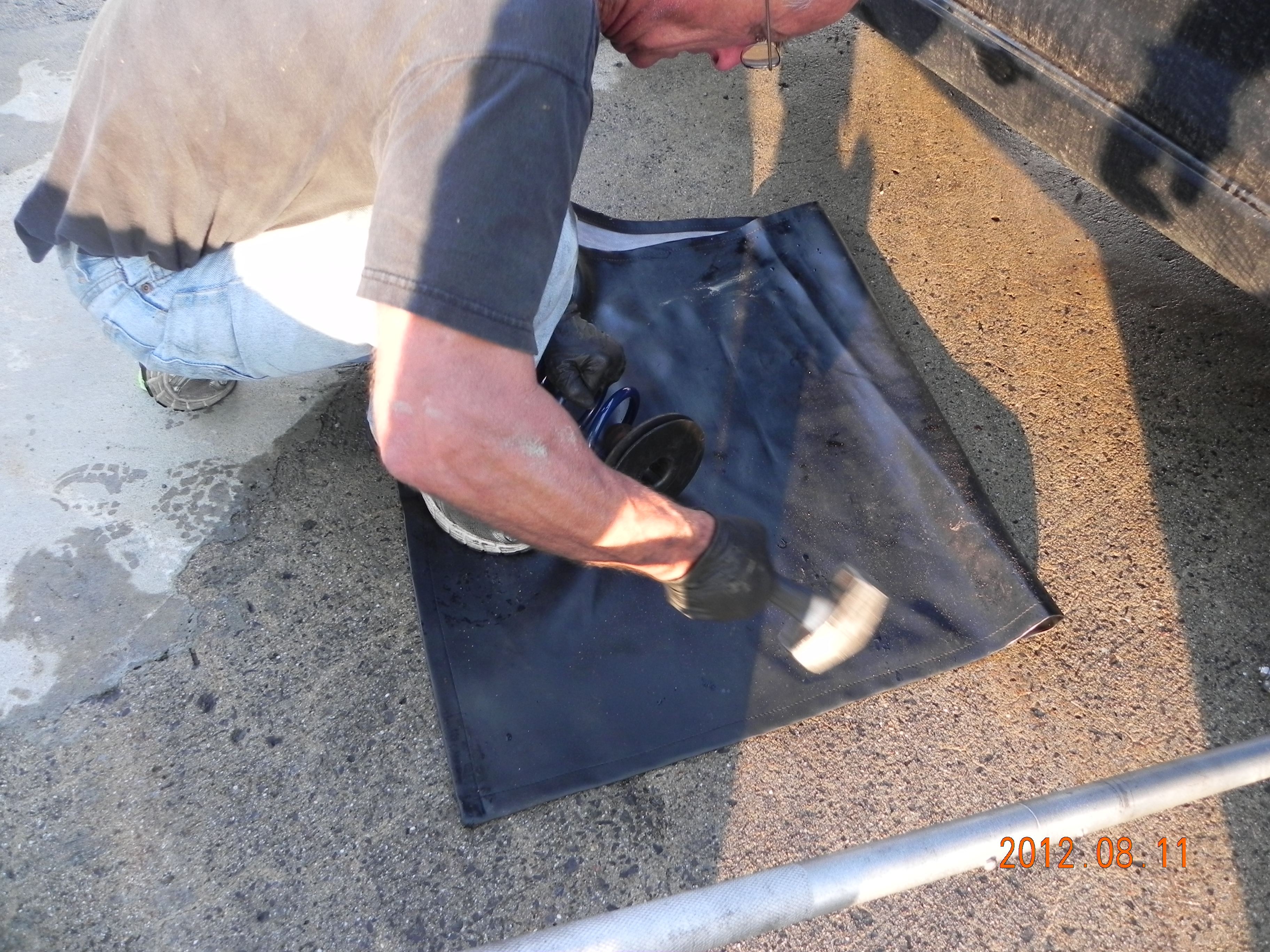

Got mine on yesterday for an autox today.

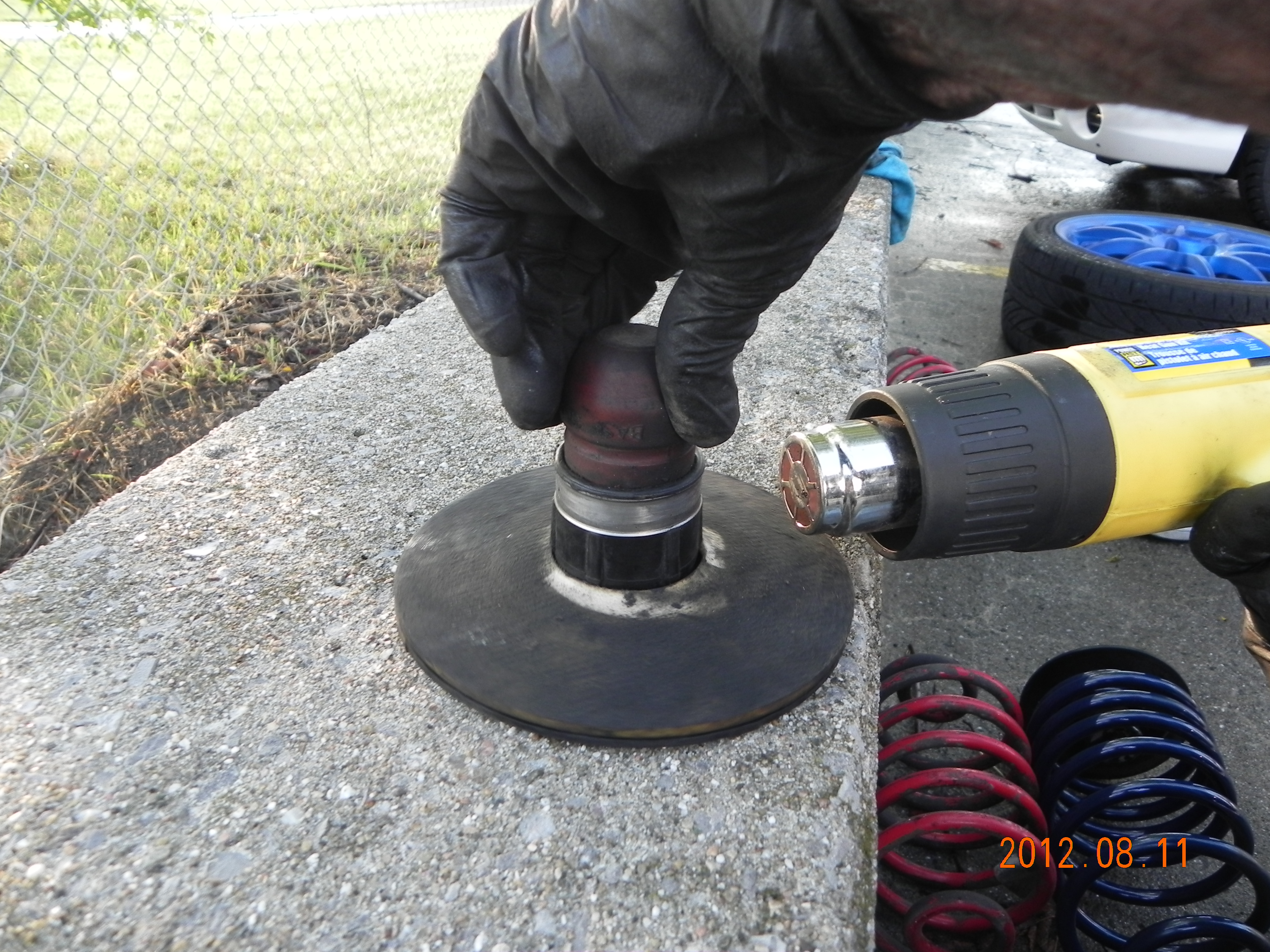

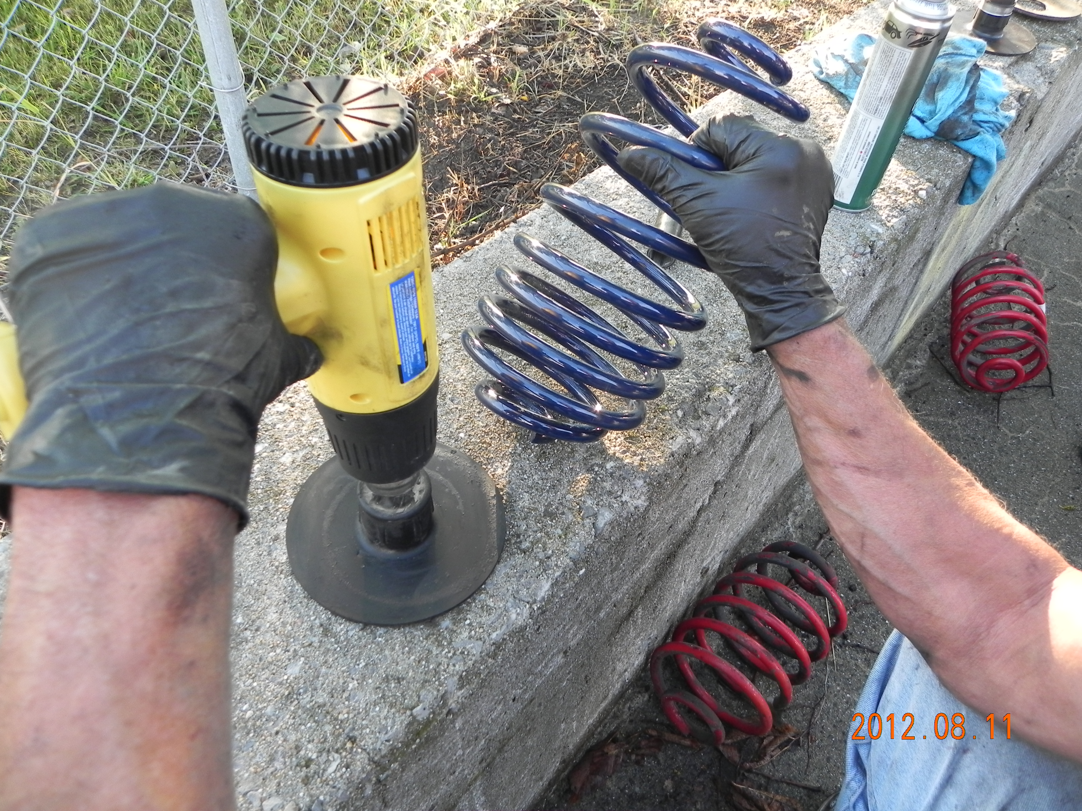

First install: Went pretty easy. For the rears, definetly heat up the center of the bottom perch. Went on like butter once heated. For the fronts I did what John suggested not using a springs compressor. For all F23/auto cobalts with the crazy long passenger side axle, it makes it pretty difficult to do this spring without a helper, but with two people it's easily done.
As for the springs, love them. The ride is IMHO better than stock ss/tc springs. I know it isn't recommended to use FE5 shocks/struts with these springs, but they are still very good. I get a little more rotation, but it comes in evenly and controllable. Also noticed a little less body roll. As far as height, coming from stock ss/tc FE5 suspension mine dropped an inch all the way around, maybe a little less in front but a very good height.

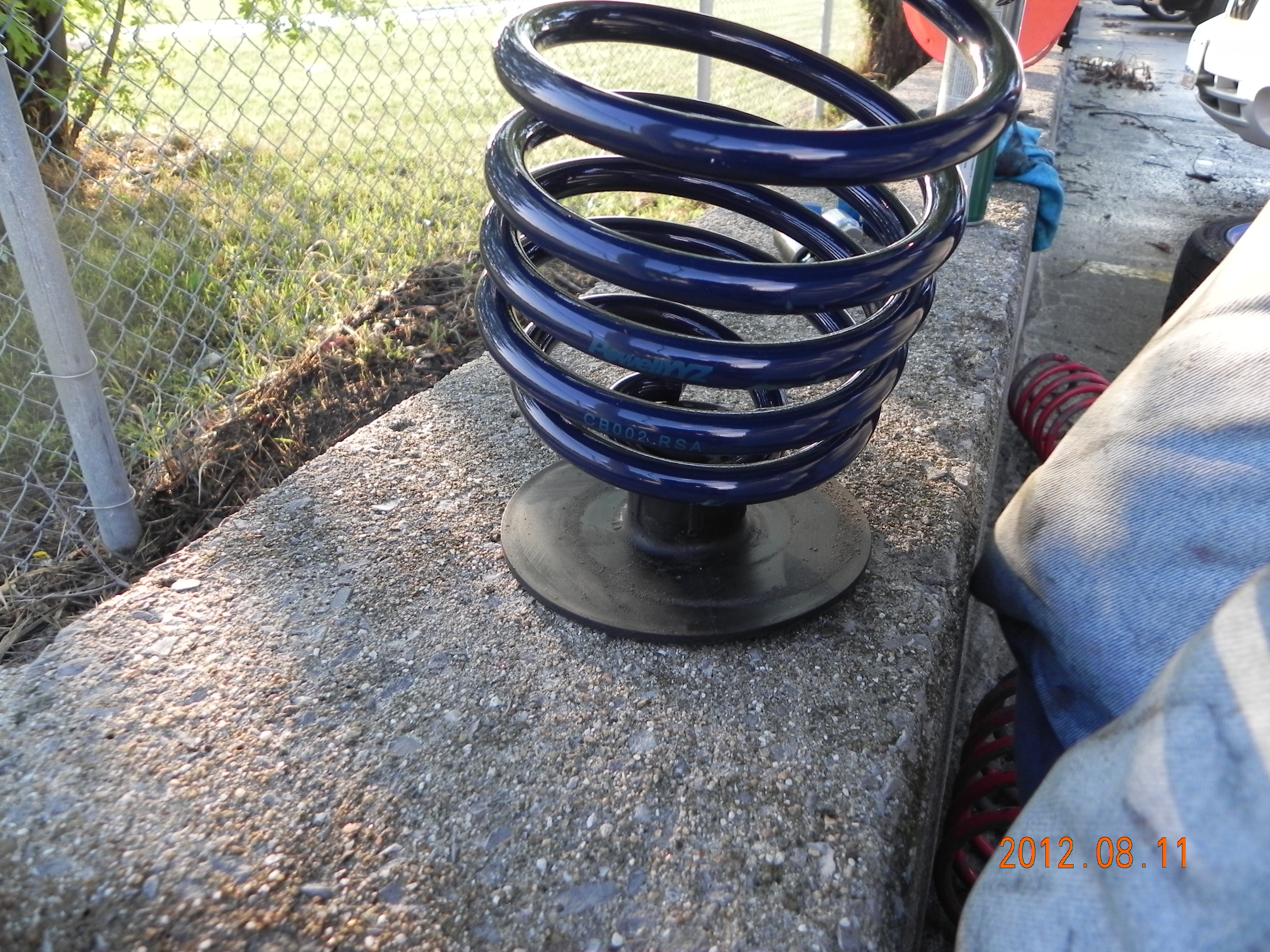

good news. For those who have my trailing cabs undo both the leading and trailing cab bolts so you can get enough travel to so the spring swap; the cabs have enough travel for suspension movement, but not enough over travel for dropping the knuckle out of range to do the spring swap.
For F23 I forgot the long axle on the passenger side, maybe releasing the lower control arm would help that a bit as well. A good helper goes a long way! And I am uploading pictures of the heat gun to add to the how to. Thanks Noorj for paying attention, it really makes the isolators a snap compared to any other way...
no more than 60 seconds seems to work best, dont melt it.

the rear upper go to the lower part of insulator sideways

then use the flat side of a bfh to get it in. put something soft under the spring to avoid abrasion
