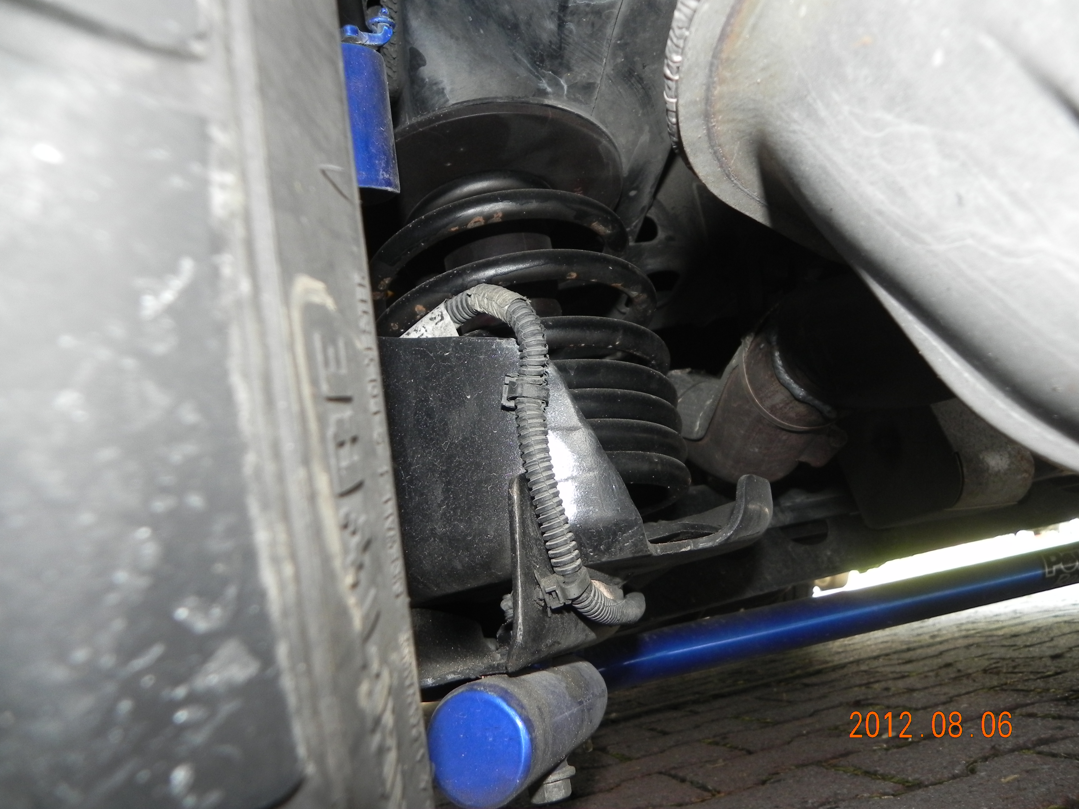

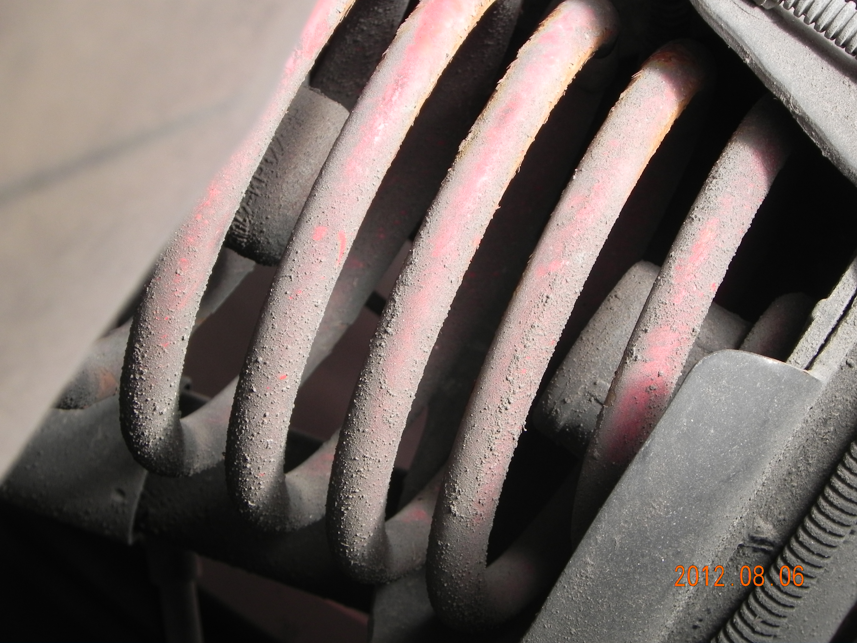

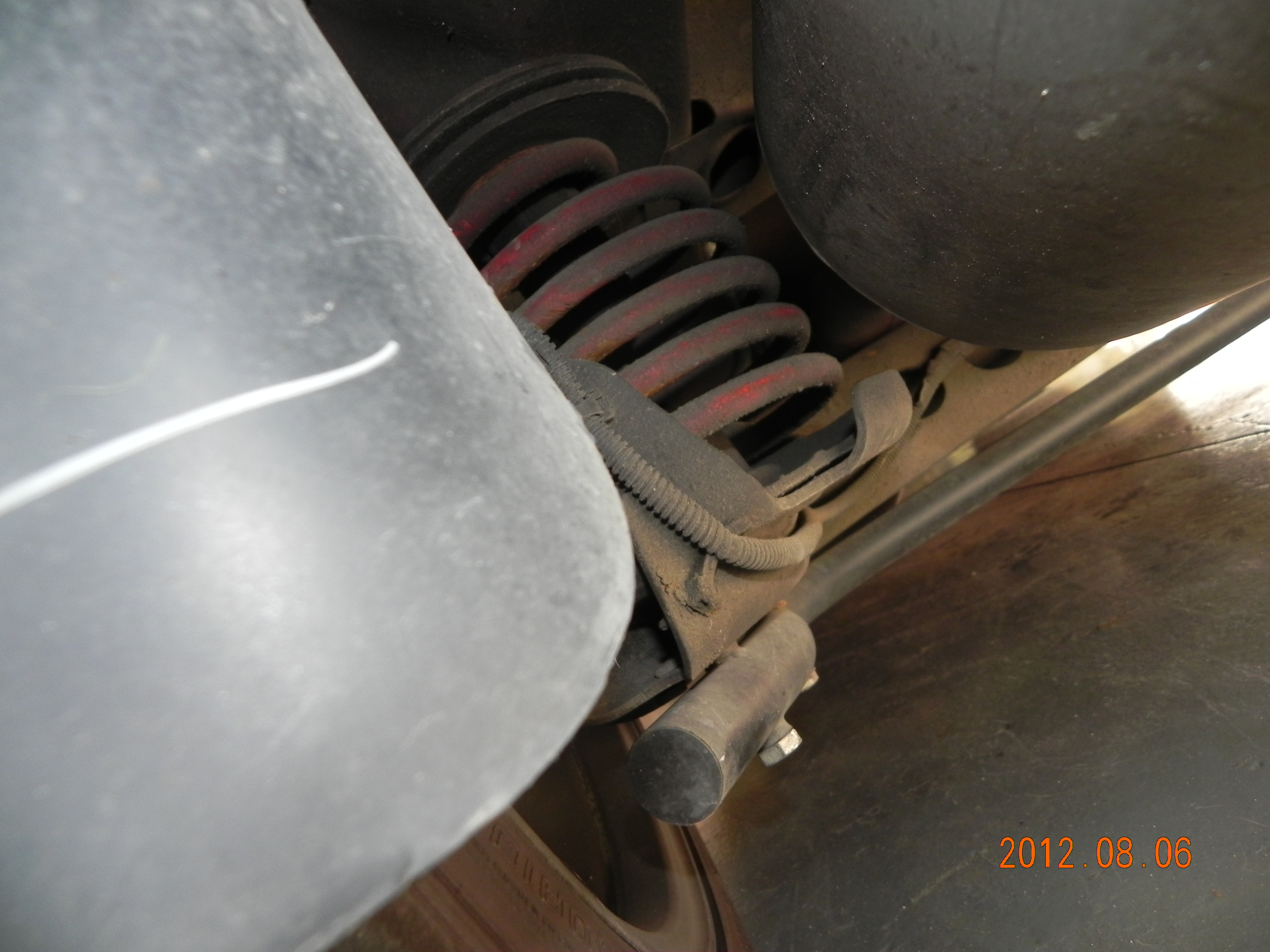

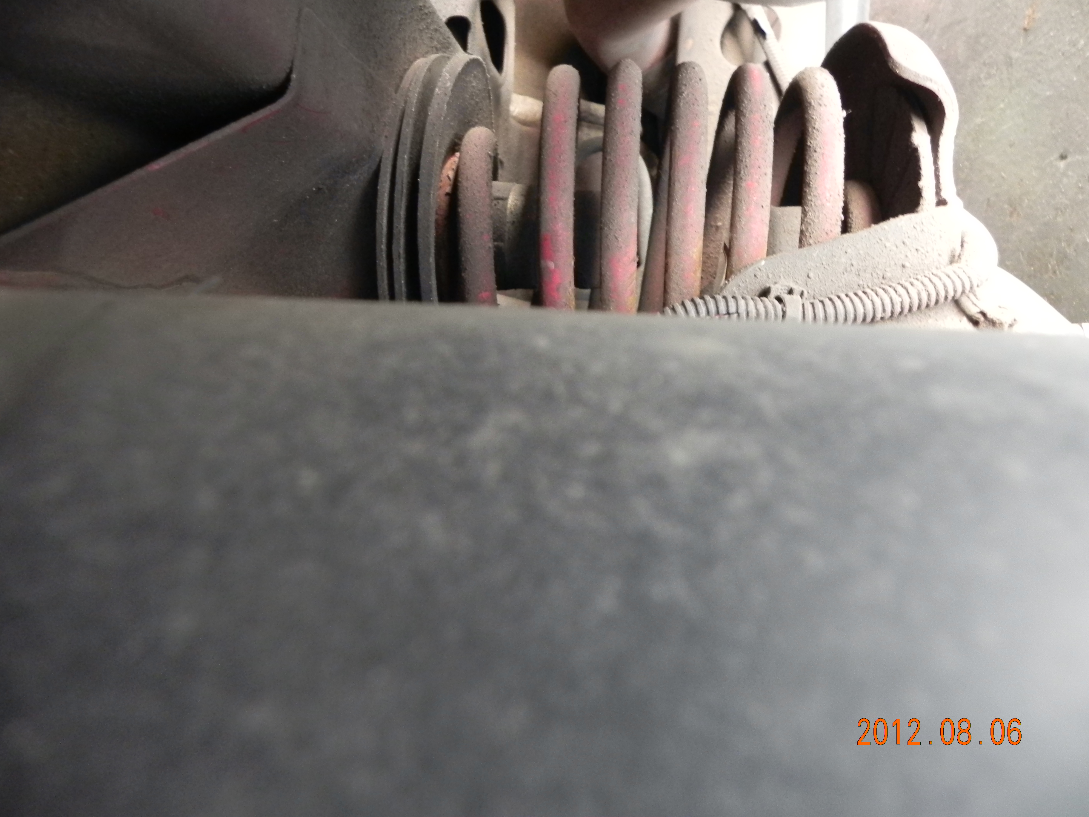

Pedders after miles:
Size:  4.04 MBName:  DSCN6770.jpg
Size:  3.09 MBName:  DSCN6769.jpg
the thing I beleive is happening with these Pedders, is that they are low in linear rate and have short free length to acheive a drop. So small spring diameter, they get over stressed, become plastic and take a set; u can see where the rears are actually rusting where the coils hit. All the coils are binding at load. I will post ride height pictures later, but its clear they are low left side, as the tracks Loki goes to all turn predominantly clockwise.

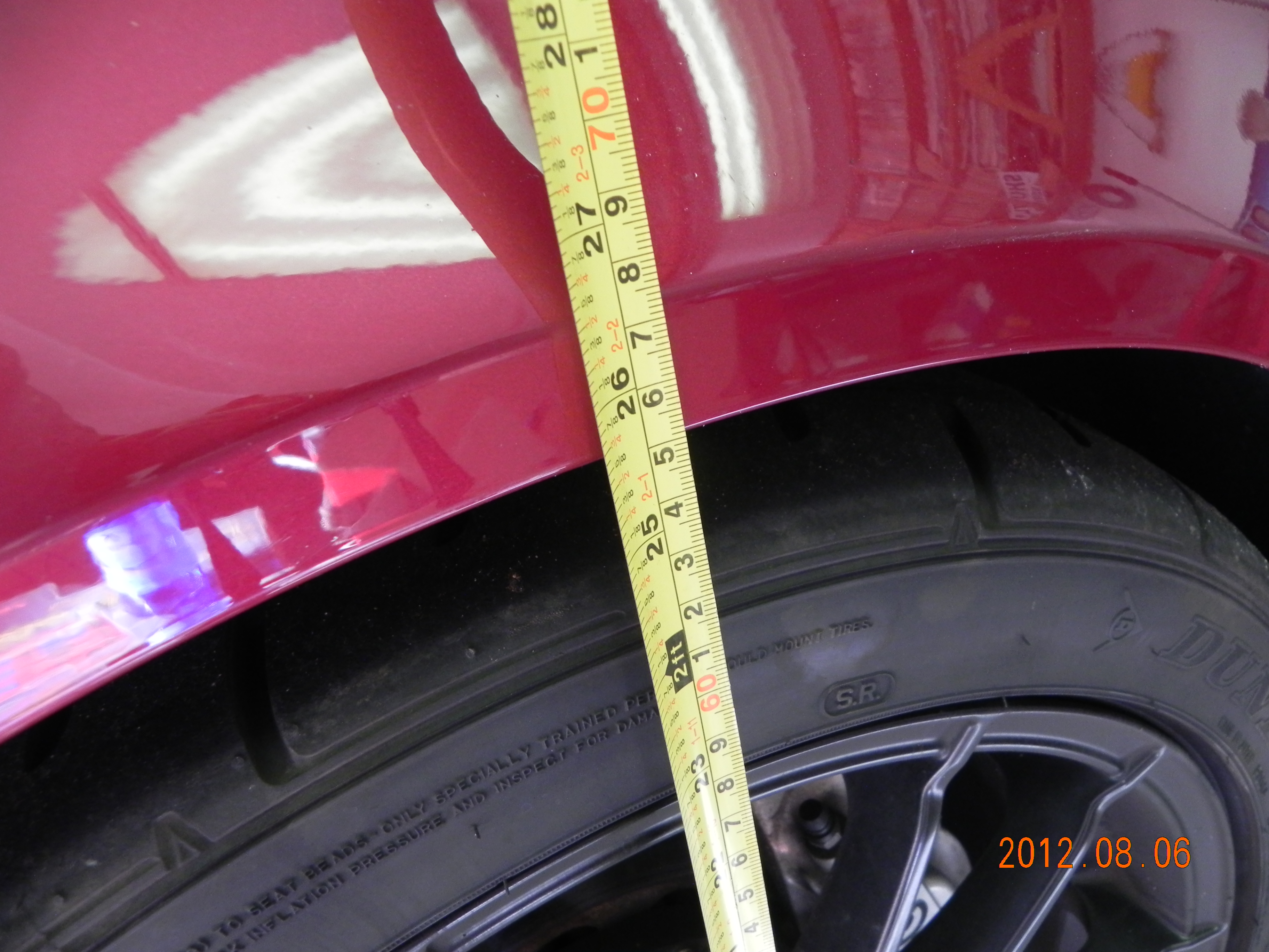

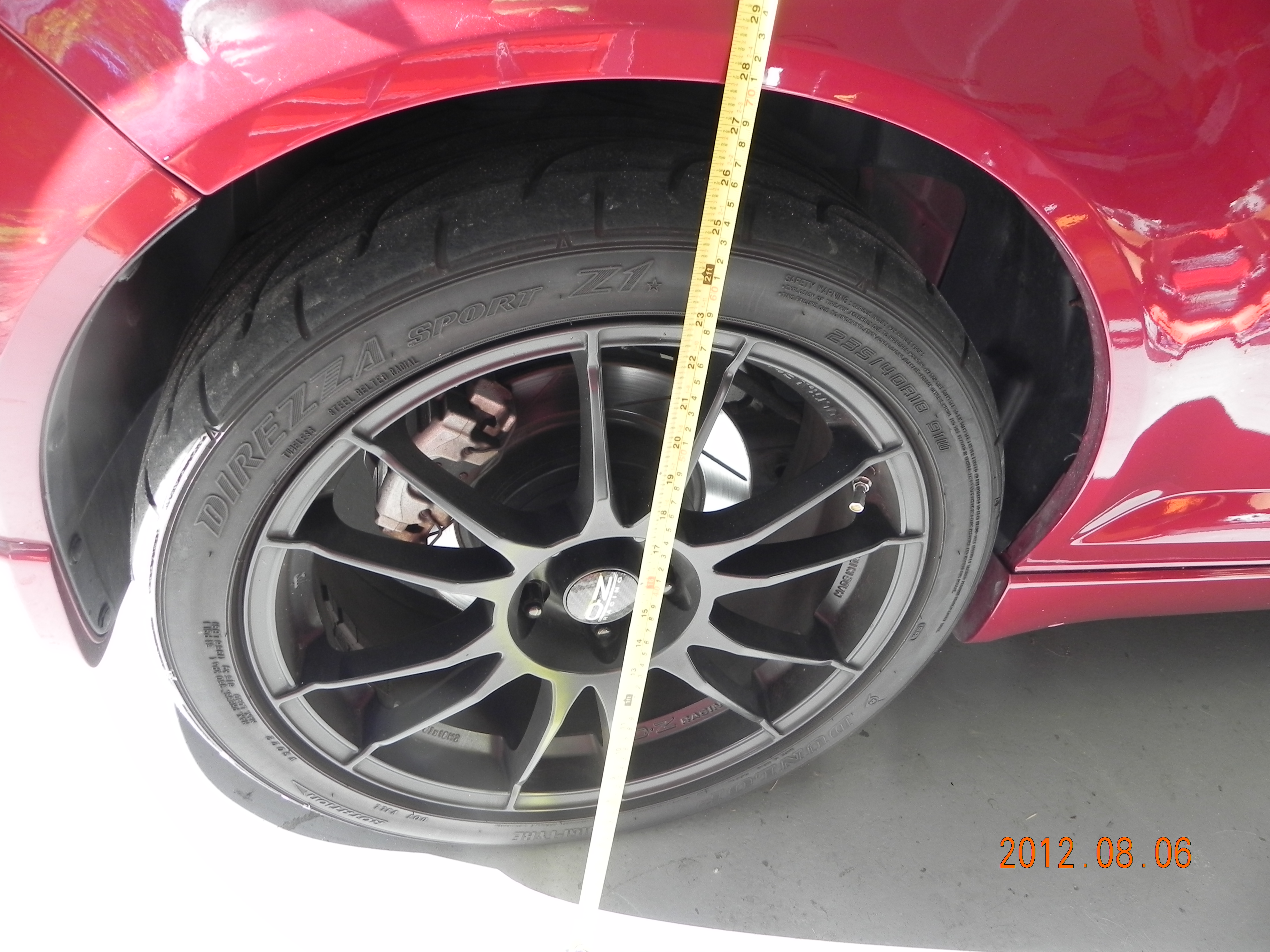

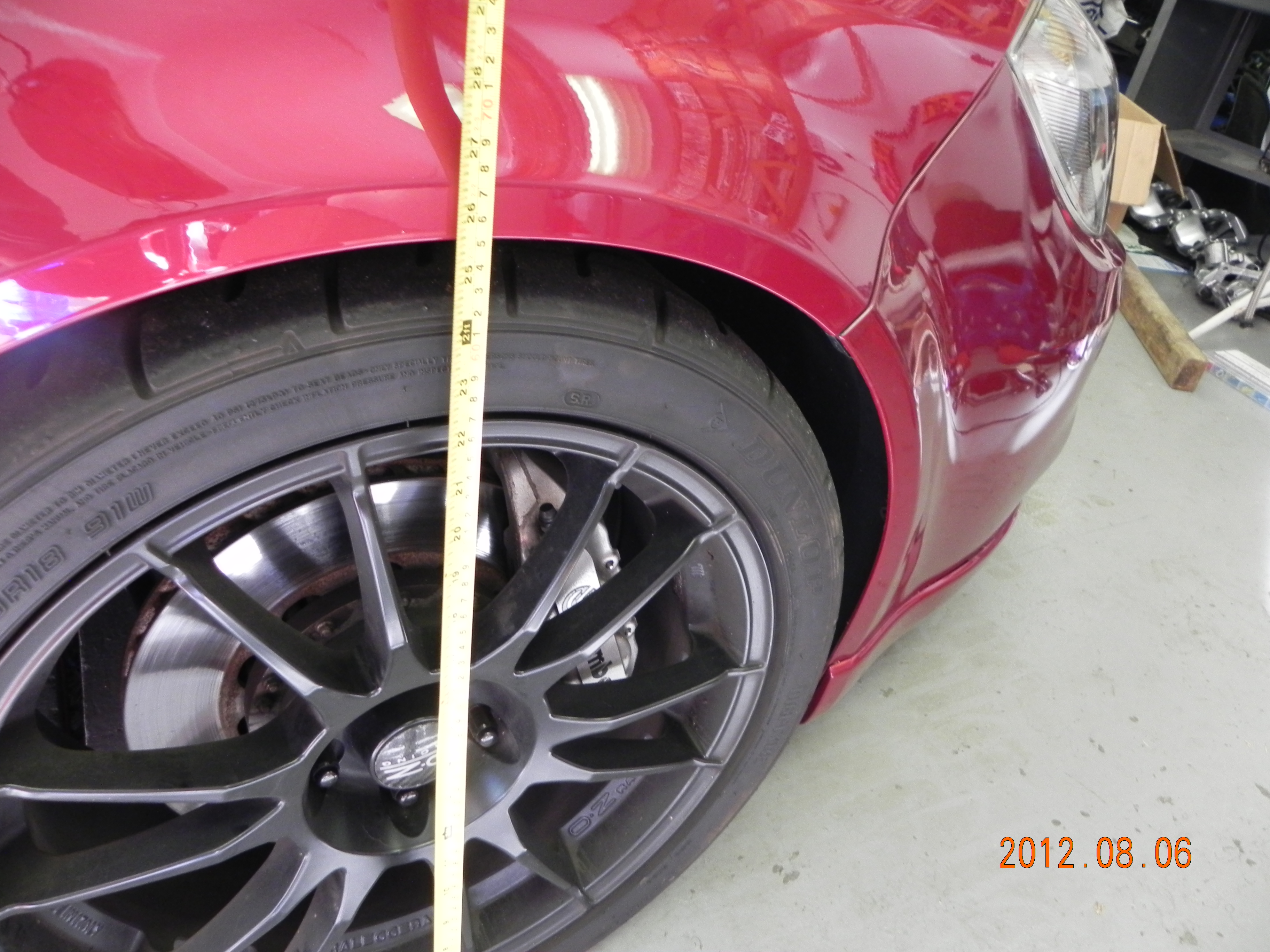

and now: YYZ prototype
Now, this is Loki's car with Pedders. Later this week I can publish the same positions with YYZ. let u know Name:  DSCN6779.jpg

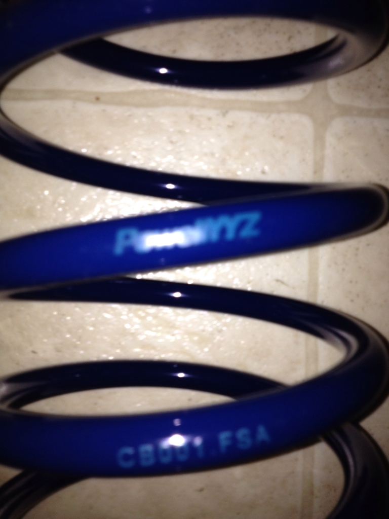

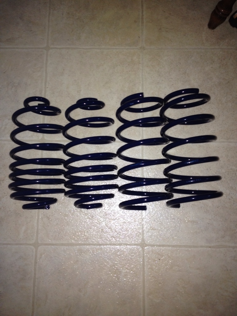

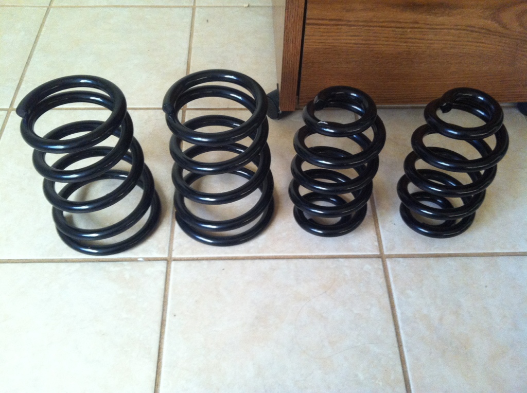

Mine came today! I just really wanted to thank John for not only the springs but getting them to me so fast so I can get a couple autox's on these this season. Really appreciate it man! Love the color too. These will be going on my car tomorrow with the fairly new ss/tc FE5 suspension, so I'll post a review of the ride then and a review from the autox on Sunday.

What gauge are those springs? I think mine might be a little more beefy.
Haha what springs are those?
Old Aug 8, 2012 | 08:11 PM
  #200
Powell Race Parts's Avatar
Joined: 04-25-11
Posts: 6,128
Likes: 47
From: Port Perry
could be T3 springs which are simply hopeless to drive everywhere. Kinda like Linear coil over springs. Trolling the YYZ thread.
and btw, with no preload at the rear, the coil overs out there produce the bounciest coil over u ever seen/felt.
