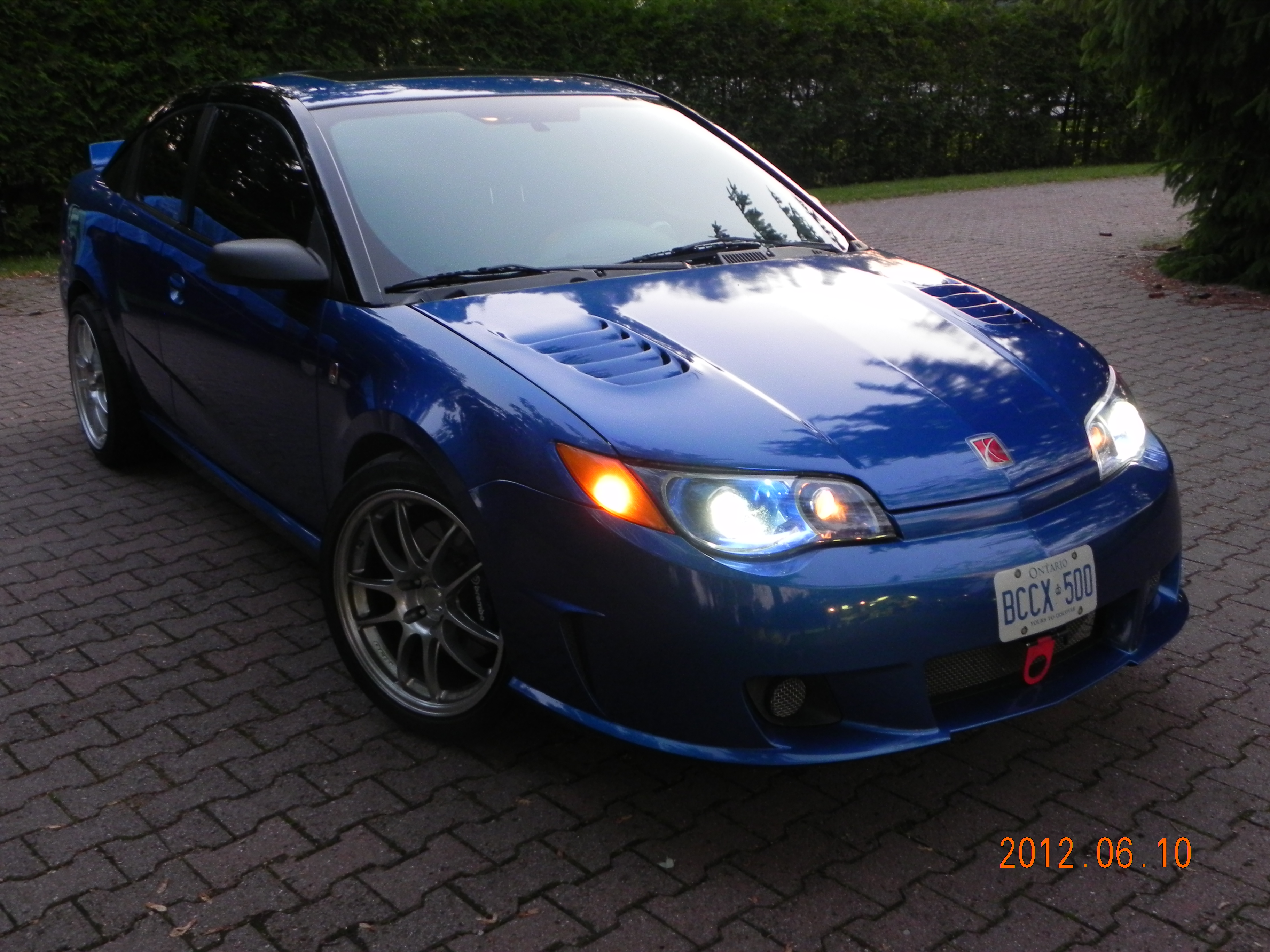

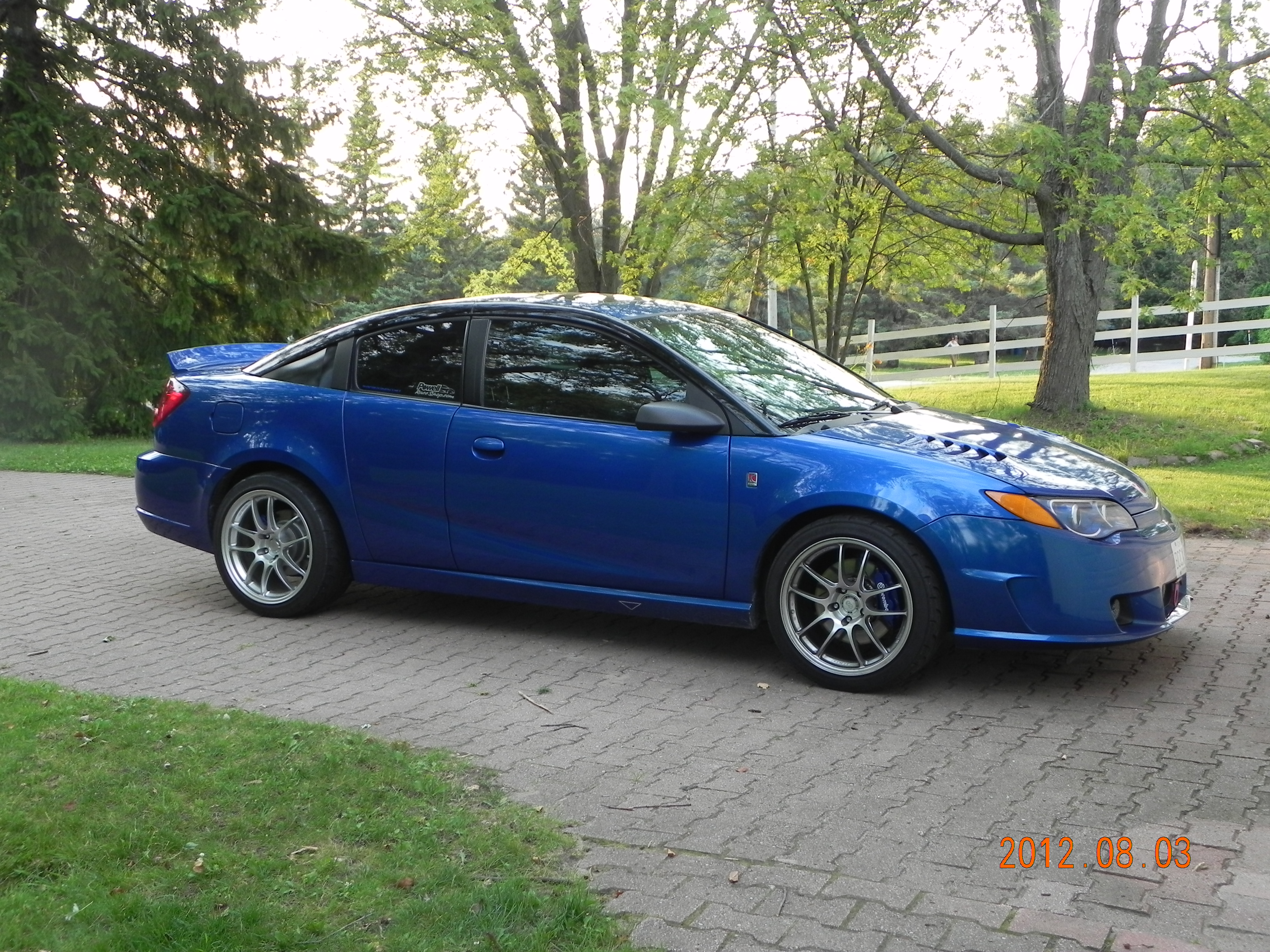

YYZ today

do you notice how the really fast guys have pf01 and tow hooks?
