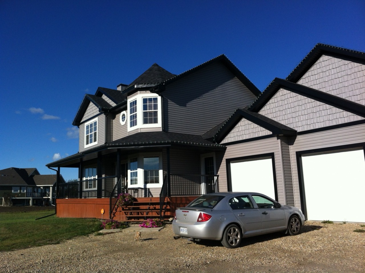

Real life. Amanda just drove her YYZ cobalt from Port Perry to Grand Prairie Alberta, about 54 hours driving time from 9 am Monday, arrived at about 8 o clock our time/ about 2300 miles.
Note the trim heights. Its important to note that the car is loaded with all her earthly possessions and her GF who co drove with her.
( Stiner who posts here is out there with his GF already, so its like a clan of locals from our town, moved out to the wild west for ez money and fast wimmin in the shady saloons and OK corrals in the shadow of the Rockies.
The point is, the YYZ ride was good in all road conditions while loaded; the car doesnt sag down at the back, even with that load. Thats due in part to the quality of the spring material , the progressive spring rate and the solid load design numbers which were met in production.

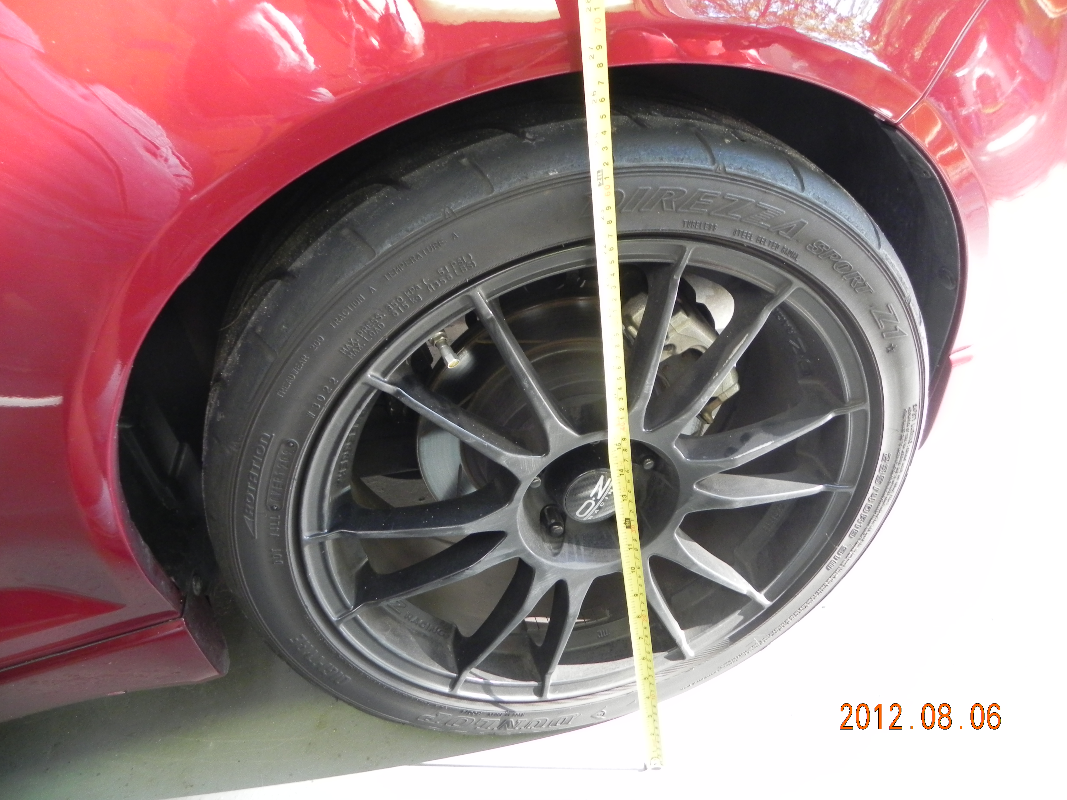

Measure your car like this through axle center line , ground to fender lip, and tell me what your numbers are, front and rear on level ground. PM or email if you like, the numbers you have to john@powellraceshop.com

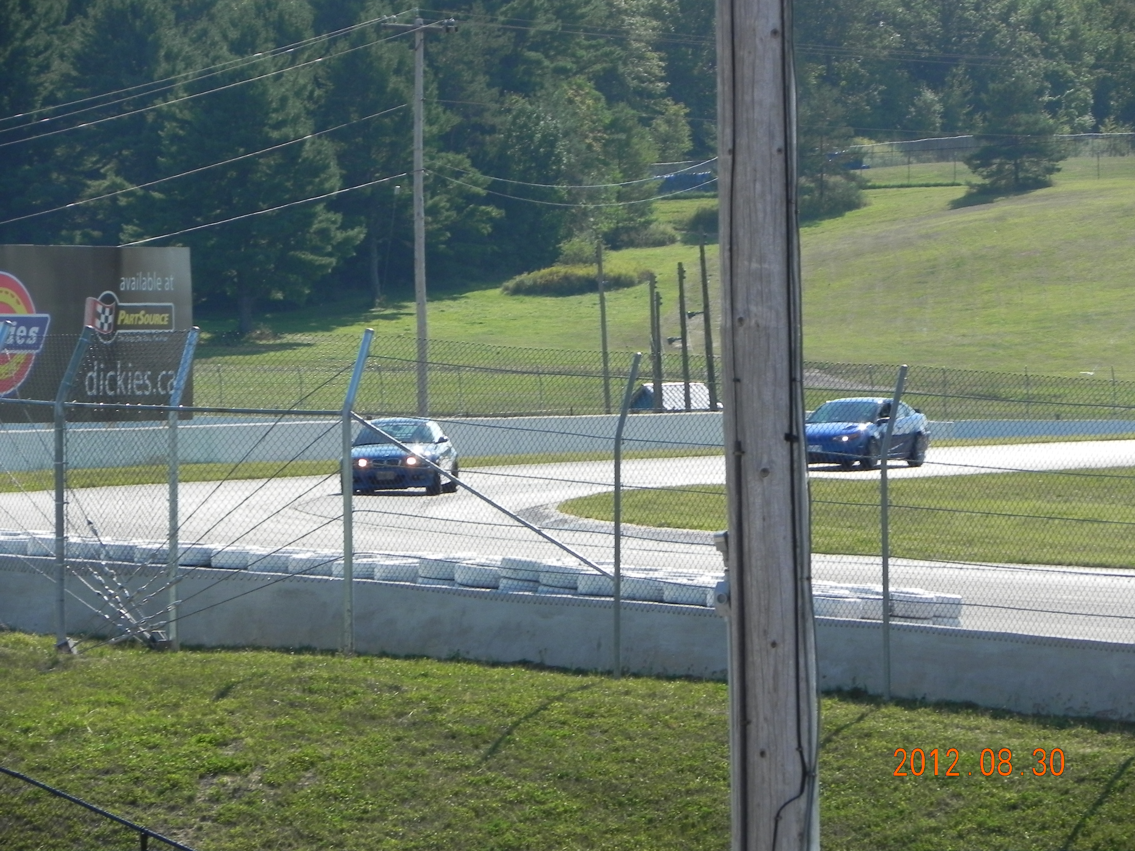

YYZ track test today
Ran at Mosport today. Bottom line, the YYZ are a rush! Awesome handling and big g's . Of course the tripleX bar helps but the rear Koni's help a lot, the skipping at the rear is gone, and until the Star Specs get some temperature just a hint of oversteer in the faster 100 mph turns. Really compared to all the other springs I have tried, this set really works the best for me. And a nice ride home!
on pit lane
E46 Dinan caught and signaled to be passed lol
