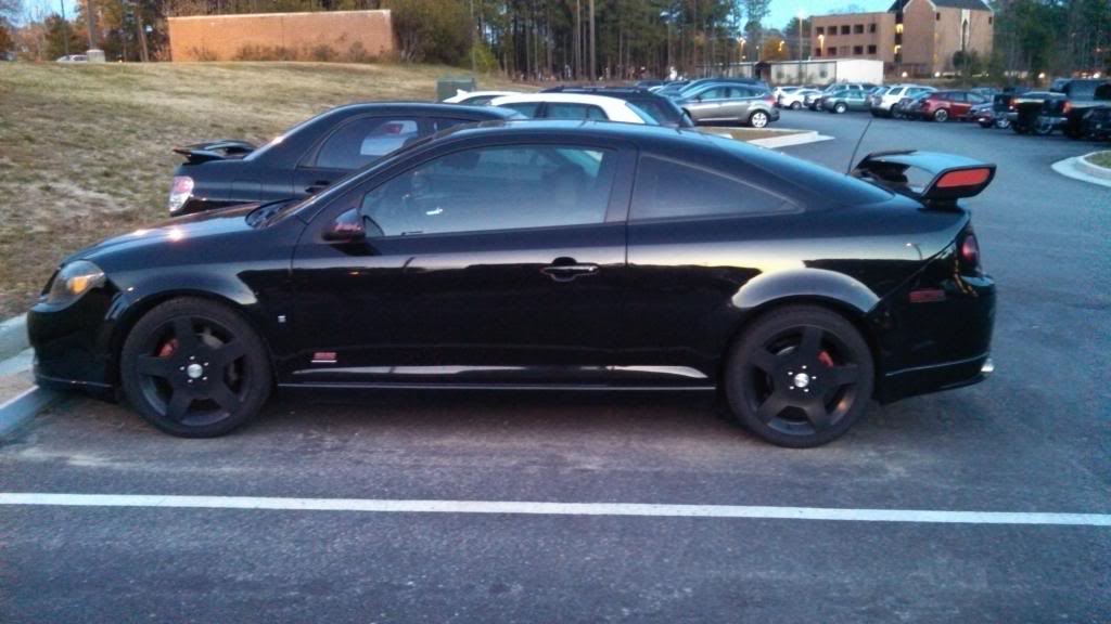

Before.

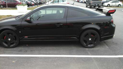

After.

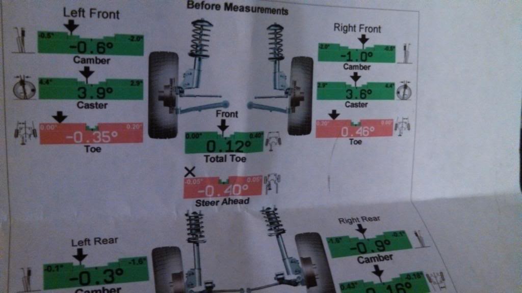

Make sure to get an alignment!

pretty decent. Looks good.Andrecarr1993 came up from NY an visited, what a nice guy! Car is on YYZ and TC wheels with Conti DWS ( I run those for winters on the wntrbtr2) and looks very good. After installing cabs I reset the alignment a shade over 30 mins total toe in. Thats close to factory specs, I prefer zero but it was a long afternoon and it was time to go. Poor Andrew has a loooooong drive home..... ThxGov, your toe in is close to zero if its a tenth of a degree and I would prefer that for the summer. (did i read that right in your post? )
I cant see if the car is square or not, as the bottom of the read out is not visible;it shows negative toe left front wheel and positive toe right on the front, and thatss all confusing to me. Strings are easier...

That was the before alignment before it was corrected for the springs its all in the green now. I'll look at actual numbers tomorrow and let you know. The car feels great handles like a go kart again. eeded the new struts and springs.
