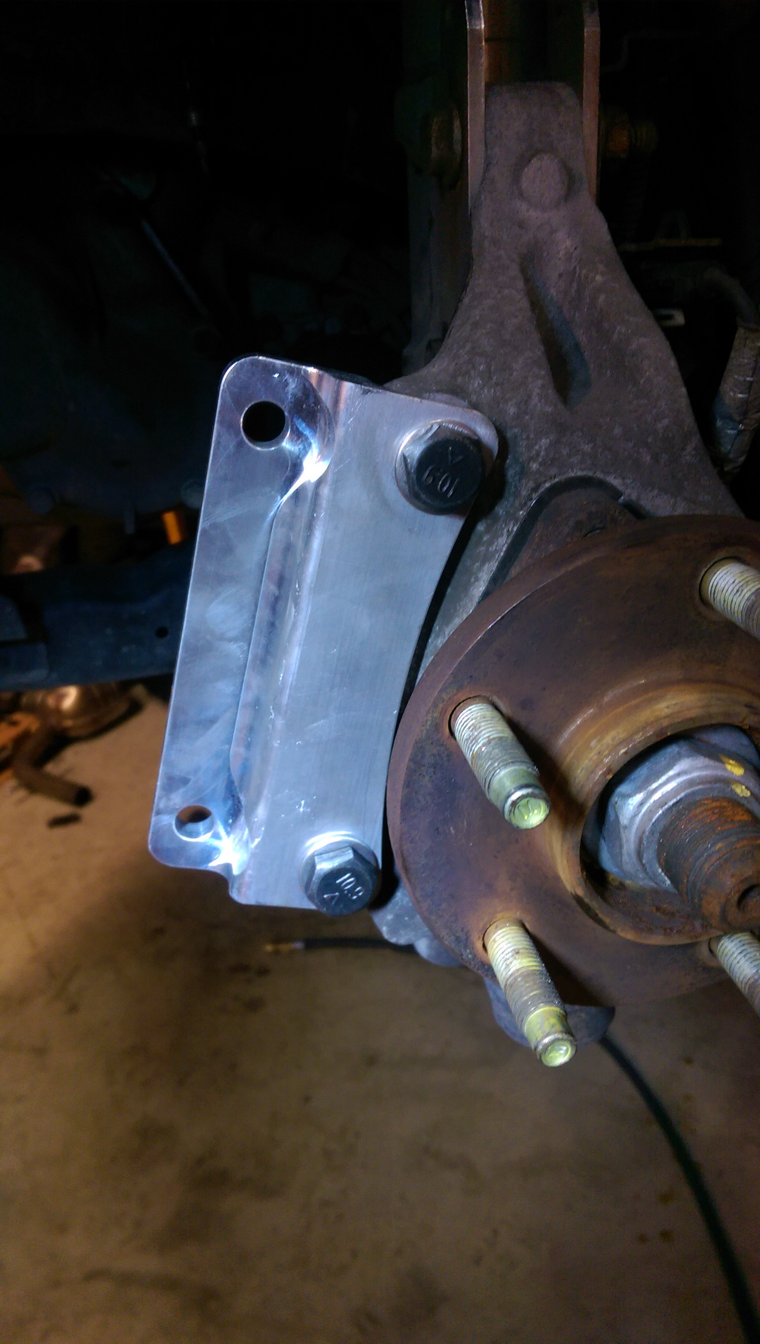

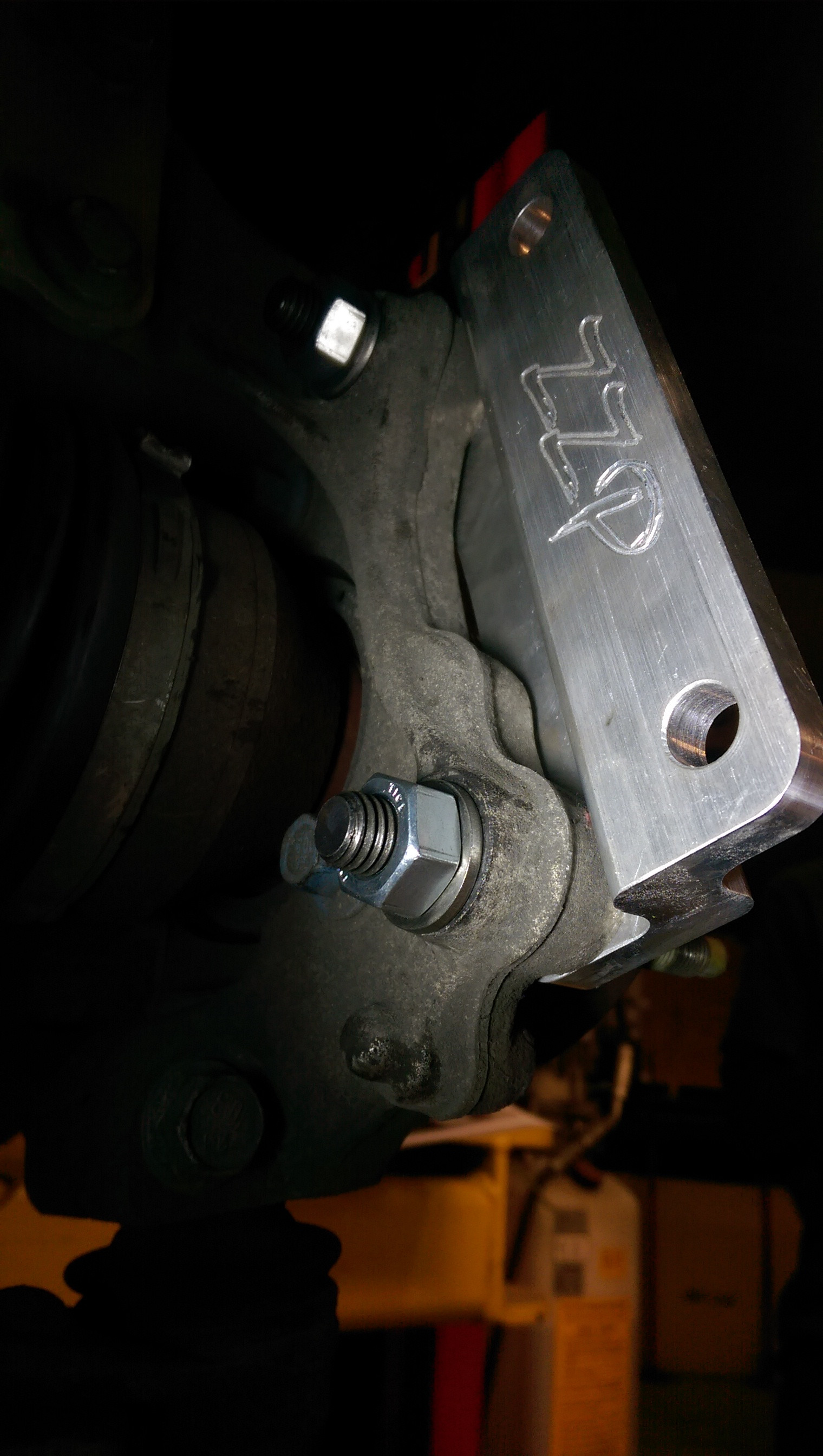

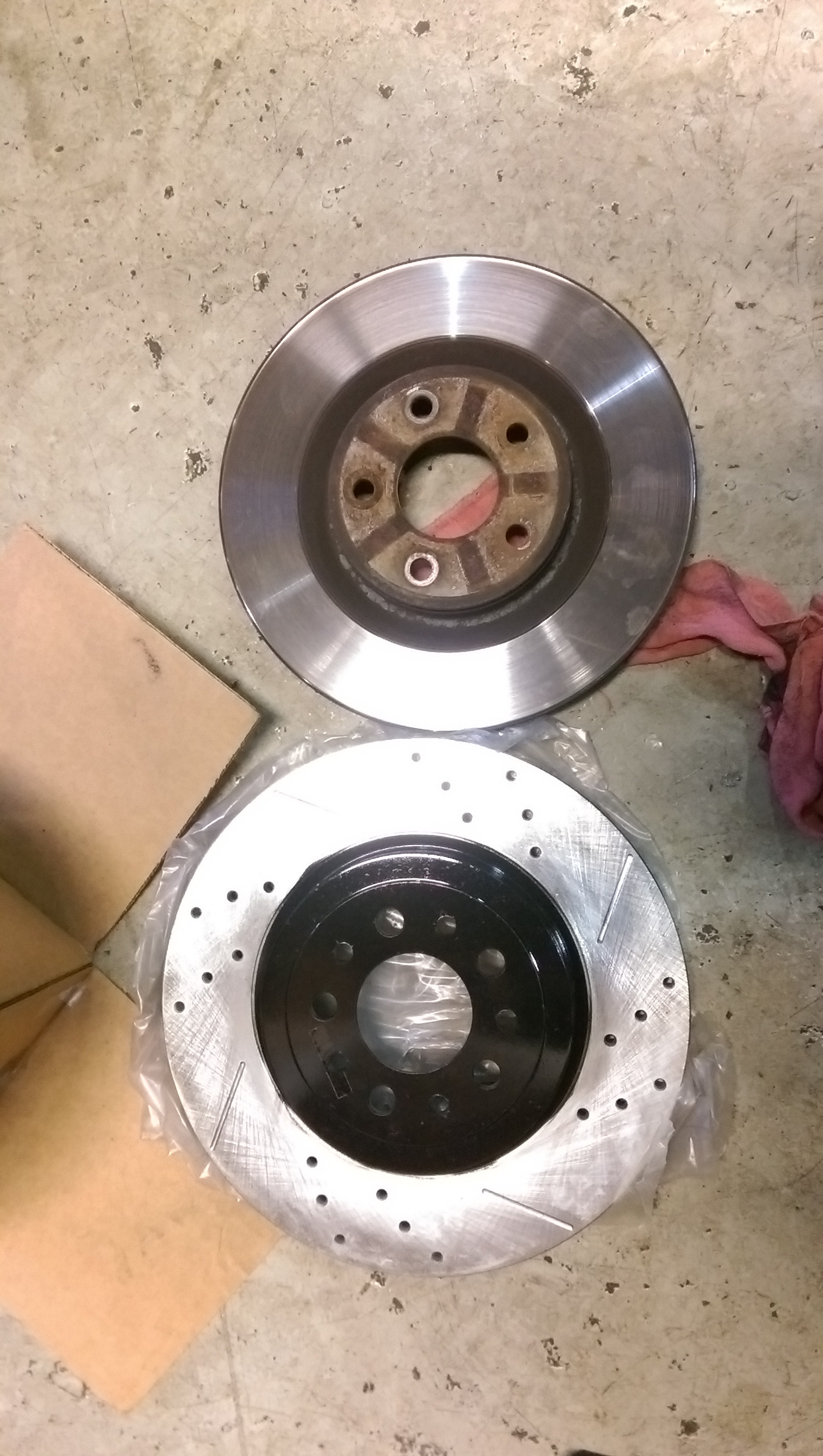

was going to just do pads and rotors but decided screw it ill just pick up zzps kit

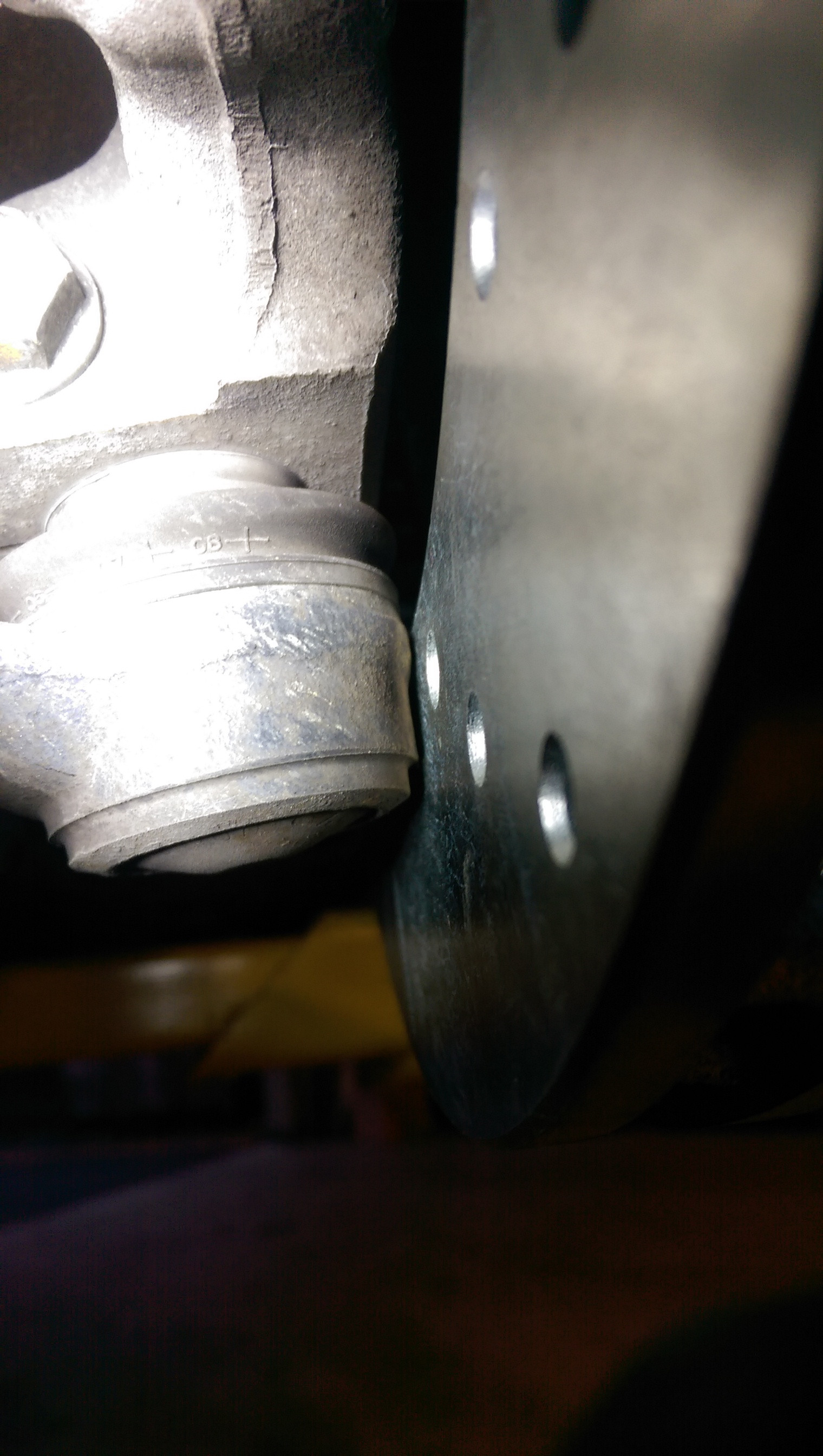

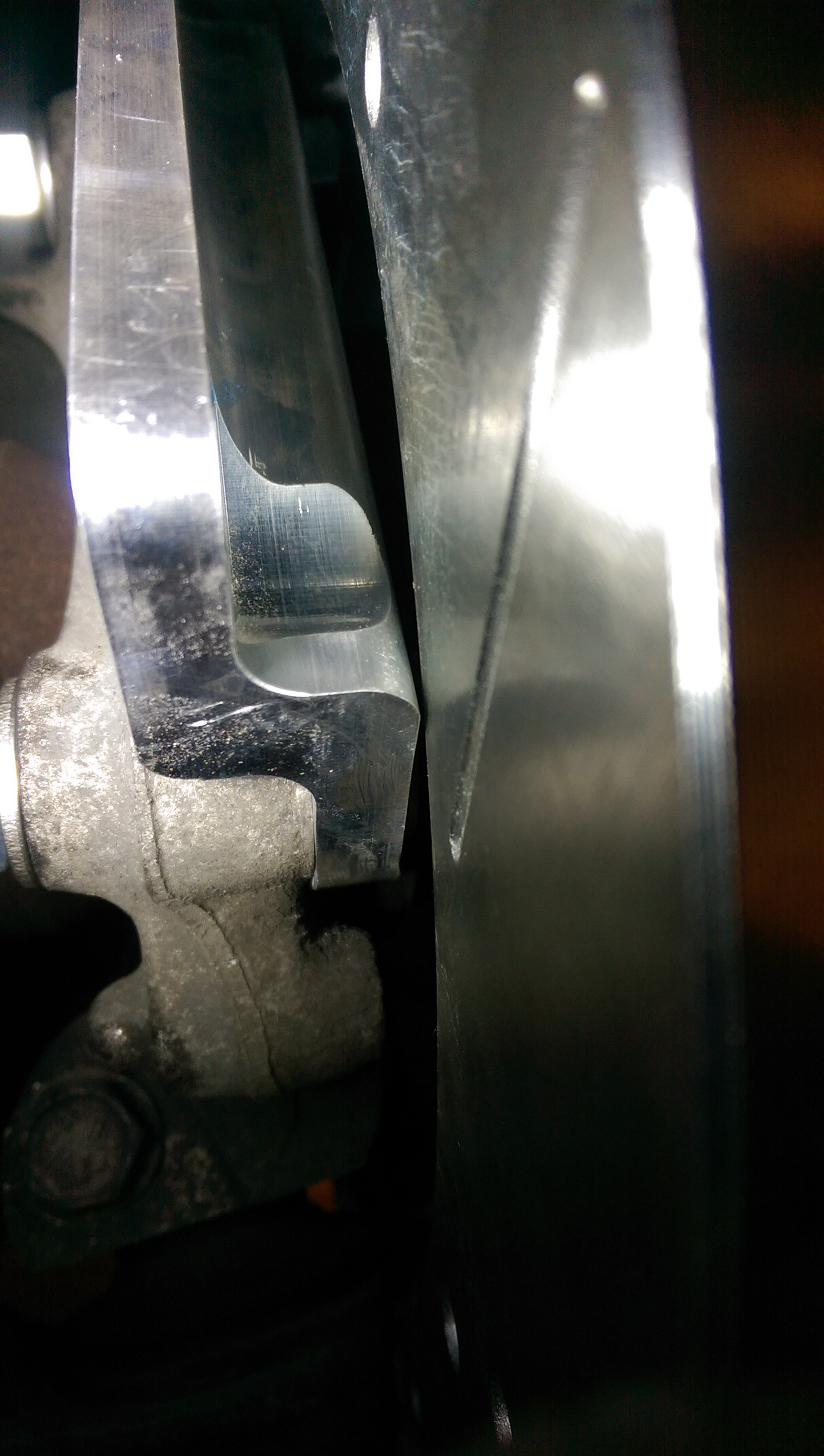

got one side off, bolted the bracket on as per instructions, went to go put the rotor on and the rotor hits the balljoint and bracket, also cant get the caliper between the bracket and rotor
so im not sure if i got sent the wrong rotor or whats going on, or if im just missing something and am retarded

Reread the instructions, looks like issue is the caliper bracket bolted to wrong side of the knuckle

That's what I was thinking, doesn't it bolt in the other way?

Looking at the pictures again, i think these guys might be right. Seems to me the ZZP logo should be visible from the outside not the inside...
nope,

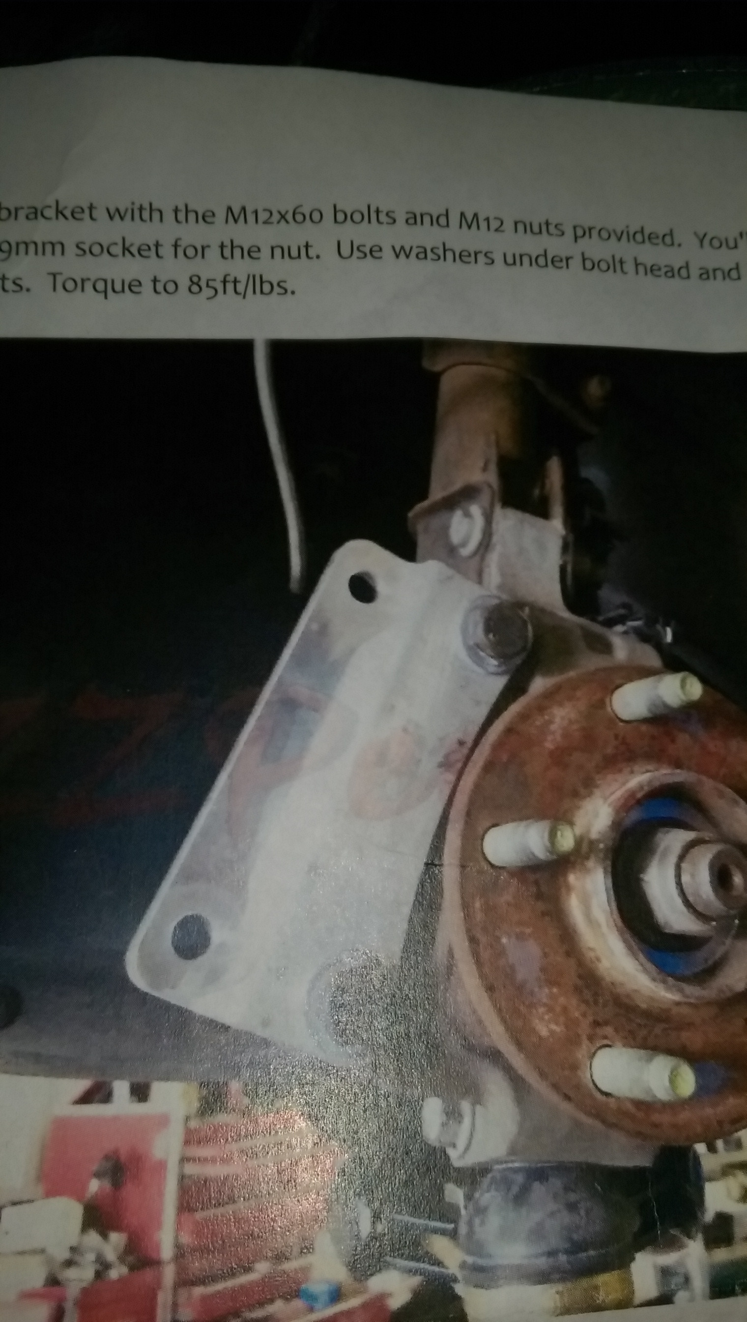

either way the rotor would hit the balljoint, flipping the brack just makes it smash into the rotor even more.
this is a picture from the instructions

my setup

ya its kind of frustrating but im not to worried about it, i understand **** happens so im not getting to bent out of shape, i emailed zzp and im sure ill hear back from them asap.

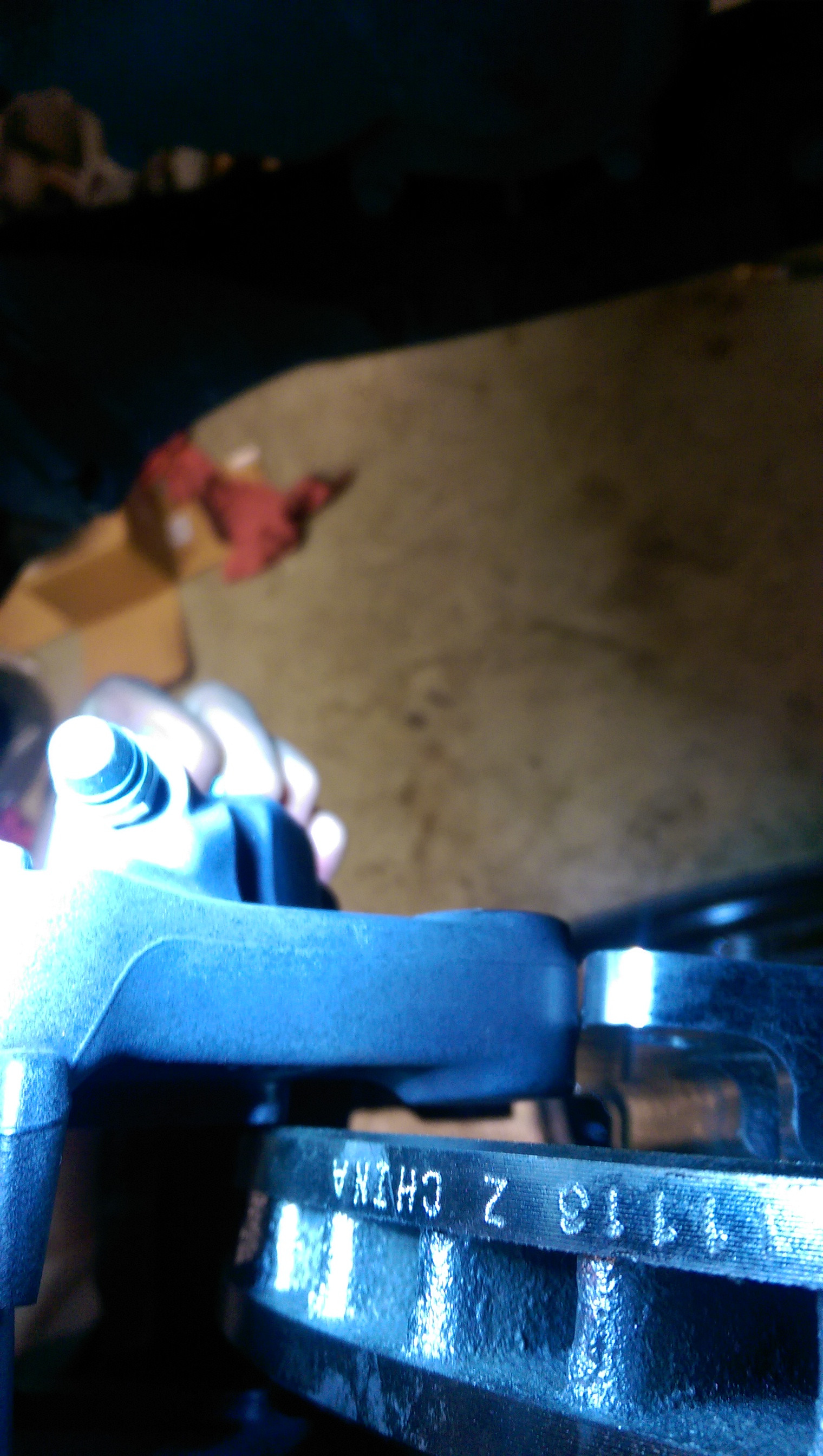

never thought to check if they were actually 14.5
going to assume wrong rotors

Well that could do it...
Seems like that has to be the issue.
