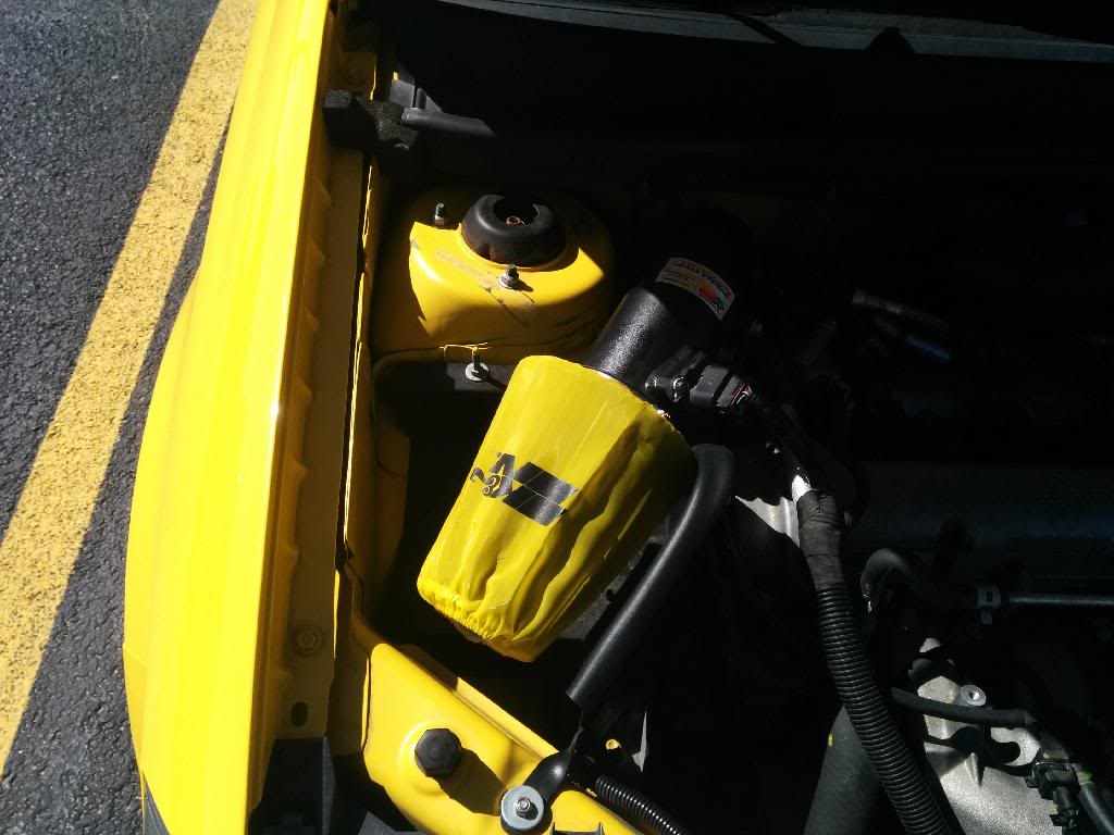

Quick pic of the K&N filter wrap

All the filter wrap will do is help with shedding water and large particle filtration

yes that's what it's designed for, but anything to prevent fast clogging will hopefully be an added bonus. Especially if the filter passes as much particles as everyone is saying.
