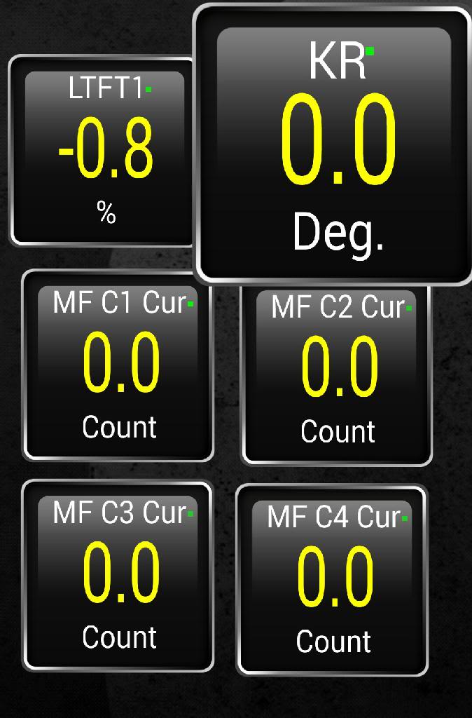

Just a bit of an update. The filter wrap has dropped my LTFT from 3.9 to 2.3.
That is the lowest I have ever seen with the K&N on. 3.9 was my previous low. So I can see that the filter wrap does help with LTFT. I'm sure it's added some restriction back. BPV and intake noise is still pretty high if not a touch quieter.

For those of you we higher LTFT from K&N filter, the filter wrap has dropped my ltft to near 0. I am very impressed.
