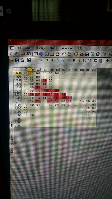

Change the graph to max, and subtract that from your timing tables, if the knock goes away its because of timing. If it's still there, the issue is most likely fuel or air related
this^

Already did that when I saw it but I was just concerned because I noticed it when my turbo started doing making this sound https://www.youtube.com/watch?v=XXDfYpd9NGQ but I think I uploaded a old tune and that's why

Do a leak down test to find out, but I doubt it since it knocked after pulling the 3 degrees or whatever your max was from the timing tables. Honestly you need to get your tune file looked at, as Area47 said ecu defaults to knock when something isn't correct.
