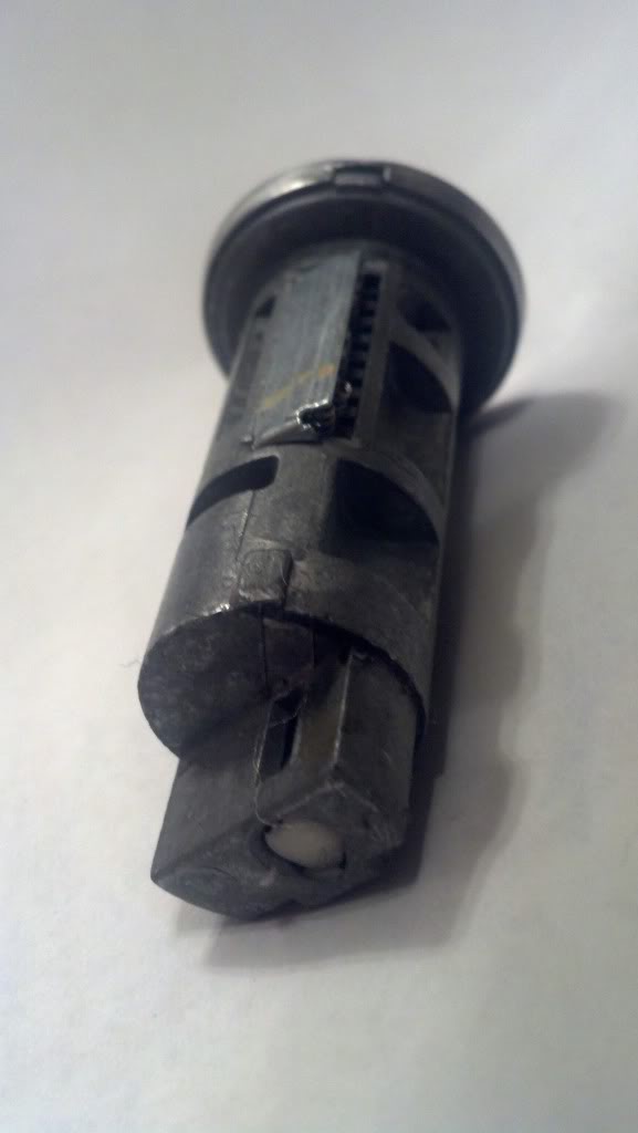

What happens is the little flap holding the tumbler springs is not secure and opens. When that happens the key stays put. Not sure if you can do something proactive to prevent the problem.

It's called a redesigned cylinder which GM has to fix this problem.
