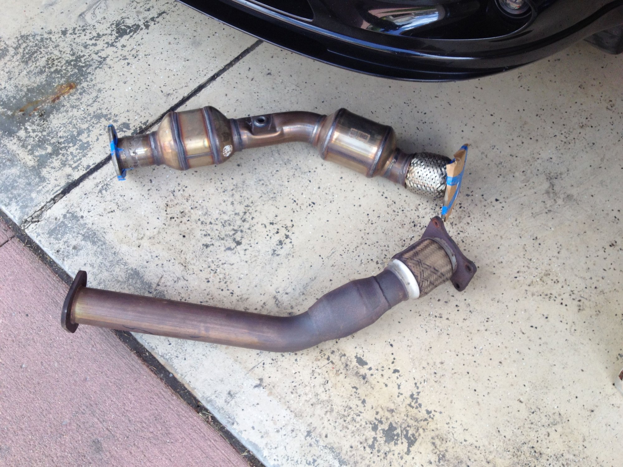

Yes keep your stock down pipe. I run the Hahn hi-flow dp and it didn't pass emissions.
When you see it and the stock dp with dual cats side by side, you can understand why lol
