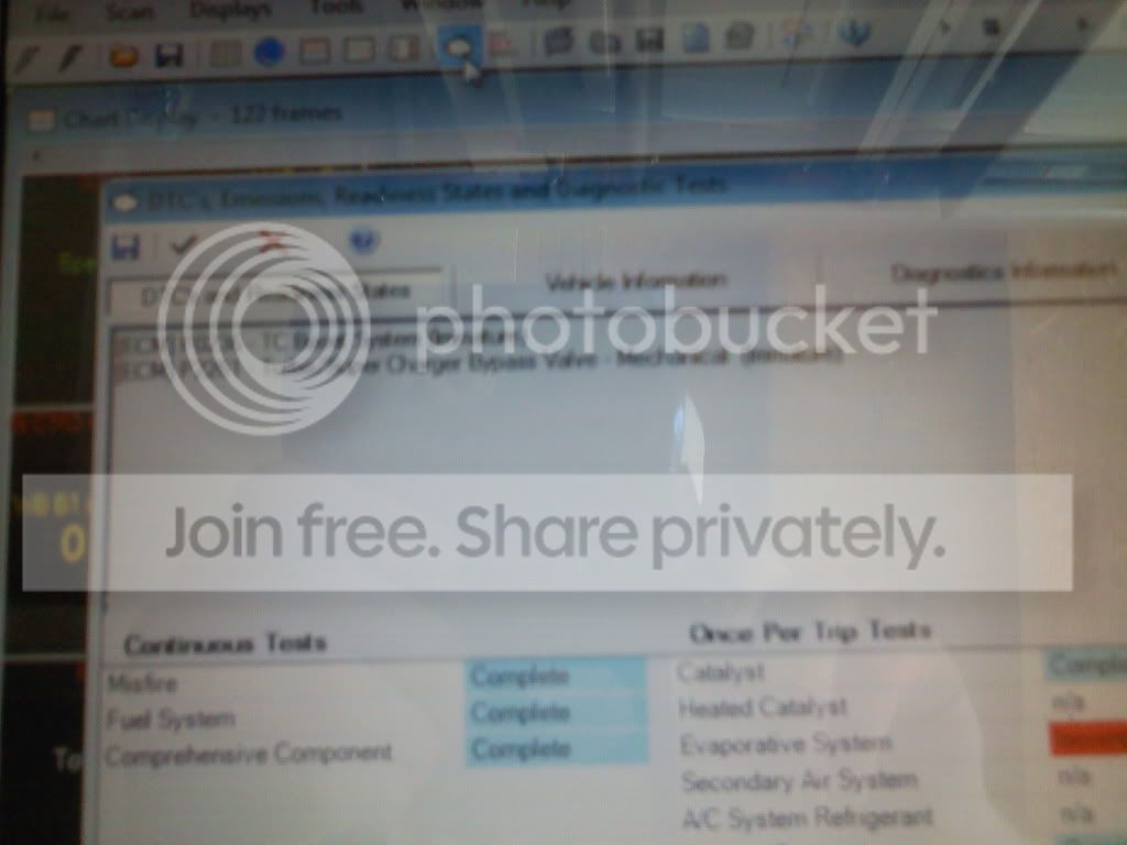

thank you for notifying me about your issue. a guy in Raleigh told me he soldered his and had no issues since. he said crimping them will possibly will cause the car go into limp mode. what kind of cold plugs are you running and where did you get yours at? I'm thinking about taking my stock ones out, I have a set of used Denso TT Platinum's been pregapped at .40 from the box just chilling. I think they should be at .32 or .35 where the factory ones are at.
Here is a pic of the error codes that 1badblueberrySC picked up from Raleigh with the HPTuners software. Sorry about phone pic.
here is a forum from saturn sky http://www.skyroadster.com/forums/f5/p0236-35516/ who have the same symptons and all have said to "soldered" and that was the cure to the issue. so I might just stop by the dealer and explained about the cause of the issue and they better not give me any **** about my Injen CP and ZZP 3" Catless being the issue to the problem, otherwise I will tell them what they can do with themselves with a 1000 death wishes.
