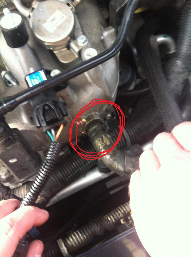

When you get into full boost does it hesitate at all to get back into it? Did you test for any leaks on the intake manifold?

Only reason why I said check the connectors is cause I was having a leak and I couldn't find it at all. Finally did a leak test and this little bugger was my cause. Did a test on my buddy's SS/TC and he was actually having a leak there too but barely noticed it.
Here was our verdicts. Don't know why either...

I will go check it right now...thanks man....

Well, it was really loose, so I tightened it, and then wrapped it with DEI fix tape, just like I did with all of the joints of the intercooler piping as well and checked the whole hose for damage and none was visible or to the touch.....
STILL IDLES BAD!!!!!
