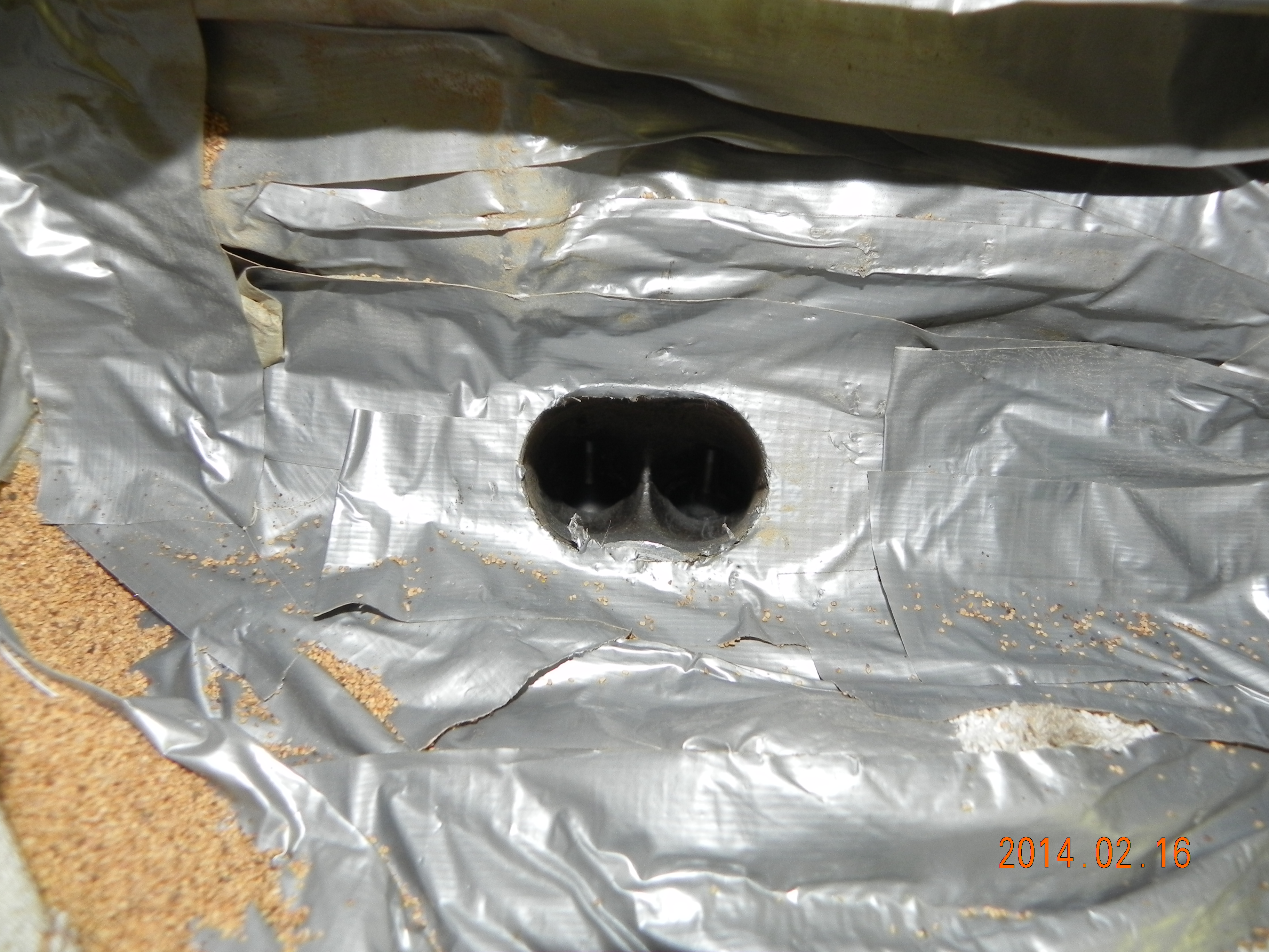

Duct tape a 5/16 line to your vacuum that helps with controlling the material coming out of the runner, the tool would cost more than it's worth just cover everything

^^ It doesnt really matter. By the time you spent all that time and money developing a tool you could have done a kazillion valve cleanings.
Use a lot of duct tape and towels to isolate the port and a vacuum. The blaster will fill the port up soon enough, without a vacuum and you need to do it carefully, It takes about 20 mins total per port so just over an hour. It takes another couple of hours to remove, prep and replace, along with clean up. Four hours if its a first time job. GM cleaner helps for touch up. New gasket and valve helps. Eliminating the valve and running all the blowby ports through the Mann Hummel seperator works great for me. Just costs more time and money to do it.

Labor plus materials. You have to get equipment specifically for it and you have a mess to clean up after, thats not included in John's 4h. And John has it down since he's done so many, most shops would take closer to 5-6h due to infrequent blastings.
