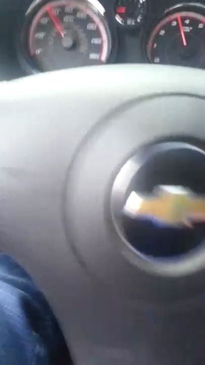

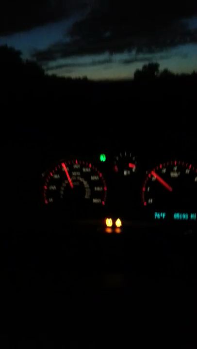

Sorry guys i dk, imma try new plugs and everything.. Here is a vid... May just need a retune.. and baby it until then

Try different gas and if it still knocks you'll have to send a log to Vince and he will pull out some timing. The tip in is somewhat normal, but I saw where the KR came in part way through the pull and that's real KR.

Read this^ It's most likely false knock because, from what I read, real knock would have made kr go up as rpm goes up. Never hurts to look into it though.
