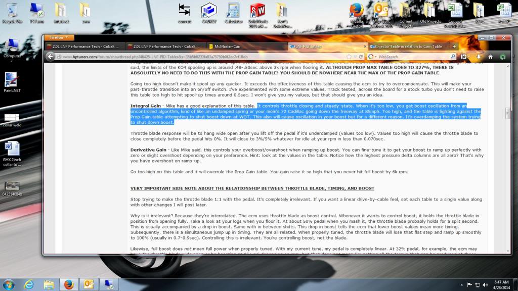

Actually a tune can cause this if you don't know how to tune the PID tables for boost, the ecu can be fighting the throttle plate and cause this. So yes, it can be the tune.

Originally Posted by OzzyruleZ
You guys using boost controllers or is it ECU controlled stuff? Just seems like this turbo is on the threshold for the surge line on the LNF.
ECU controlled, the throttle blade most likely isn't open enough for the amount of air the turbo is pushing like someone already said
