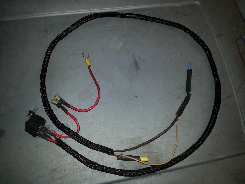

Car is basically driven daily unless something breaks and I have to fix it. Since install I haven't had to touch anything on the system. Get in it and drives just like normal. My own made fuel pump re-wire is holding and no signs of burning out. No leaks to report. Pump kicks on every single time you hit the key. I'm SSOOO happy at how the whole system as been performing.

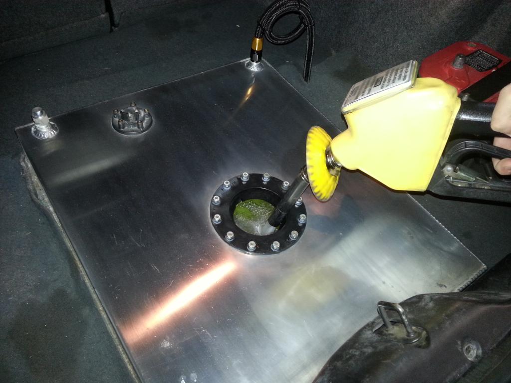

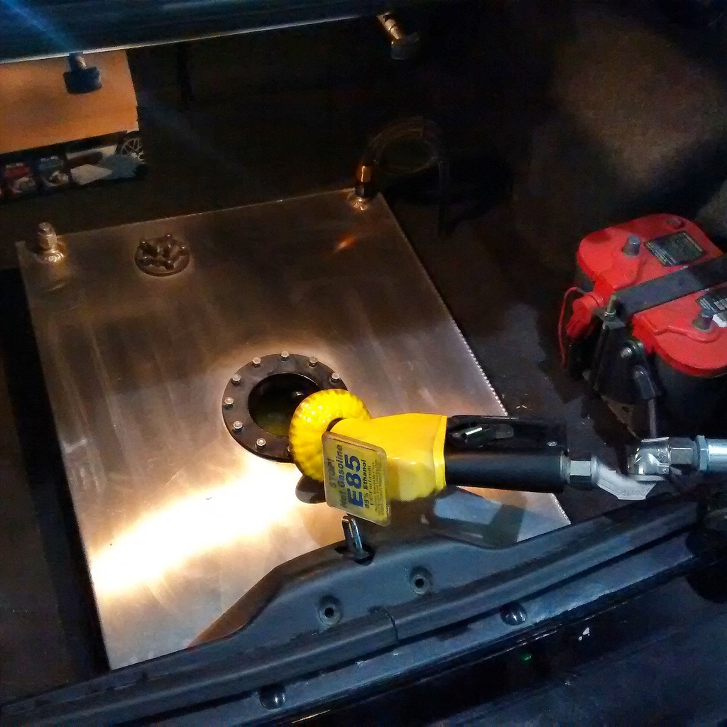

We have taken the car on a couple trips to check its reliability and fuel range and mpg's. Couple trips to Sierra Vista, Phoenix and have used it to do local paper deliveries for some extra cash. Not one problem. Tune still isn't dialed in. My fault. Just haven't bugged him. But low to mid 30's timing at cruise. 14.7 afr cruise doing 75-80 mph it gets 18-19.8 mpg's and a range of roughly 340-350 miles all on E85. We can fill it with roughly 18.5-19 gallons because of how I have it angled back for the sump. I fill up at 330 just because. I'm hoping once we dial the tune in more we can expect maybe 23-25 mpg's. If that is possible, we can have a range of roughly 425-450.

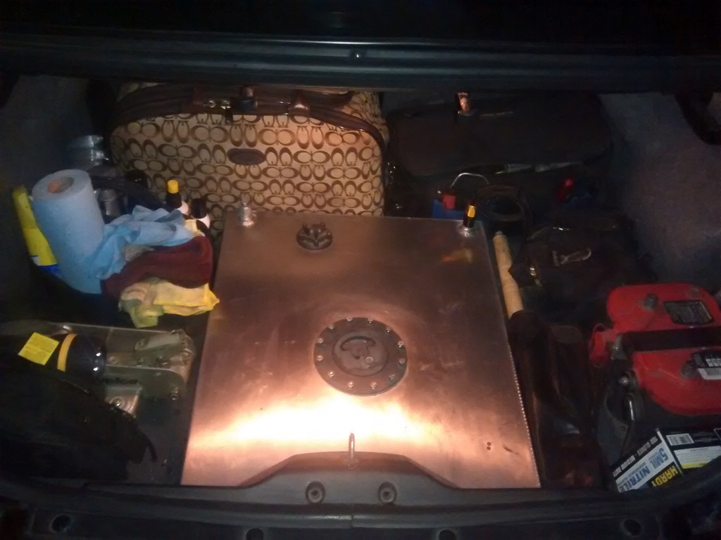

We just got back from a recent trip to Carlsbad, CA for a free trip the wife won and to visit friends up there. That was an awesome trip. 1000 plus miles round trip. 6-7 hrs one way of straight driving. Not a single issue again. Filled up here, then 170 miles out of town. From there made it to Cali on that tank with more fuel to ride around in. It's so nice to not have to worry about constant fill ups and the need to carry extra fuel around. I took extra tools with me on the trip because I did a stg kit install for our friend their and just in case any problems came up. Glad to say I didn't need them for us, except to re tighten our exhaust the came loose and melted the bumper a little haha. Still had lots of trunk space to after, bags, tools, jack, cleaning stuff, air pump, road side kit.

That was never the problem to begin with. It was the size of the wire and fuse holder that everyone was burning up from the standard kits you get from ZZp or OTTP.
3 locals plus myself all had one of those kits burn up at the fuse holder, then melt the rest of the kit because the fuse did not separate the circuit.
