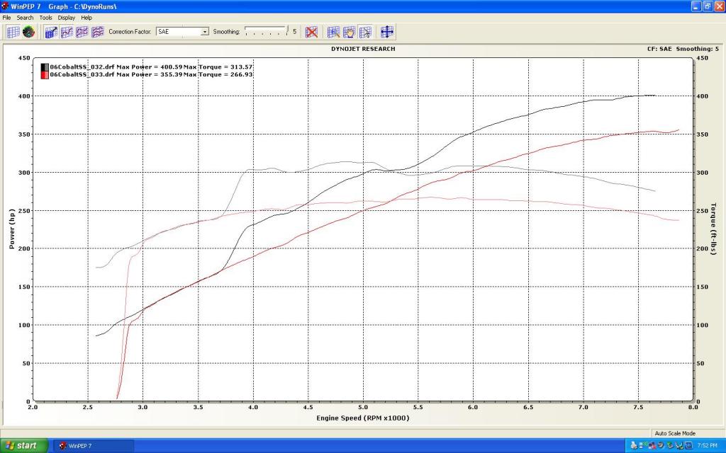

im running them in mine right now while i have the solids reground to kill some of the duration if you look at my graph you see the dips in the tq and hp line is where the lash adjusters are collasping tvs 2.8 50 shot
Not trying to argue, but I thought you didn't have the latest lifters, at least that was the impression you gave me in the other thread.
Side note, I imagine later exhaust cam timing would help them from collapsing, but I wonder if that would hurt performance worse than the lifters collapsing.

Originally Posted by mrbelvedere
i dident think i had them either untill i swapped the comps back in
One interesting note, at least to me, the dyno graph shows the dip but looks as if it recovers shortly after. I am judging this by the spread between the 2 runs. If that's the case, then how would a collapsed lifter recover? It shouldn't, and maybe all I am seeing is the power rising and it should be the amount it dips higher than it is from that 5200ishrpm point.

From: KY
they will to a point then recollapse thats where the second dip comes in but a hyd setup would be good for most people

Wow you can really tell when the nitrous comes on haha
I don't think that's lifters collapsing. I would try closing the plug gap or adding some dwell. It could also be fuel related but I don't know how your nitrous is setup.

From: KY
the gap is .026 and adding dwell dident make a difference
