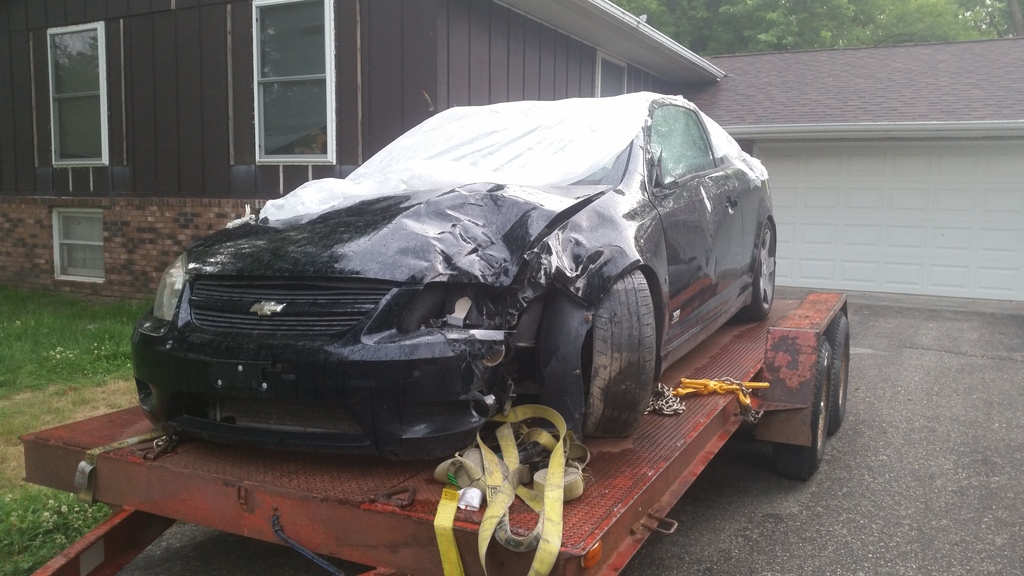

Here is the donor car a 2006 SS that was rolled

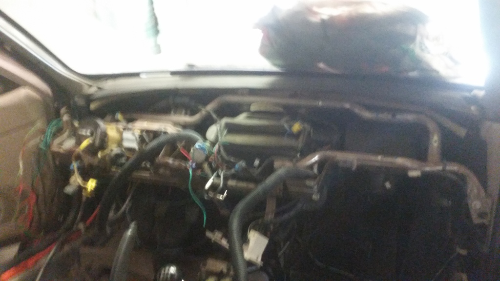

Harness 80% ran in cavalier some minor things to figure out

Still have a few things that need to be figured out. I have to figure out what to do about starting the car. What things in the harness can be eliminated, I need to find a intake manifold to use the stock lsj throttle body. and Im sure some other things I haven't thought of yet. The car is not a daily driver it will see little road and a lot of track time.

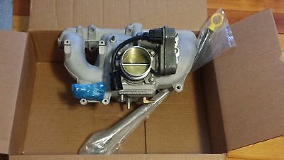

Here are a couple parts that have shown up the last couple days
Just waiting on the BSD bushings to show up they just shipped today, once they are in the motor will get buttoned up and dropped in. After that start hooking everything up and get the trans in place. Still have some parts I know I need to purchase, I need to do something for an intake manifold, injectors, and also have to figure out MAF sensor location and get the tubing for it.

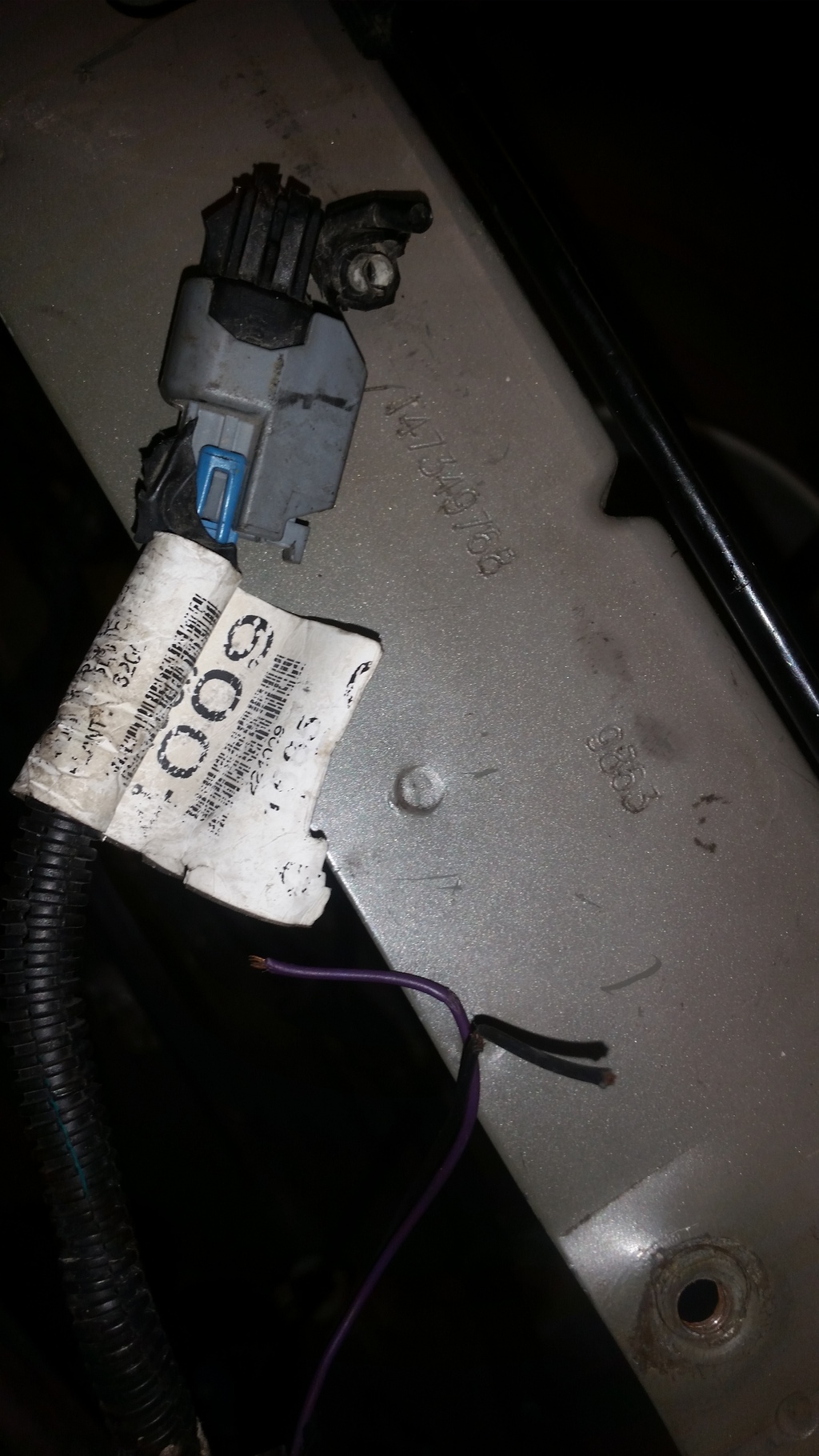

and does anyone know what these to wires and connector are for it was destroyed in the wreck
Old Sep 1, 2015 | 06:32 PM
I don't believe you can just block off the oil cooler. Mr. B or someone who knows for sure should chime in
Old Sep 1, 2015 | 06:35 PM
rousseaus99's Avatar
Joined: 07-18-15
Posts: 64
From: Iowa
I pulled out the sleeve in the rear hole. I thought that was all that needed to be done if someone could chime in for sure that would be great

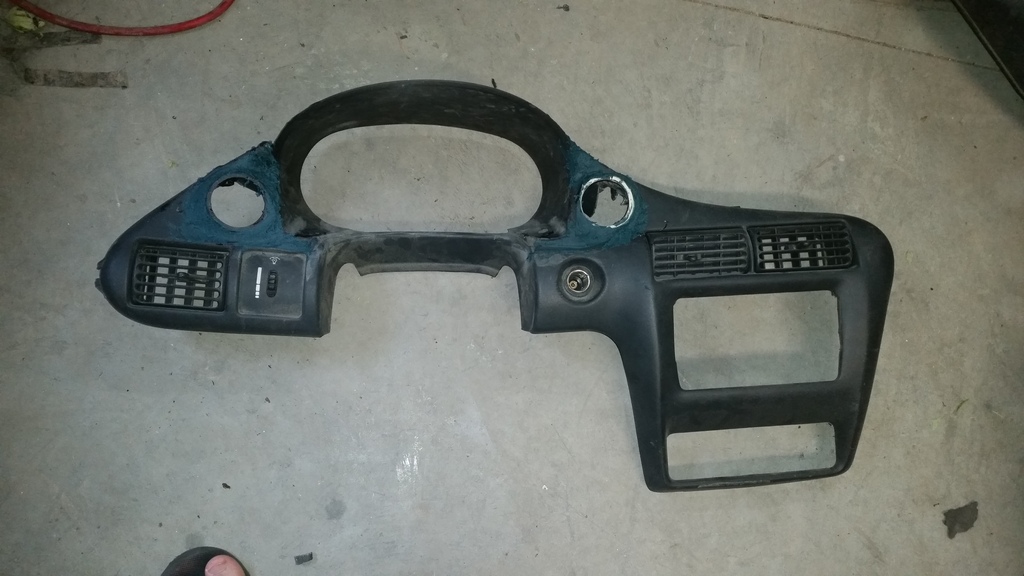

Finally have had a chance to get some work done on the car. I have been so busy lately with customer cars and life in general. Progress on the car will be slowing down a littlw just watching my cash flow with just having purchased my wife a new car. (2015 ford fusion ecoboost) which will be modded when the warrenty is up. But in the meantime here is a shot of the progress in the past couple days. My only thing im not sure of is what to do in place of the vents. There is no heating or cooling in the car anyone have some good ideas?
Yes its twisted a little moved when bonding but will correct it when im done.
