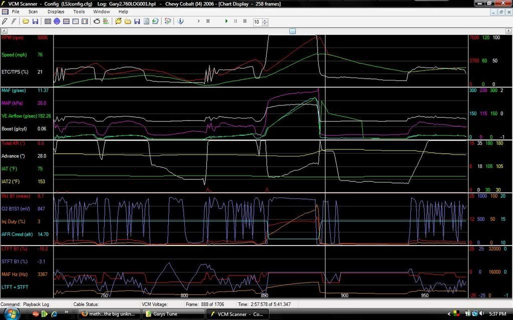

From: Raleigh, NC
Car: 2007 Cobalt SS/SC
Mods: 2.7, vibrant header/dp, Megan Catback, CXR H/E, and my tune!
POST WOT RUN!

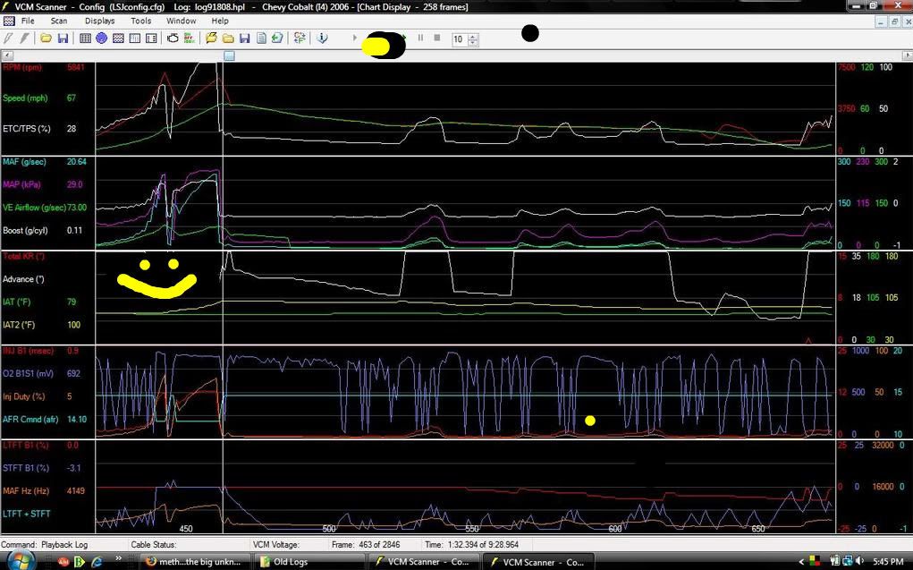

My car: 2006 Cobalt SS/SC
Mods: 2.7, GMPP header, ZZP Downpipe, meth with 5gph nozzle, Cobra H/E, and my tune!
POST WOT RUN!
POST WOT RUN!
[IMG]http://i151.photobucket.com/albums/s149/mdub25200/matt27log.jpg[IMG]
You dirty bastard Matt lol. Your IAT2's > me lol

Tom I am well aware of that... I was just stating that it STILL produces alot of heat! Either way it's needed!
What Can I Say... My Car Is A Freak!
And Zoooomer I was mistaken it's 53* difference!

On the engine dyno, we lowered IAT approx 50 deg on an engine making ~250HP and with no other changes picked up 4HP. This was done with an intercooler so lower IATs can increase HP on thier own slightly. When we dropped 140 deg we picked up 16HP. Now this doesn't apply here because we're losing power from water being injected at the same time and density is affected by the airs humidity. So my point is only to illustrate the potential gains from a cooler charge (with no other changes or fluids added to the engine)
Blueberry, I appreciate the graphs but what would help is if you could put your collection bar at the same RPM on both logs so that the RPM on the left side matched up. Preferably close to redline and at 100% TPS. Then we can compare numbers directly.

holy hell m i cant wait for my meth after looking at that log...
