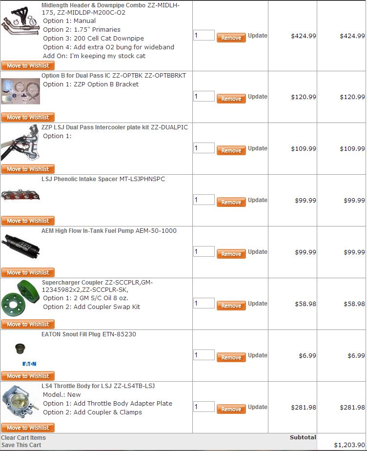

Hi guys,
I'm about to pull the trigger on a big ZZP order for my 06' LSJ. I based this order on research I've done to max out the M62's potential. This being said, I've put everything in this order I believe I need except for:
  • HP Tuners VCM
  • Wideband Guage (I'm total newb here, please recommend solutions)
So, please comment on what I hope are the final parts I need to round out my M62 LSJ build (keeping in mind I run a 2.8" on 60#'s already):
Thank you very much for your advice!
PS: Does ZZP give discounts on orders over $1,000?
PPS: I need a new fuel pump, hence, the pump.

A lot of people like the AEM UEGO, but I went with a PLX because it has a brain box that can be connected to HPTuners.
AEM UEGO connects to HPTuners as well for data logging

Save $100 and skip the intake manifold spacer.
It's not needed, and usually ends up causing a leak.

you do not need the fuel pump or the coupler or the plug or the spacer
your not going to max out the m62 potential with just bolt on **** if you want to do that step up to the plate and port the head resleeve the block run a set of 11to1 pistons a good set of rods and cams and valve springs an ati dampener find a great tuner and run some spray
This ^

Snout plug is reusable when servicing the coupler. M62 only holds 4oz of oil.

Also don't bother with the LS4 TB.

And that zzp header had a 2 bolt flange from header/dp that has a tendency to leak
I would not sat that
This. minus sleeving the block & spray would be a nice setup.
no need to sleeve a block or run spray to run a good daily 300whp m62 setup.
all i see in that list is more waste of $$ than gains.
there is a need if the bores are not round then things do not seal up and nitrous is the cheapest hp available and when tuned accordingly makes for a very fast and reliable setup

take the throttle body off. i ran one on the m62 and it wasnt bad but you can pick one up on here used for 80$

their mid length header kit sucks, i regretted buying it the day i received it. Id recommend the stainless steel ebay longtubes.
