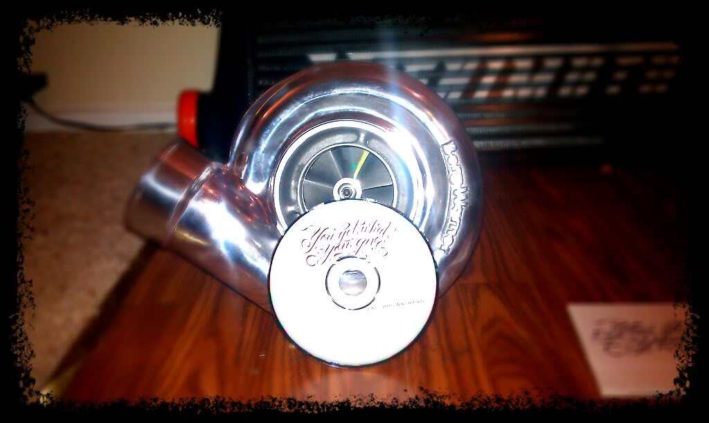

what in the hell do you need 160lb/hr injectors on pump gas for
for this:
back before god blessed you all with e85, ppl were using big injectors and pump gas, Ive known several DSMs and Evos back in the early 2000s running 1200cc + injectors with 105 and making 650+awhp.

exactly, so what do you need 1,680cc of injector for on pump gas
Old Dec 5, 2013 | 07:13 AM
  #7155
armcclure's Avatar
Joined: 01-10-11
Posts: 3,881
So that he (most likely) doesn't have to worry about them ever again.
