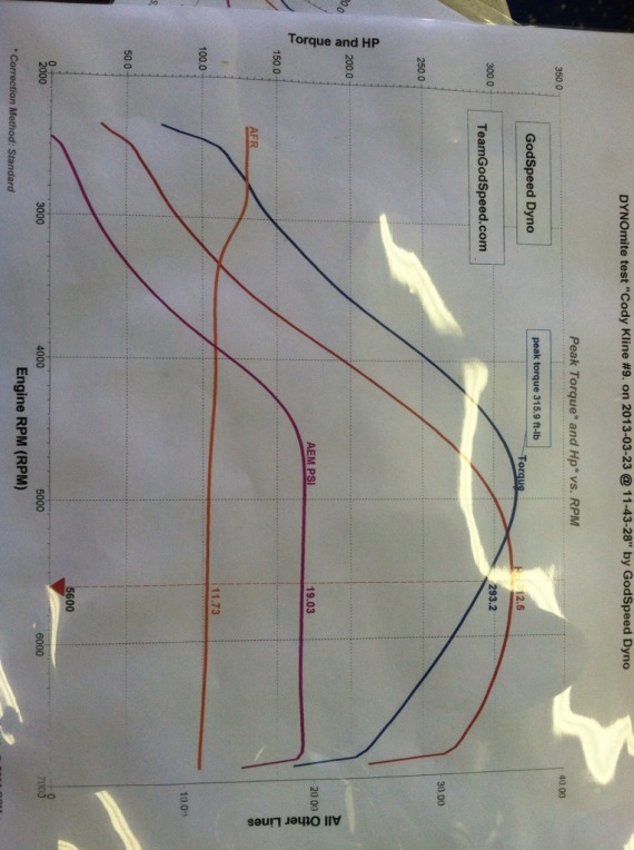

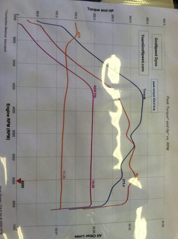

dynoed... kinda disappointed

boost leaks out the ass. wouldnt hold past 19 psi. low timing. and bad gas caused KR..

312 hp? is that what it says? there's too much light over that area. How much psi were you pushing? I'm assuming about 19 since that's what one of your graphs say? And that sounds about right for sub-20psi.

yea 19 psi... going to fix boost leaks and relog. and hit the dyno in 2 weeks. man i dont have the money or i would.

shouldnt be. That was on a dynomite dyno. The same one that I used. They are very accurate and read low. At 15 psi on the 20g I did 338hp for comparison. If you had kept spooling, you would have been right were I was at about 4500 and held all the way to redline. The more I see dyno graphs the more I see the 20g (on E) is a very good turbo respectively.

were you on 93? That is respectable my friend.

93 with some KR .. and yes i have one. yea the more i look at it the more i understand it. overall im happy with how it turned out. its on retarded low timing and lower compression to.
