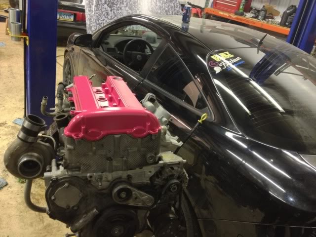

Old Mar 24, 2013 | 11:36 AM
  #4692
nwss's Avatar
Joined: 03-26-11
Posts: 2,715
From: sidney mt
Sti pink!
