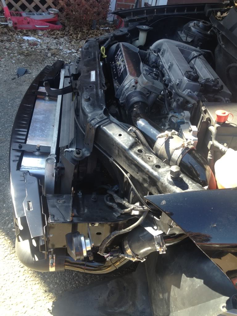

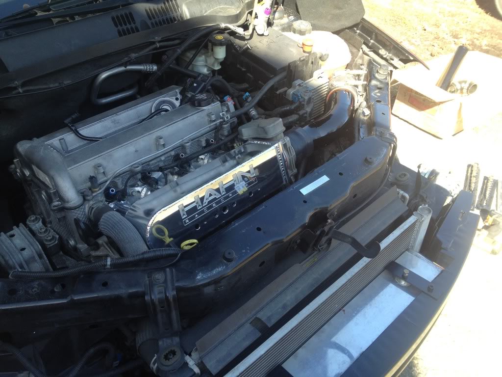

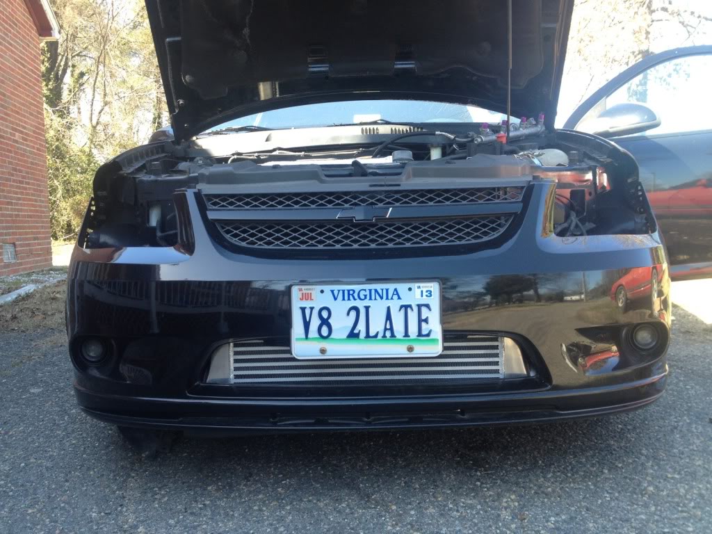

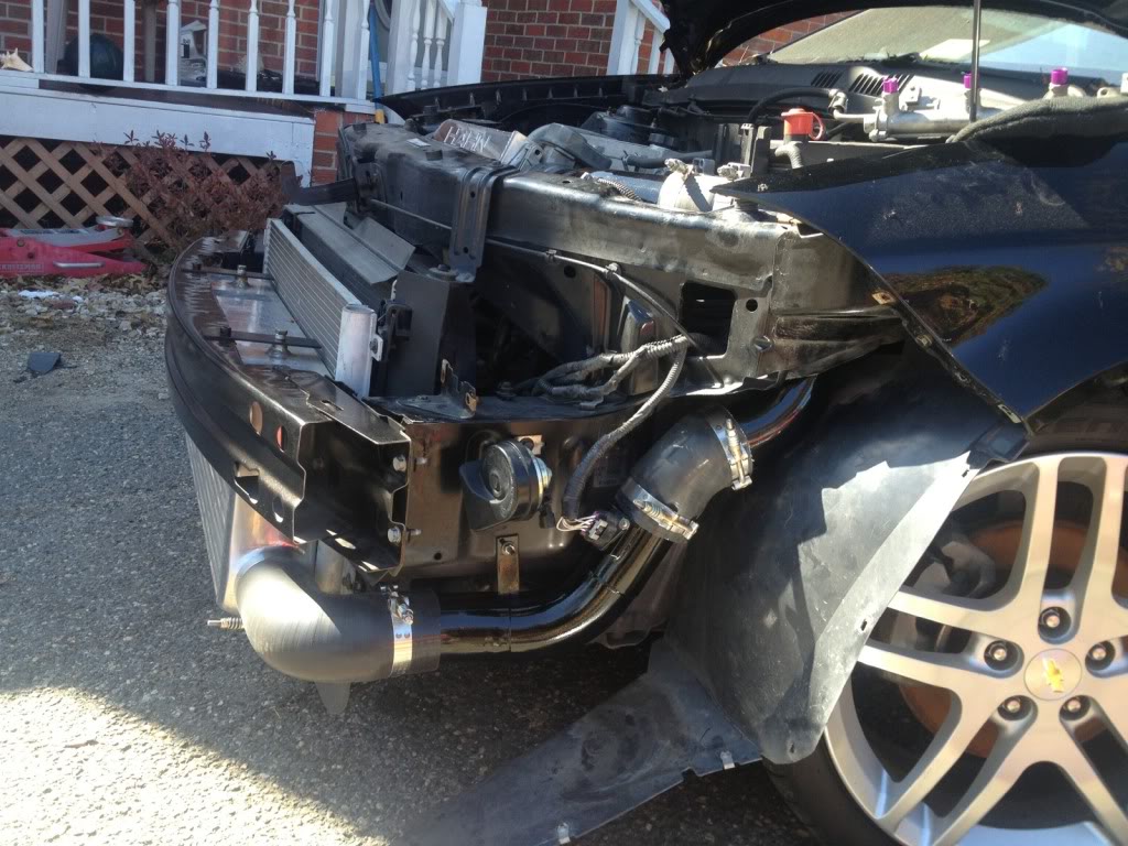

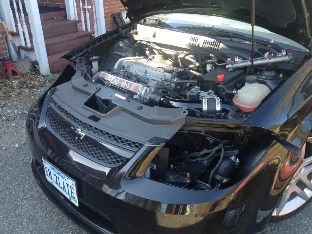

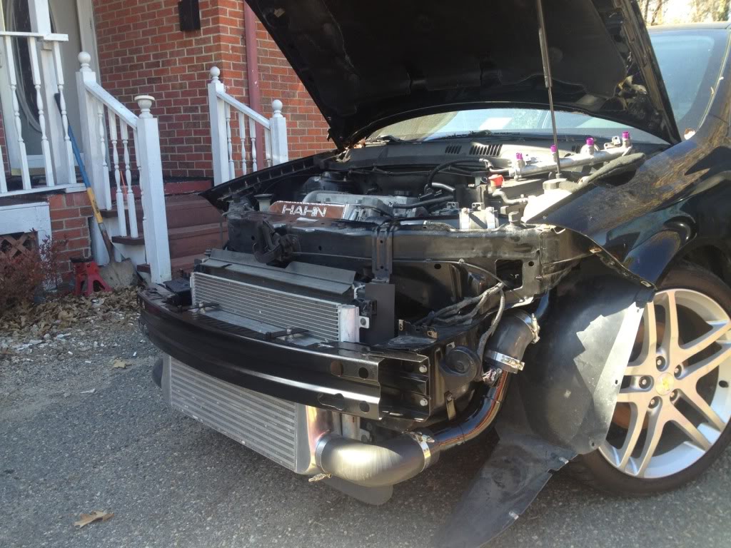

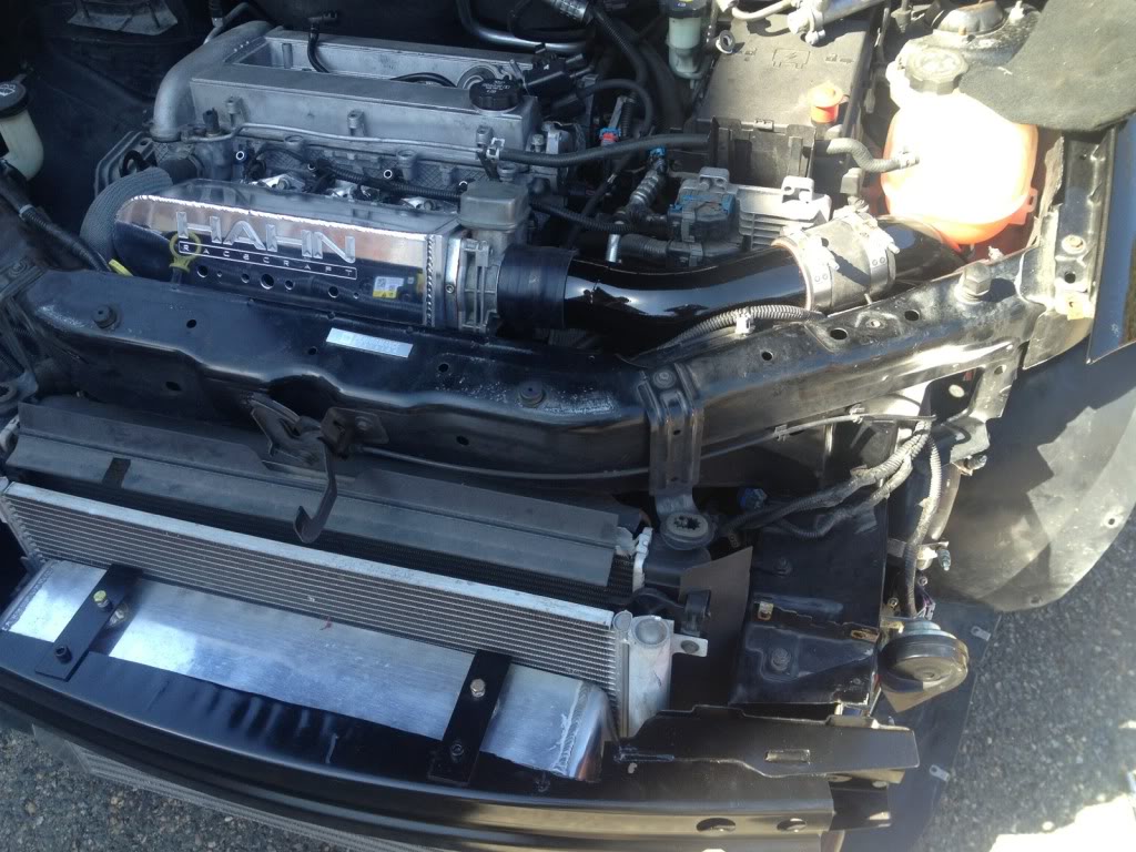

started putting her together today. Got the front mount on and crash bar modified, cold side all done and ran. Manifold bolted up, hot side ran, retimed my motor and installed my stock cams back in the car. Also removed all the oem idler components to do the lnf alternator and tensioner assembly with belt. Would have got alot further but timing her up took a little bit and its ******* freezing out lol. Tomorrow she should be all done. Although i got a -10an weld in bung from treadstone for my oil pan that came today and the return line ryan was running is smaller. Ill have to get another bung and need a new map sensor since i had to break my mounting tab off when running the tvs

sick man, hahns piping is by far the best look for our cars, keeps it so sleeper. LOVE!

yea man clean oem look. Do a pressure test first if that checks out ok replace waste gate

i have the hahn turbo pipes, MAF is behind driver light before TB after intercooler. need a pic? look at the last pic of zrated's car.
