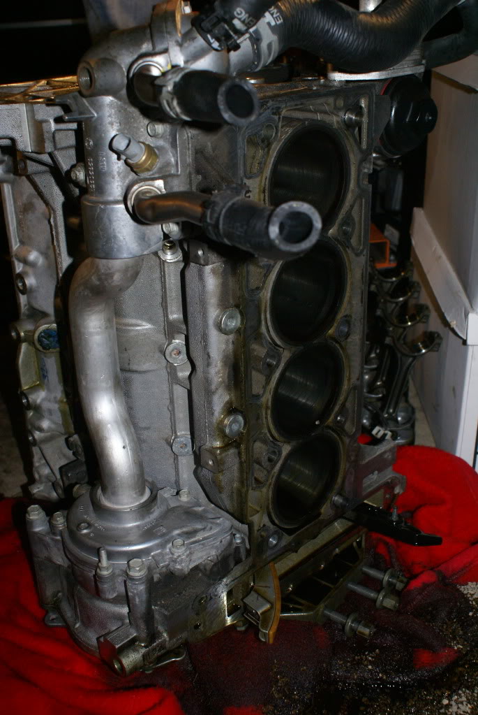

Where does the oil feed line connect to the block?
Old Mar 2, 2013 | 09:55 PM
  #4387
USMCFieldMP's Avatar
Rattlesnake Race Shop
Joined: 06-08-06
Posts: 15,725
Likes: 410
From: Fort Worth, TX
The best source to use is one of the Oil Galley plugs on the back of the block behind the Coolant pipe... notice the missing plug/hole.

From: Calgary,Alberta
ah okay. I was thinking that was a good place but was unsure. Thanks man!

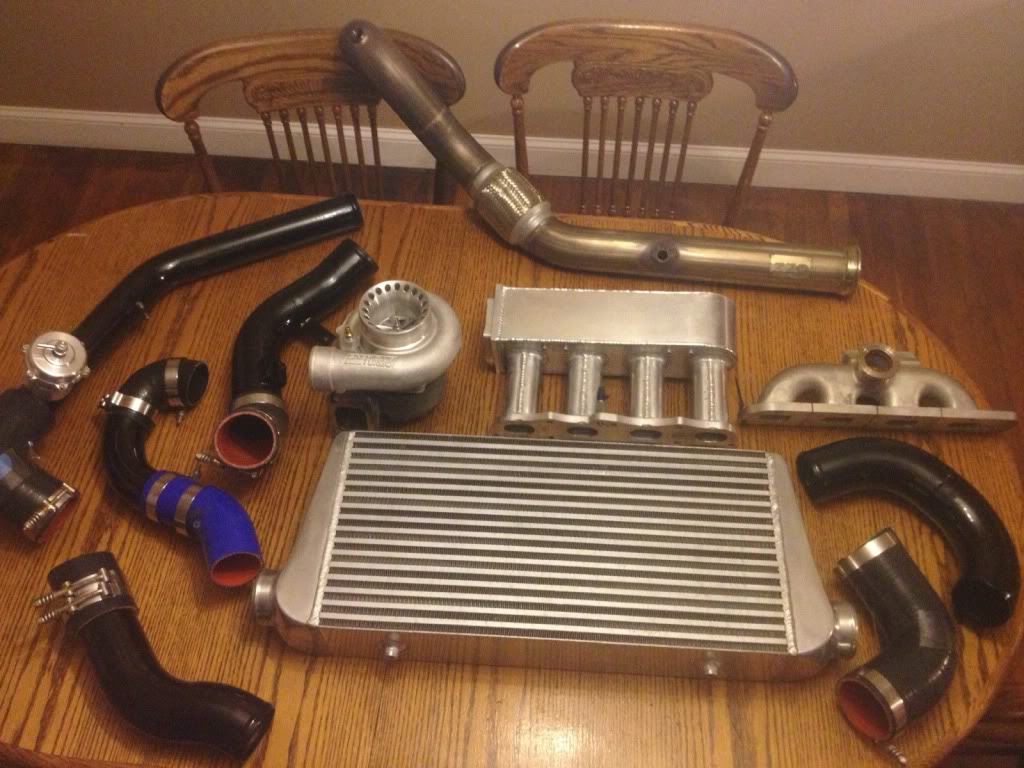

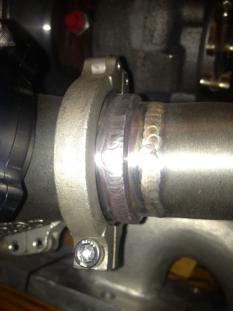

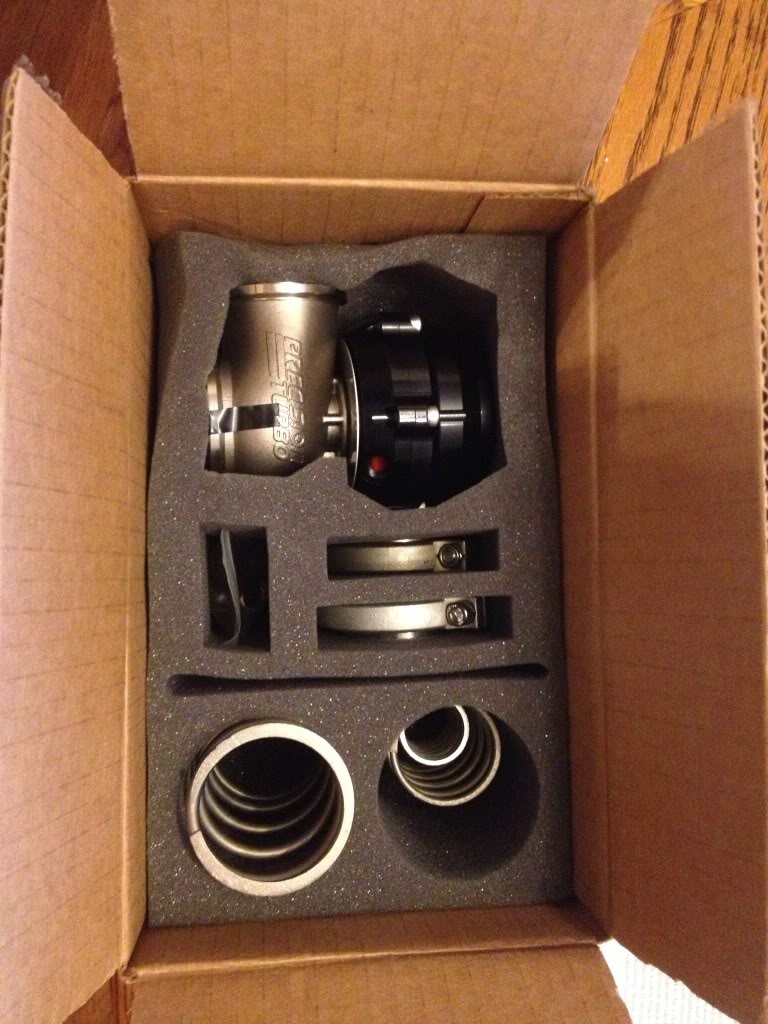

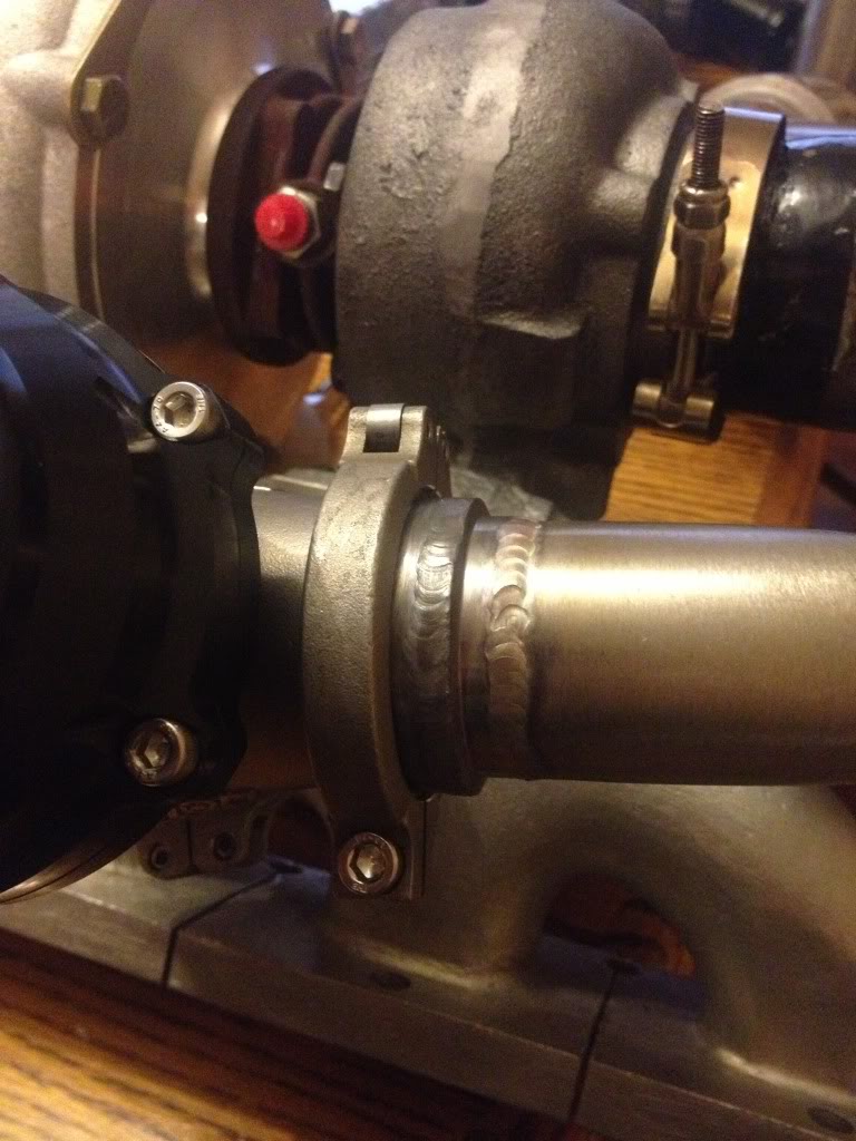

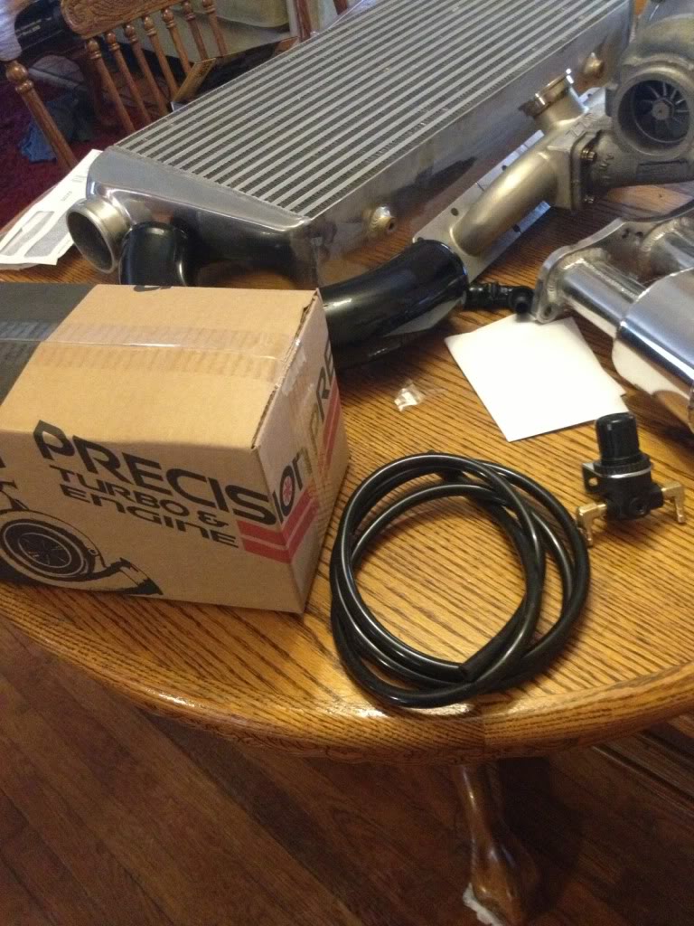

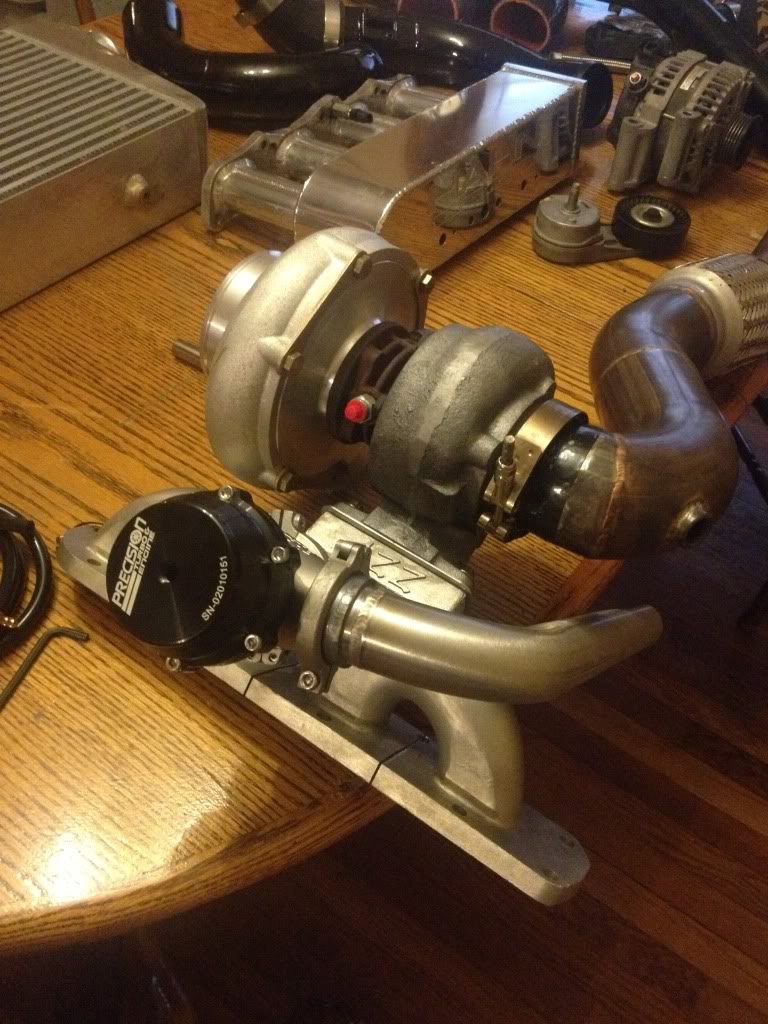

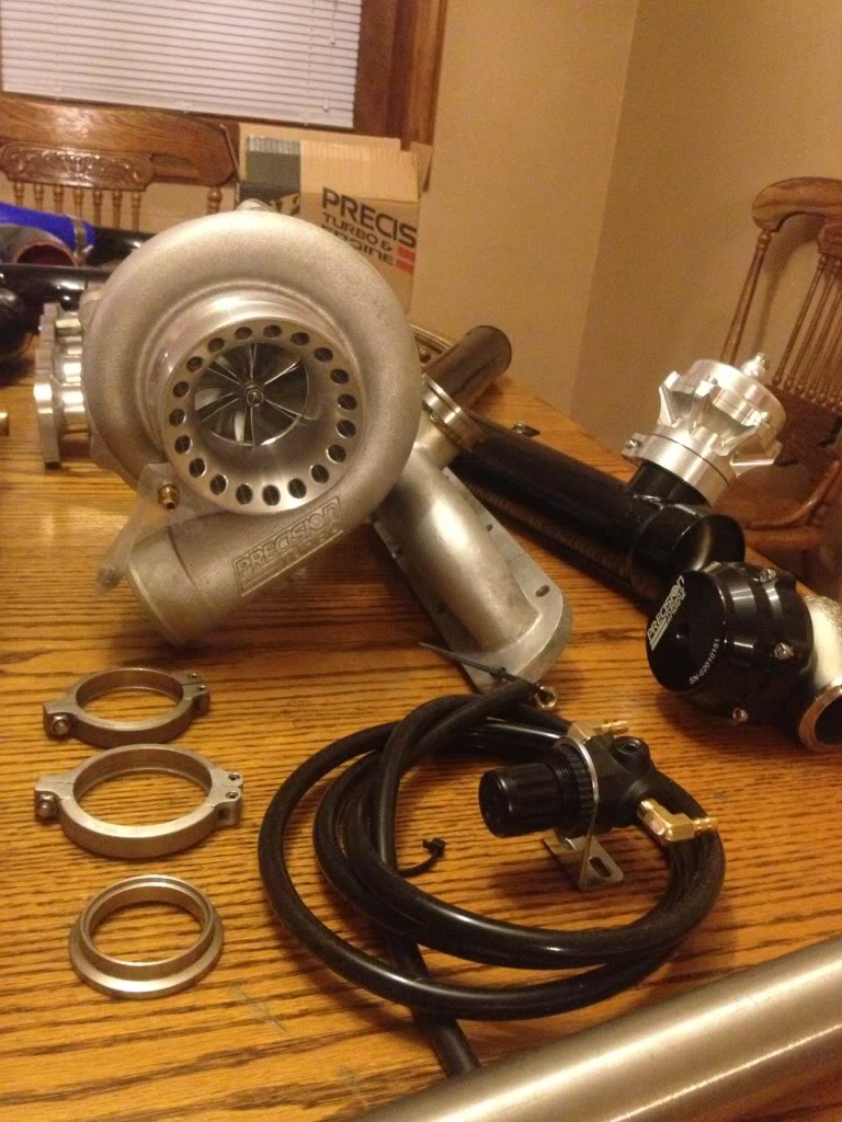

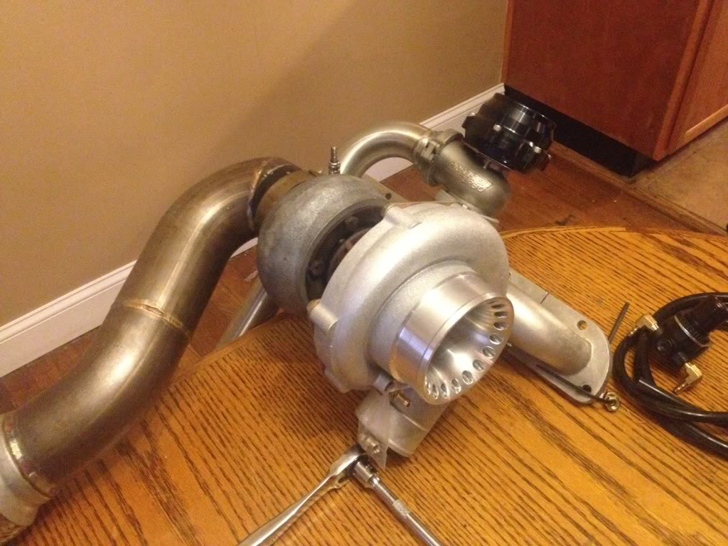

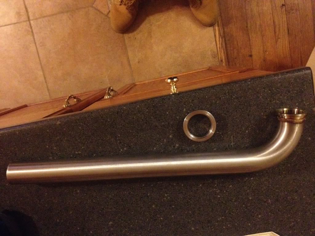

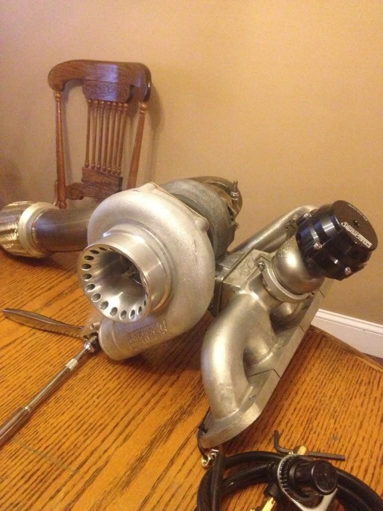

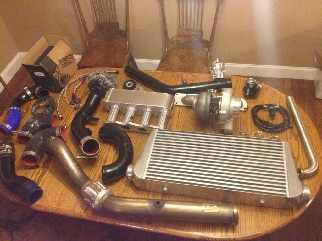

some pics had to modify the dump tube and tig weld the 46mm flange on it for the waste gate. Pays to have fabrication buddies will start going on this week.
need to get another map sensor since i broke my tab to use on the tvs, also need to get the male end fitting to connect the feed line to the turbo housing. bung for oil pan will be here monday from treadstone, and ill be in business (haha after looking at this pic i realized the fitting is attached to the turbo in the baggy lmao)

thats the 6262 right? Man that thing is going to be awesome.
yea man shes gonna rip
