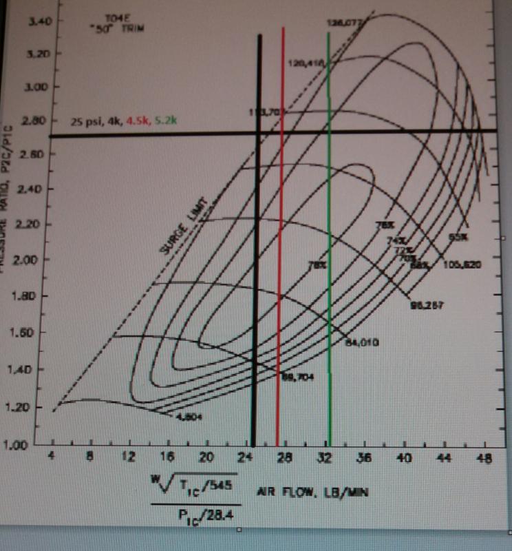

So looks like I still get some compressor surge under like 5k in 3rd gear. Needle stutters a bit after 20 psi. Then after 5k its perfectly still at 25.
Im guessing the engine just can't take that flow rate when low rpm isn't demanding the air. According to hp we hit 47.6 lb/min at full boost

Doesn't quite work like that. Look into reading a compressor map. Typically with non-name brand turbos the compressor wheel is such that it moves the surge line to the right.

I have replaced internals with garrett parts as well.
So you don't think it has anything to do with forcing 47lb/min at 4k rpm? The lsj stock head can take that?
Also, since the turbo has been rebuilt, its only the housings that are no name. Would an anti surge housing help

seeing the jagged curves as it surges in HP logs makes me belive that under 5k it is surging in 3rd.
maf and map are going crazy. then smooth out.
injector duty cycle also goes up

Just read the compressor map for this turbo. The math checks out, in surge territory until 5200 rpm ughhh
So I'll just stay away from 4k in 3rd gearr
