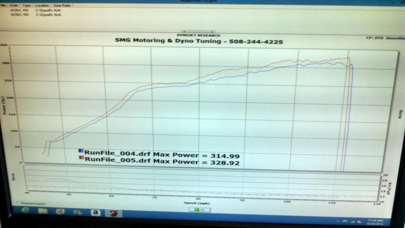

finally dyno.... turned the boost down, about 16 psi ran 328.9 hp and 110 degree iat2 temp

next goal is to get those iats down. iat1 is good. iat2 is bad because i used the stock lsj manifold and i deleted the heat exchanger system. working on created my own system and use the stock endplate.
so ill have both air to air and liquid system.
I used a random heater core for the heat exchanger and made a filler neck. I just need a pump now. Just the stagnant water and the heater core have dropped city iat2s from 150 or so to 90-105.

That's a good starting point! Shoulda turned it up a little on the dyno!

i was running 25 psi and my clutch slipped every time it spooled up. I could either fork over a bunch of money for a 350 ft/lbs + clutch setup or try to get some more use out of this one.
I don't have much cash so I went the easy route. its not as fast but it still pulls very nicely.

110 isn't bad at all bud.

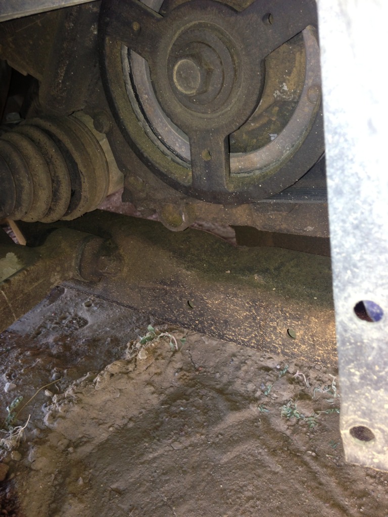

What serpentine belt do I get? I bought the zzp alternator kit off a local guy here and I think the belt is to short. Because it cracked my crank pulley.
