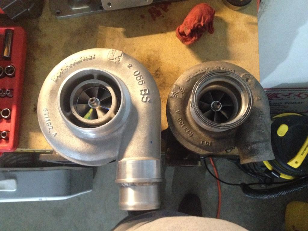

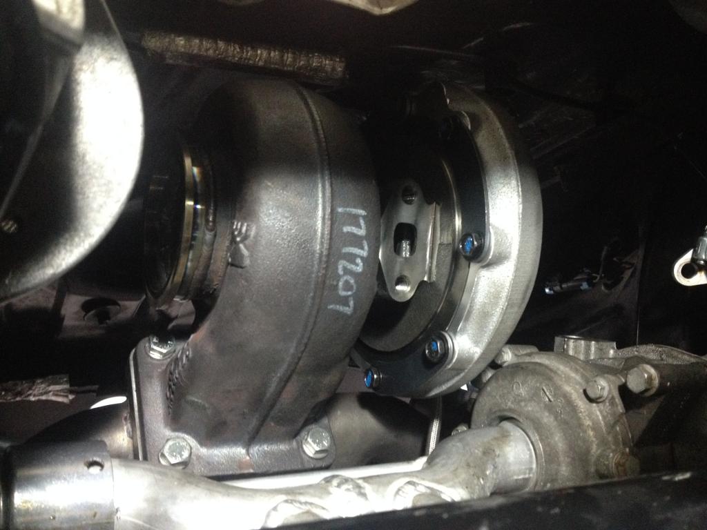

Well I finally got the s360 in the car. Felt pretty proud of myself for measuring every thing out and modifying the manifold perfectly. Just under 1/8" clearance to the firewall, but with powell's race mounts that's not an issue.
Here she is next to the s256 I pulled out:

And here she is crammed up in place. Had to un bolt the steering rack to get it up there, and even then it was like solving a rubric's cube.

All things considered I'd say she's doing pretty well. A little laggy obviously, but that will change soon
On a 15# spring, it pulls like the 256 did on 24-25 psi.

Did the compressor come like that or did you have the reducer welded on the outlet neck? I just wondered because you can get a silicon reducer for virtually any size and welding costs money. The video sounds extremely smooth so your tune is pretty decent. Looks like it pulls very hard up top.
I welded the "reducer" on. The cover outlet is actually very thick; the ID of the 2.5" pipe actually matches the ID of the cover outlet. I did that so it would match up to my one piece charge pipe I had already made for my holset.
I am a machinist/fab/welder so it didn't really cost me more than a few cents
Originally Posted by mrbelvedere
most of it is in the tune
Thanks
It really is. Look at infra an several others that have ran them hard. Things are a lot different than when these cars first came out and people were blowing #4 on cars just over 300whp.

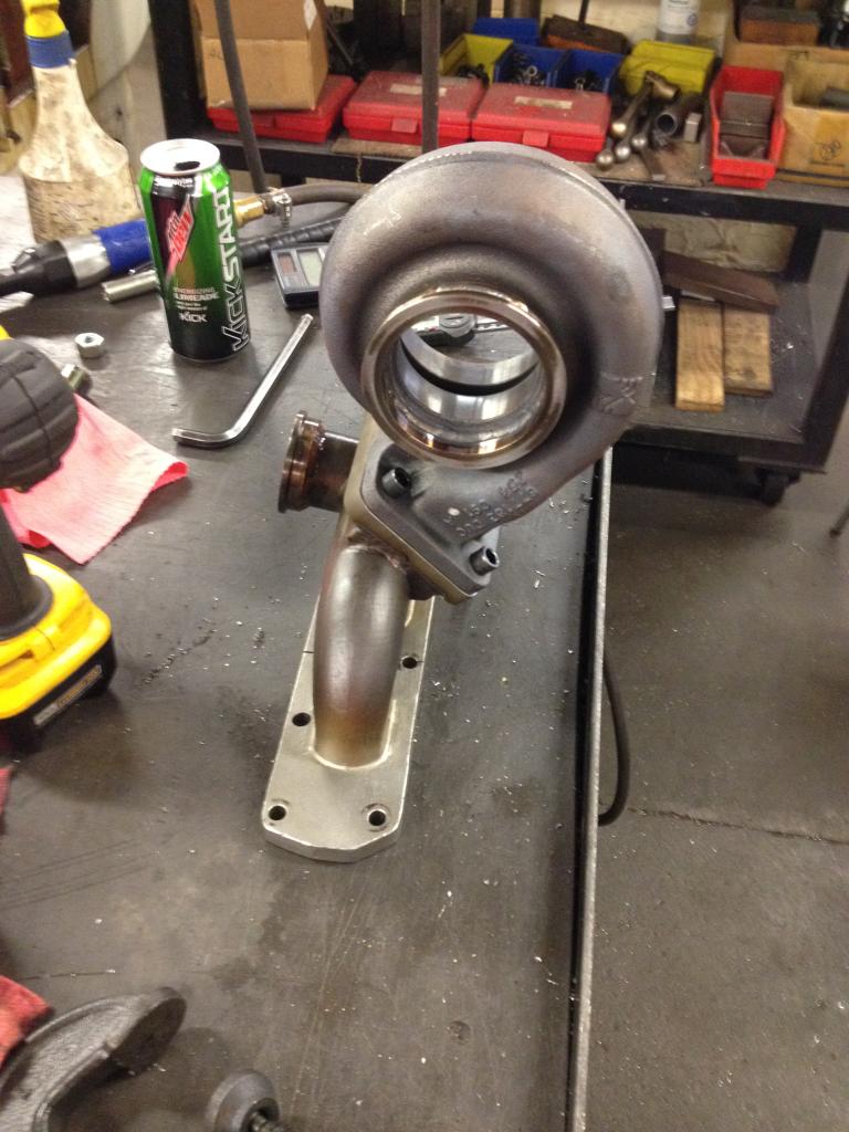

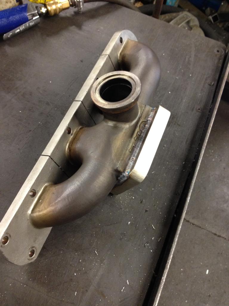

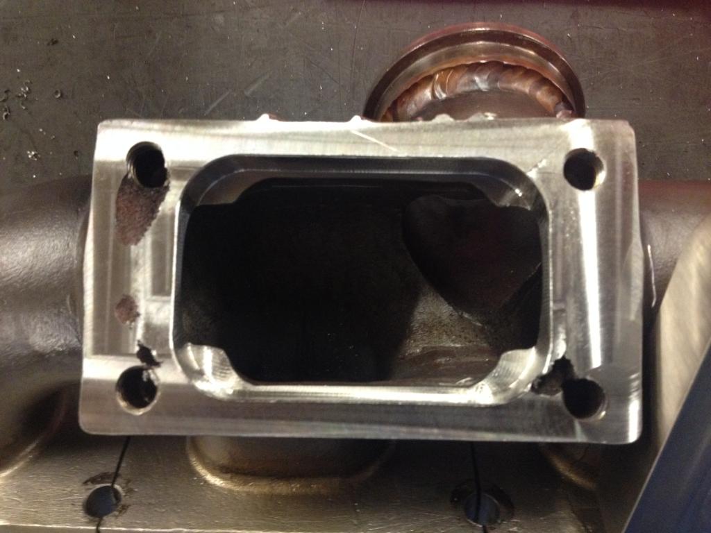

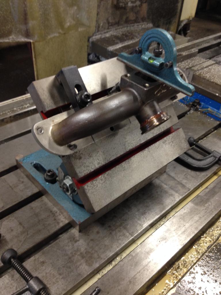

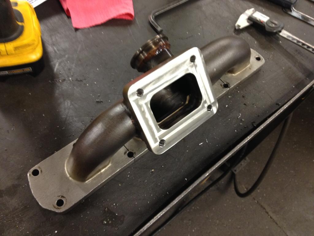

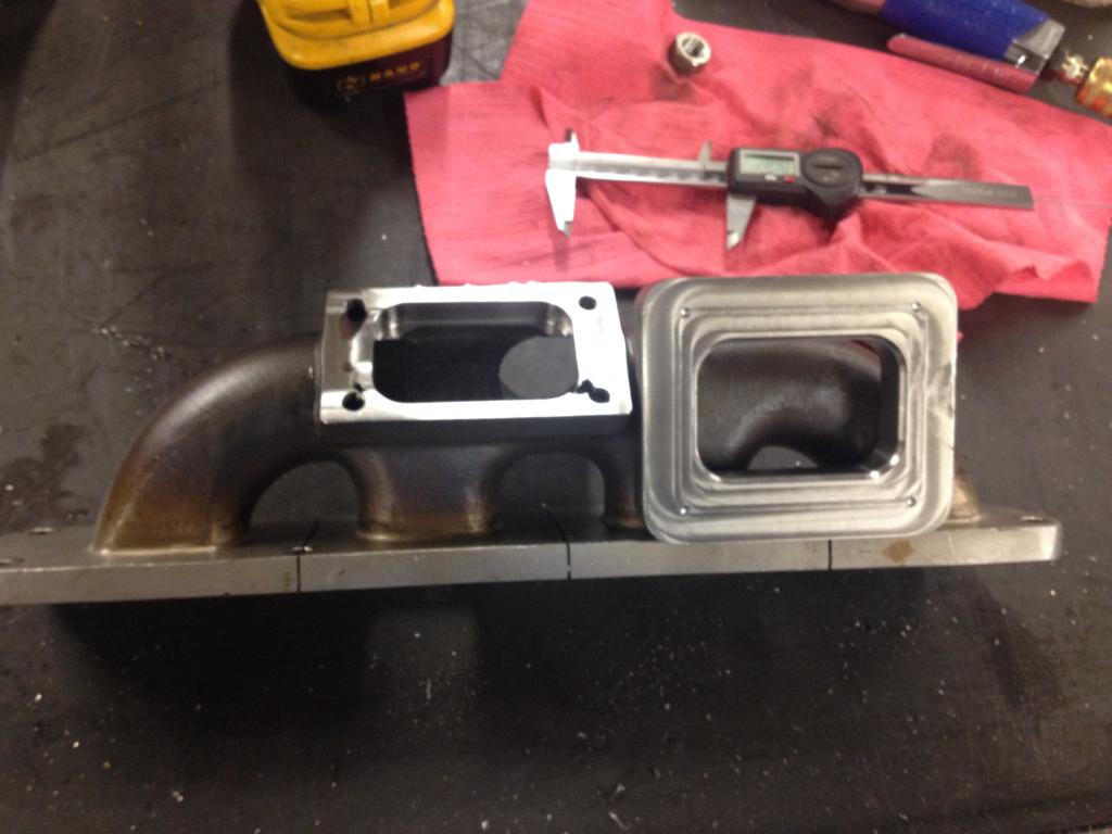

Here's some pics of the process for those interested. I was surprised by the casting voids in the zzp mani.

From: Plano, TX
That's awesome! Could this work with a efr or are they generally twin scrolled?
Edit: screw the efrs, these turbos are cheap
Old Oct 3, 2014 | 07:50 PM
  #8350
armcclure's Avatar
Joined: 01-10-11
Posts: 3,881
Mine is a twin scroll .92
It works just fine
