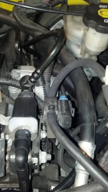

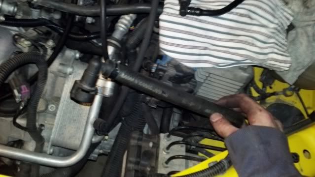

All the guy that swapped with the ZZP kit i have some questions. What did you use for the throttle body gasket i didn't receive one?
Also do we use these two things in the pictures i'm posting and if we do where do they hook up at thanks, finishing this tomorrow so i'd like to know
Old Mar 31, 2012 | 10:59 PM

You just use silicone to make the gasket. First thing next to the evap solenoid is the supercharger boost control. You can remove that because it is not needed. The second thing is the brake booster which the saab manifold has a hook up for.

You def have to hook up the second one or stopping would be a huge problem. The first can be removed as Blazin has already stated.
