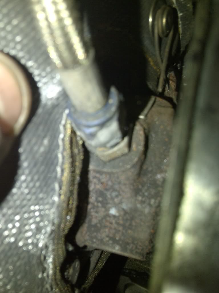

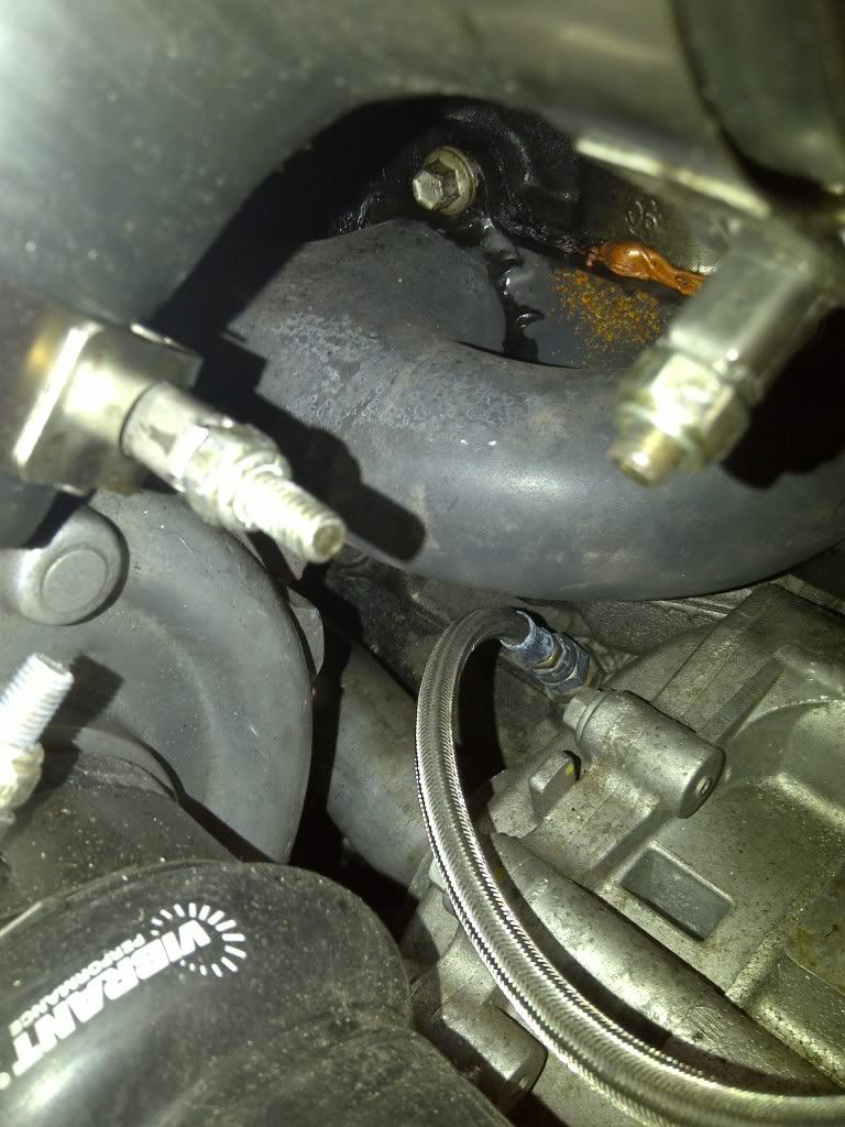

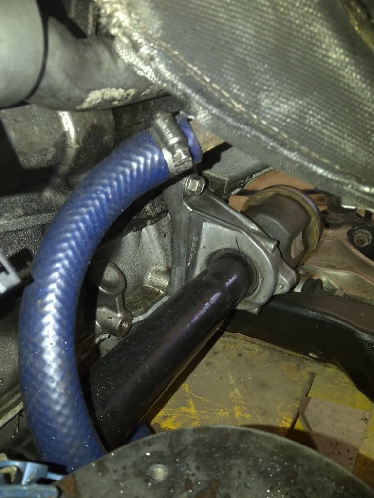

I've got some questions, I thought I had my problem diagnosed with a compression test and a valve seal replacement. I noticed when pressurizing each cylinder that air was going past the rings and coming up through the crankcase vents in the head.. I wondered if it was just because of the pressure (100psi) that it did this, but everything at that point was pointing towards blown rings.
So we finished installing the valve springs and valve seals and put everything back together in hopes that it was valve seals. But after the test drive I was still pumping out a ton of smoke from the tailpipe.
So there's a couple things i've been able to determine with some checks:
1) All spark plugs are wet with either oil, gas or a mixture of both
2) All pistons are black on the top (used a flashlight and looked inside)
3) Smoke from tailpipe is mostly oil, but is sometimes gas at startup because my idle tune hasn't been finalized yet.
4) There's oil in the intake manifold and boost pipes, not a ton though, pipes are just wet
5) There's also oil on the intake cold side of the turbo (without a PVC return line hooked up to the intake pipe), this one stumps me............ Makes me think that oils getting by the turbo seals..
6) Before I had my tune I had a similar problem and it was related to my oil drain being too small.. Oil was getting past the turbo seals and going into the engine because it had no where else to squeeze through under pressure. Im wondering if this problem was ever fully fixed, im going to be checking if my oil drain is plugged tonight or tomorrow morning.
7)Lastly the turbo is a GT3071R that was used when I bought it.
So the questions are;
a. Do you think its bottom end or should I try rebuilding the turbo or purchasing a zzp S256?
b. Whats the purpose of an extended tip turbo, what difference does it make?
c. If you don't think its the turbo what would you suggest for bottom end upgrades?
So basically i'm looking for some help pretty quickly so I can get this beast on the road and achieve my end goals of 400hp...
Attached are some pics below of what I've found:

What are you doing for crankcase ventilation?
What size is your oil feed/restrictor?
Did you rebuild the turbo after receiving it?
Your getting air through the nipple on the valve cover while doing leak down/compression test?
Several things could be your issue. If your feed is too large or not the proper restrictor will over oil the turbo. If you arent venting enough crankcase pressure then you can cause over oiling of the turbo. If the seals were bad when you received the turbo itll leak. etc. etc etc
My suggestion is to have rebuild done on the turbo, if there is no damage to the wheels and its just seals then it doesnt cost a lot. Typically a rebuild can be done for $300-$500 depending on the shop, I rebuild my own and save a lot.
What is important to know here is that like all other things, ONCE THE SEAL IS BLOWN IT WILL NOT STOP LEAKING, you absolutely have to replace the seals, just stepping down this or stepping up that will not fix your issue.
Check all of your drain lines and make sure that the drain is above the oil level in the pan. Also, if there is a dip below and then back up, oil will sit in the line, which will cause issues.

Thanks for the help man, what size oil restrictor should I have, I am using the one that came with the turbo...
I didnt rebuild the turbo, I asked a specialist and he told me that before I do seals I should fix the drain line, which I did.. He said the seals will always let oil past them if there forced past. There is a small dip in the bottom of the drain line, but no more of a dip then the angle of the motor. In other words, my fitting isnt on a 45 degree angle upwards. Also the fitting is at the top of the oil pan, so I would think its above the oil line.
When I was doing the valve seals (ie. pressurizing the chamber to hold valve seals up) the air was coming through the rectangular openings on the front and back of the top of the head. Ie. the channels that go up into the valve cover and out the PVC pipe onthe back of the valve cover.
