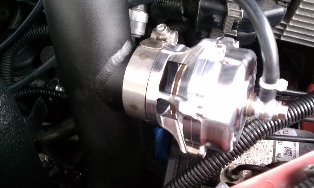

Just installed the tial q I bought from zzp. Is it really supposed to hang open this much at idle? I heard people say it hangs open a little, but this doesn't seem right. It's wet outside so i couldn't really get on it, but seems to be holding boost fine. I'm just worried about something getting sucked in the motor when I'm idling.

If your maf is after the BOV you will be fine. What are the chances something is going to end up in that space? You should be good.
I should see if mine is open at idle. Mine would be more of a worry when its wet out because its near the ground. Oh well, nothing happened yet.

Im just looking for piece of mind. Emailed zzp the picture. Good news no more flutter though

Yea, doesn't seem right, your letting in a ton of potentially dirty air.

will be fine that's how mine is and i have no issues no flutter and it holds boost fine.
........it's not like it's sucking air/dirt/rocks in....
if you really really were that worried about it i suppose you could make a "shield" around where the diaphragm opens similar to a turbo screen material.

Yea apparently its ok. I'm just glad there is absolutely no flutter and the response of the tial is great. I might fab up some mesh around it for peace if mind. Do you think cutting up an injen hydrosheild would be a good idea. Never seen one in person don't know if it'll flow enough air when the bov releases air

would prob be fine. idk i wouldn't even worry about it, if it's something like a rock, at worst it's going to sit in your intercooler endtank if it gets in there, which is such a long shot freak kind of thing to happen given the placement of it, even if it was hanging above the ground it's only going to be open at idle so unless the road is throwing stones up sitting still then i wouldn't worry, i don't
