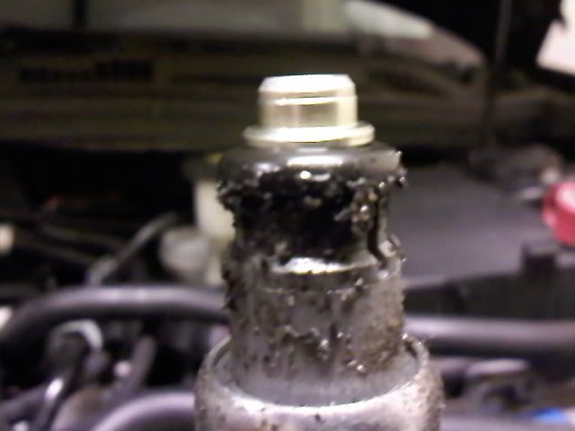

Pulled the rail and I found:
That 0-ring is in perfect condition, but that's a lot of buildup around it.......
Anyways, is it possible Coil packs could be an issue here? There is no smoke coming out of the tailpipe (from what I can tell).

these engines arent hard to rebuild and the **** around the injector is typical
