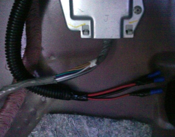

I was just told by someone that it was possible to access the fuel pump without removing the tank by removing the rear seat bottom and going through an access door. I know this door is there because I saw it when I made my fuel pump rewire.
Plate labeled 'J' in my pic below. I'm not sure if it's big enough to take out the pump and remove the ball and spring from the regulator however. If so, that would make this job muchhhhh easier. Anyone know for certain if you can do a fuel pump this way..?

Old Aug 30, 2010 | 11:51 AM
  #77
WSFrazier's Avatar
Joined: 09-17-05
Posts: 5,844
From: Pittsburgh, PA
No that wont work. Tank definately needs dropped.

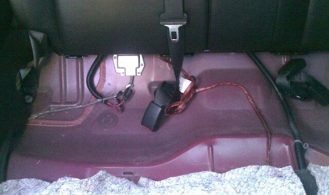

OK I just had my back seat out, and there is definitely no way to access the fuel pump or tank... The fuel pump wiring is under there, but nothing else. Unless there is a major year difference or it was a Redline difference or something, there is no way to get to the pump... So not sure why someone else stated it could be done. Typical css fail lol.

Old Aug 30, 2010 | 06:34 PM
  #84
WSFrazier's Avatar
Joined: 09-17-05
Posts: 5,844
There is a special tool, but I just used a hammer and extension or something and bang at each clip until it slid apart.
