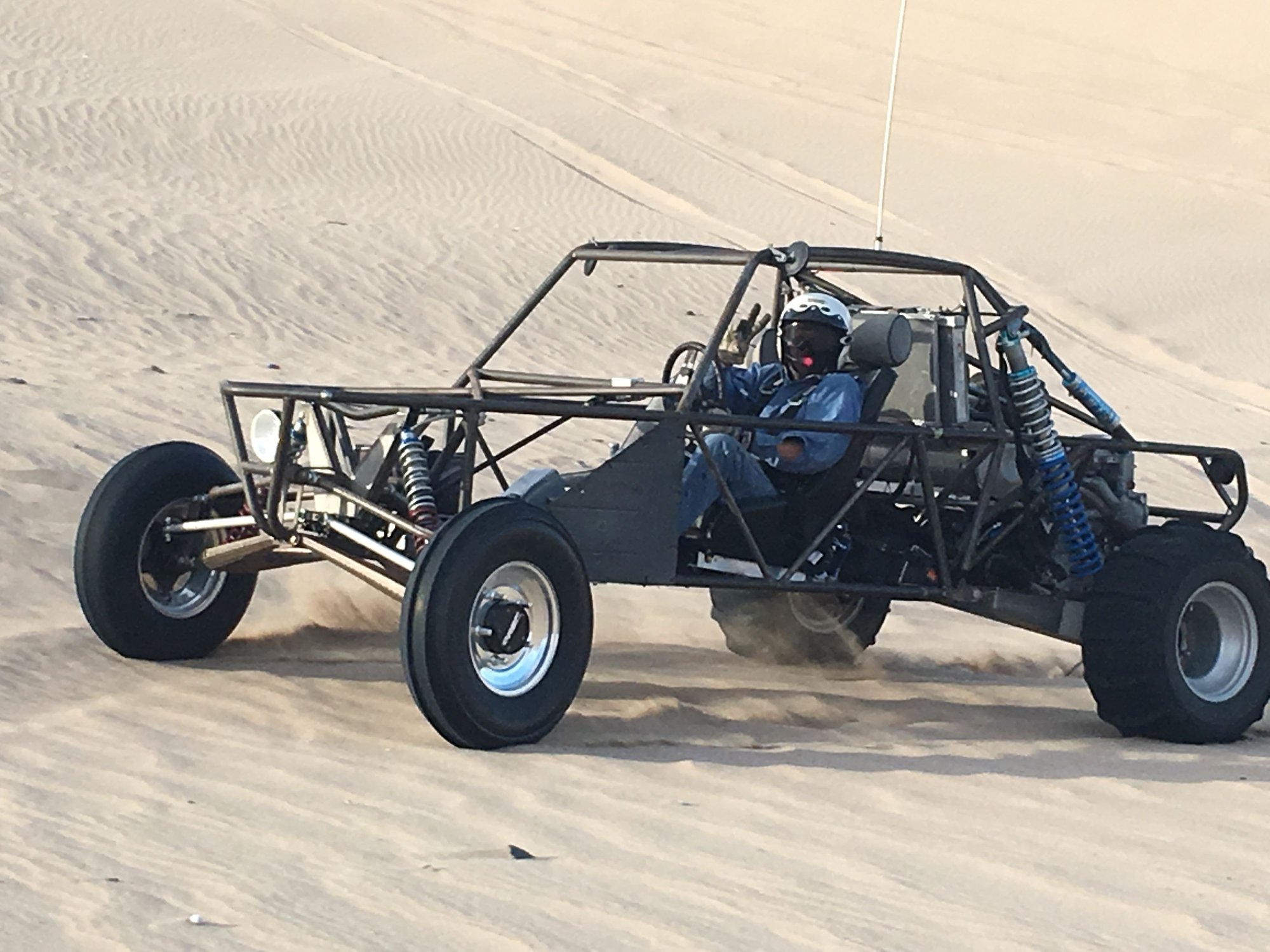

I had to cut and weld a smashed header in the desert. I think It runs OK. Is it hurting anything?

The guy filming this hit me right on the pipe. The car doing the wheelie ia a Funco GTQ with a CBM LS7 stroked to 440 ci Whipple charged, race gas 1100 hp. We went from Glamis to Gordens well California is why its so smooth here. Sorry its FB.

You can grenade an anvil if you can’t set up a car and drive it. The 091 6 rib transaxle is my favorite. Its super light. The motor is perfect but the whole car is set up for the tranny. Lightened 930 CV’s, gear ratio that allows for 3rd and 4th gears. 1st and second are weak. I tune the coilovers so I can hit stuff fast enough to hold third, paddle tires are cut to spin at will, car is 1760 pounds wet with tools. Pro Am shifter and the right clutch. Brand new Boozer cromo chassis, Very trick 1.2:1 steering rack and toe out alignment front and rear. It turns on a dime and I don’t use a turning break. They are for pussies that can’t huck a car. If I ran a bigger tranny I’d need more power. I run with big heavy $80-210k LS V8 cars that break constantly. The hottest and fastest growing class of desert racers are the class 10 cars. Factory sealed ecotec 2.4 class. They weigh 2200-2500 pounds. They run the big tranny Class 10 Race Car | Alumi Craft Race Cars
