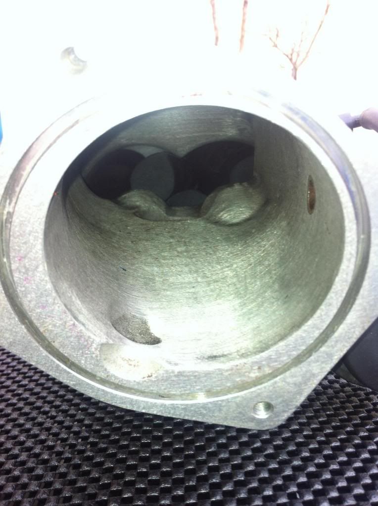

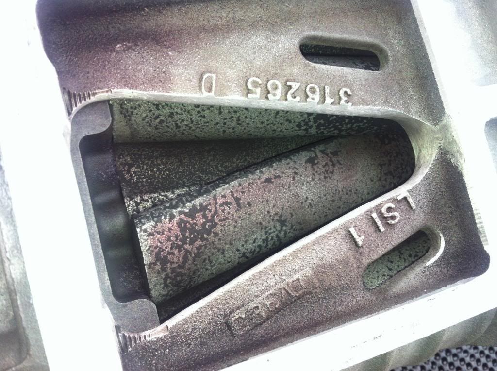

Im running the Steig M62 with an LS1 tb. I 'want' to say the revs were faster compared to my stock M62 but that was most likely a butt'dyno type of thing as most mods are. It also had a slightly different whine to it, still very high pitch and bad ass lol. You might benefit slightly from a venom cooler type setup (for the snout) keeping the blower cooler but from what I read a while back the lightweight rotors weren't worth the upgrade as said previously here.

and yes, I know the Teflon coating is missing, the previous owner had a meth addiction lol

and this is why I mated the ported blower with a larger tb...obvious difference in flow capabilities lol <LS1> <L61> <Vortec>

fyi.... not teflon coating on the rotors.... abradable coating
Other than faster revs, did you notice any difference in power?

of course its going to rev faster with a bigger throttle plate your pulling more air in

Is your throttle cable hook up and return spring on the top or bottom? I use the same throttle body and its size matches the blower inlet perfectly when it lines up. Mine did not until I port matched the adapter plate and blower inlet a whole lot. Looking inside past the throttle plate is when I found the mis match.

How much did you wind up paying for the port job, looks like for the most part it was done properly although ive seen better work elsewhere. The venom snout cooler is a joke IMO, and thats basically the same thing i keep hearing from the M112 users as well. There isnt really all that much that needs to be done that eaton hasnt already done for you from the production line. Porting in the inlet side definitely helps but the outlet side is such a delicate process sometimes the risk outweighs the benefit.
