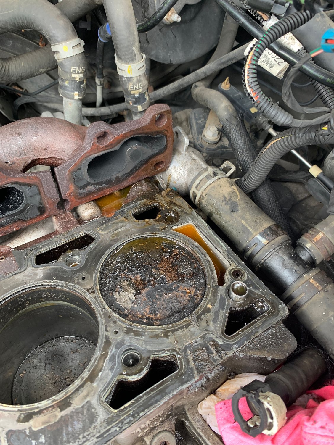

I then noticed that my normally full coolant reservoir had at some point emptied itself, which instantly signaled that I had blown a head gasket. To find out I took out the cylinder head, removing the Torque to Yield head bolts, camshaft timing sprockets, Throttle body, intake manifold, exhaust manifold, fuel rail, etc. Finally getting everything I needed to get off of the head I pulled it off and almost immediately identified my blowout.

  • If you had a bad head gasket you probably need your head checked out and cleaned at the very least. Likely need valve seals replaced. Also valves lapped.
  • The mating surface of the block could be bad enough it needs decked. If ignored you could have poor head gasket seal.
