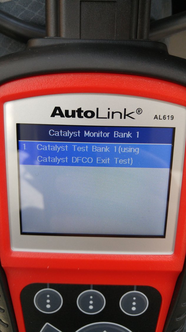

good new is the down pipe's in. bad news i got impatient with the o2 sensor since it was rusted in and shattered it and had to buy a new one. i picked up an NTK from advance. car runs fine but yet i'm getting a cat efficiency below threshold code. do the o2 sensors take a little bit to set in causing the code or is something wrong with the cat? i bought it used and my car needs inspected so i can always have the garage swap the old cat with the new if that's the case but i'm not trying to shell out money that i don't necessarily need to.

56k
the test i ran and the 2 results. cleared the cel after it eventually came on and then it passed again. ran it a few times. safe to assume it's just from it being a high flow cat from this info and a defouler should fix it? all o2 tests passed every time as well.
Edit: it only fails the dfco when the CEL is on. Once I clear the code it's fine and passes. O2 tests pass everytime no matter what. Any ideas?
