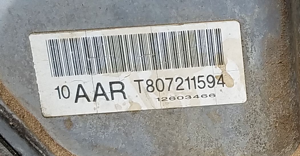

Can you tell a 2.2 VVT from a 2.4 VVT from the outside?
I looked at a block today with 69K on it advertised as an 08 2.4. It sure doesn't look like a 2.4. Is there any way to tell from the outside?

The code on the oil filter housing should tell you

I looked on my old lnf filter housing and I guess it's just a serial number so nvm. They stamp a20nht on the ldk there.
Old Apr 2, 2018 | 11:51 AM
Numbers on the timing cover tell you nothing. They all share the same cover. Oil filter housing should tell you.
