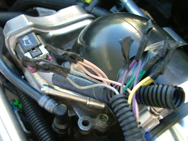

8 to 8 pins ll have no modification 2005 -2006
2007 use 6 pins

Best way would be to locate connector end view pinouts from GM, and match functions of wires, not just color. Iirc the difference is an extra 5v refference signal and return on the eight pin. Solder and heat shrink. Done... Pinout is a pita to find though without all data or something similar.
