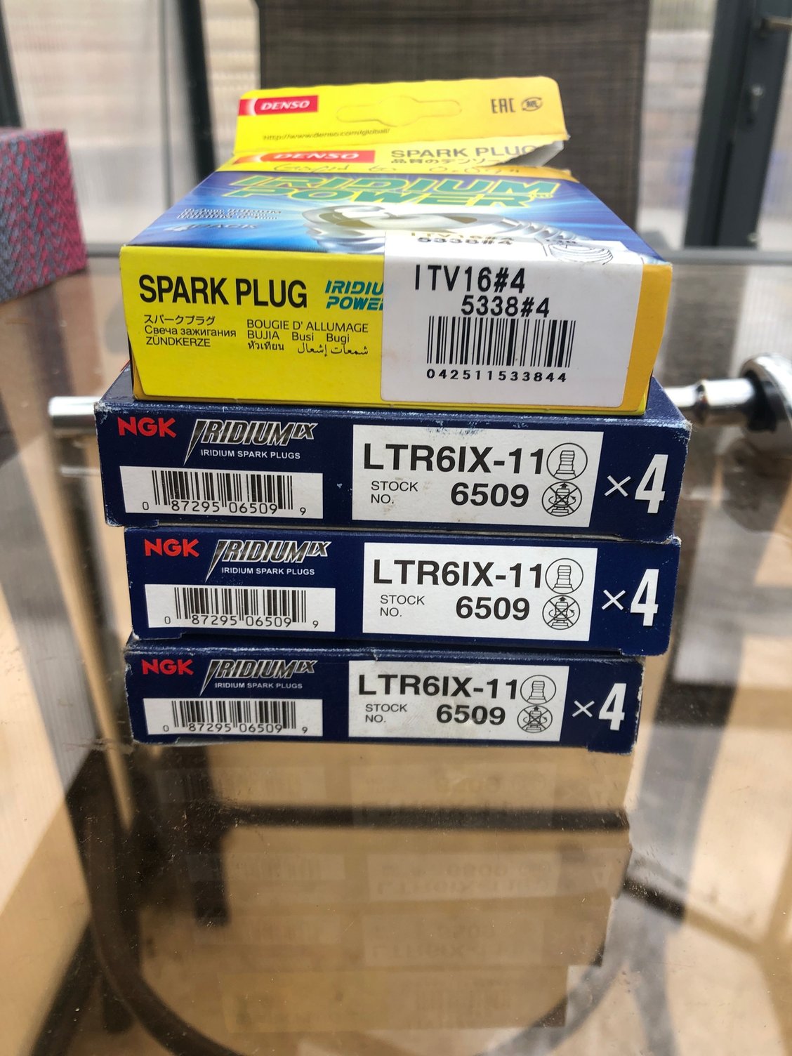

I couldn't help myself brining in a set of denso 5338 mohaha. Pretty sure these are what zzp is offering as their "race plugs."
Edit: Denso 5339 is one step colder 6HR, same 0.044" gap 0.4MM fine wire. Denso 5340 looks like the "race plug,"
0.031" gap, 7 HR. All same size, thread pitch, height, etc.

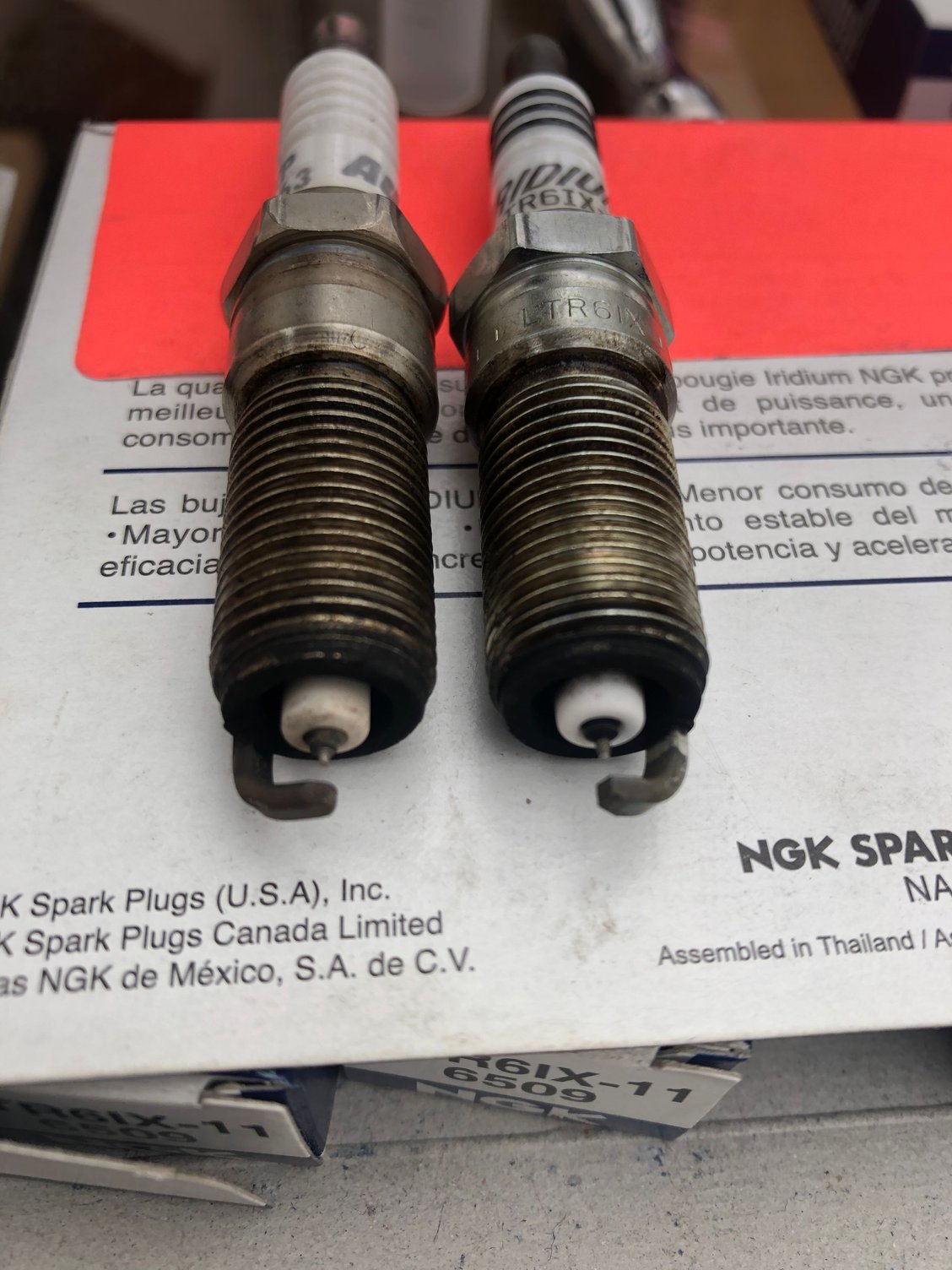

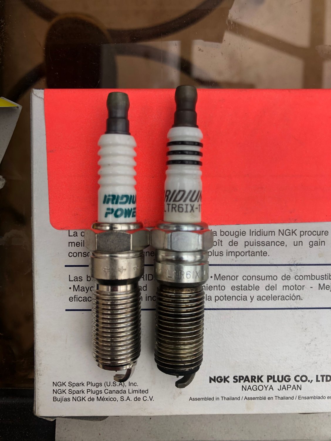

2 month old black autolites vs 2 month old NGK6509 both used with methanol. (I use a little oil to grease the threads, so don’t mind that..)
New 5338’s are a little smaller than the NGKs, which were already a little smaller than the autolites.. don’t see it being an issue but I guess I’ll find out soon.
got more plugs than a nitrous car right now haha, all in the name of a few extra ponies!
